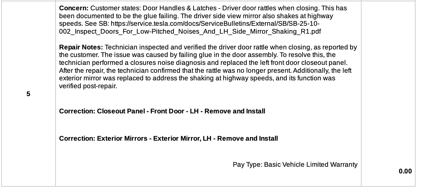

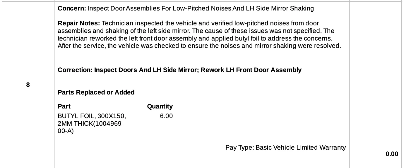

Been meaning to provide an update on my service: had it done 2 weeks ago. They confirmed the rattle sound (in my service appt, I linked to the service bulletin even though mine is a 2024 model year) and they fixed it with butyl tape and "reworked the front left door assembly."
For some reason they had the repair listed as two line items on my invoice:
Tesla Cybertruck Video: how to fix Door Rattle / Wobble at high speed and when closing Screenshot 2025-11-04 at 4.22.51 PM
Tesla Cybertruck Video: how to fix Door Rattle / Wobble at high speed and when closing Screenshot 2025-11-04 at 4.22.38 PM
Are you happy with the repair?
