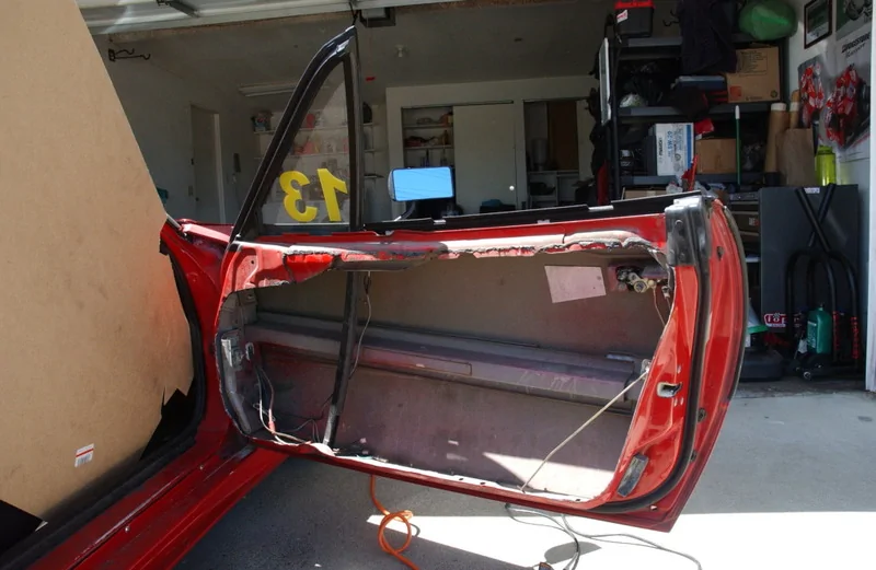

I also recently had a car normal door apart and there was a huge bracket through the middle that was like glued to act as a reinforcement, not sure why they just got rid of any support
That's not for NVH, that's a side-impact brace. The outer skin on that door is paper-thin and useless in a collision.
The CT doors lack bracing and padding because "the best part is no part". They would probably be fine if that adhesive held up.
So many problems with the CT related to adhesives! I wonder if their supplier was giving them watered-down glue 🤔

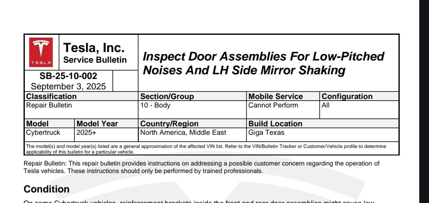

Structural adhesive 2.0 to rescue. I wonder what date Tesla implemented the adhesive change on the assembly line.

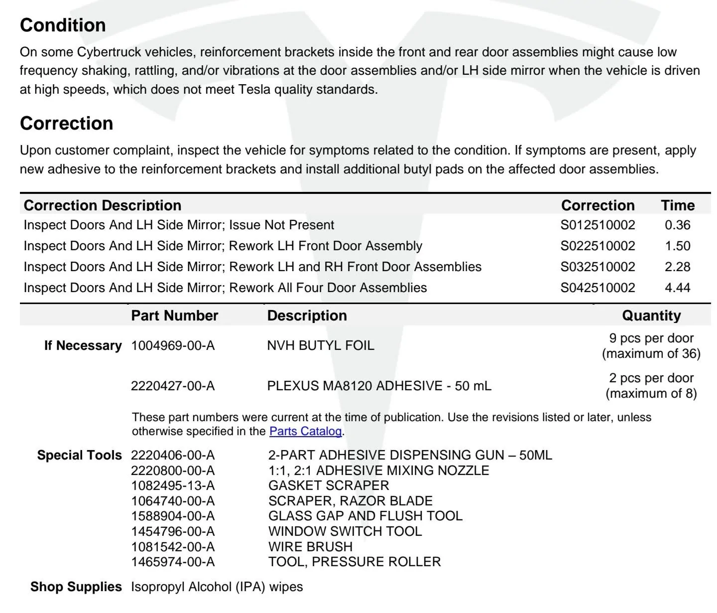

Per service bulletin: Tesla techs should not exceed 36 butyl foil pads per door😁
I think Tesla installs 2 NVH pads per door at the factory.
