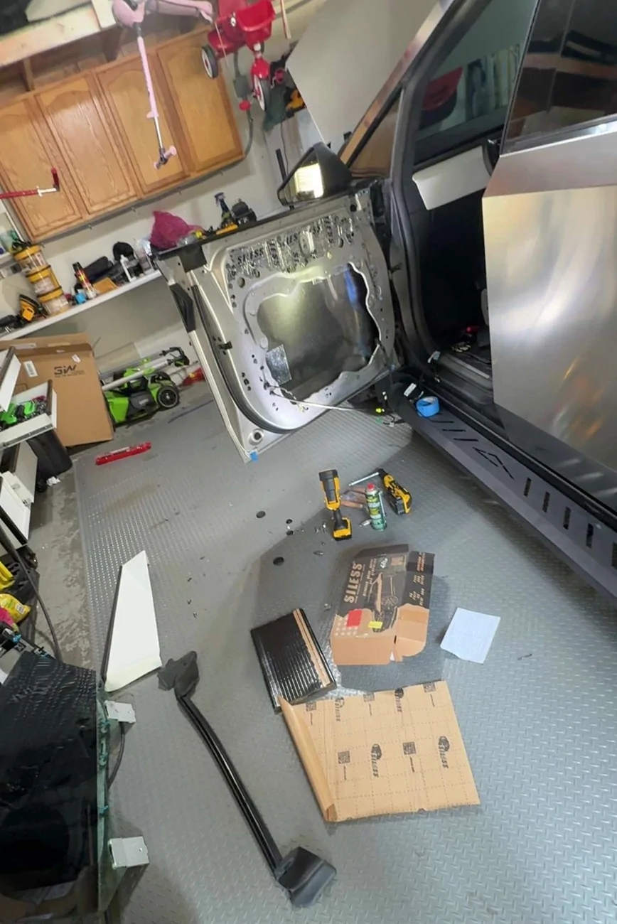

So, does this fix the vibration at high speeds or just the rattle when closing/bumping the doors?
edsonbarron
Edson
Jan 15, 2025
160
166
Kansas
cybertruck
I did a short test drive, only got up to 65 and did not notice any vibration. On top of that the cabin seems quieter but that may be placebo. I’ll do 100 tomorrow and give feedback
