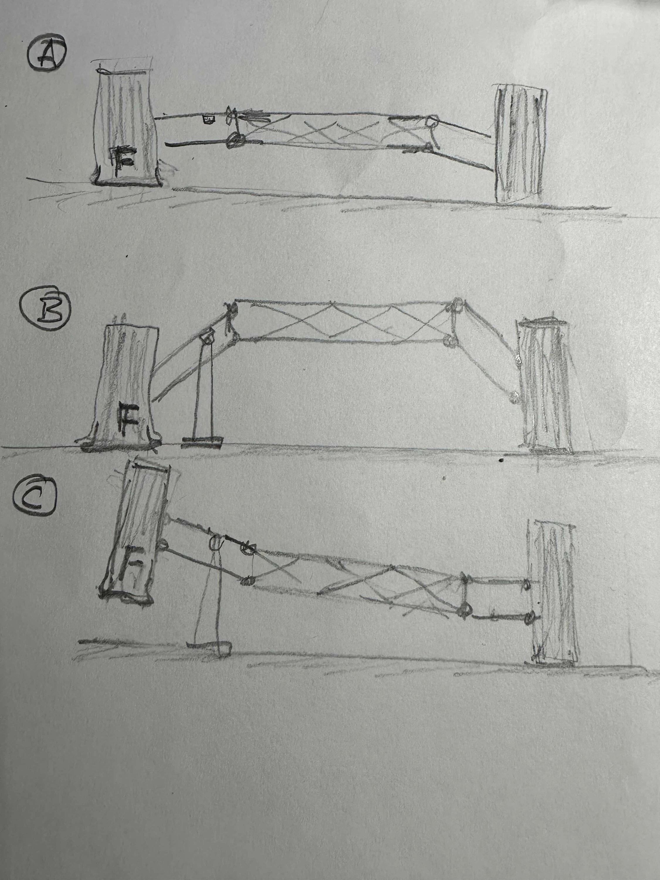

Or, in case Idjessee's idea can't work for some reason.
Maybe some Tesla engineer thought of this and made it work....
A: You have a flat.
B: Adjust the suspension to max ride height, place the provided jack-stand prop under the car with its base positioned so the prop is vertical. Set the top of the prop in the jack-stand point located in the upper control arm just outboard of the control are to body bushing. Then,
C: Adjust the suspension to minimum height, lowering the body and therefore putting a downward force on the body end of the control arm, causing the control arm to pivot about the jack-stand point, thereby raising the wheel with the flat off the ground.
Here's a really awful sketch of the idea...

I have seen those inflatable bag ā€˜jacks’ go badly, so would probably use air or electricity to power a manual jack… can be used without power or air, but also has traditional mechanical locks so hopefully it does not hurt someone.

The truck knows the slope. How else could it self-level for camping/loading?
Ok, Let’s run with that…
is the flat on the lower part? The CT may know the slope, but that doesn’t mean it can lift a lower tire and still balance. What about an uphill tire? No room left to lift it?

Lower all suspension, close the valve so the flat wheels strut cannot get air, inflate others. Not very hard.
in your scenario the deflated arm just hangs limp, so will stay on the ground
but that inactive arm does jack up more easily
Land Rover owners been doing this for decades

Uh, how will the air shock extend, if it cannot draw air into it? Maybe I am wrong in thinking how they work, but I assumed a vacuum would hold up the tire, wheel, suspension components, etc...
If it was not strong enough to keep them up, how would it resist or slow down the rate of travel / air pressure when it hit a bump, etc?
Either I have it very wrong how these work, or you do... Hopefully someone with a Model X or S can tell us how those work... (yes, probably not exactly the same, but probably closer than other setups).
