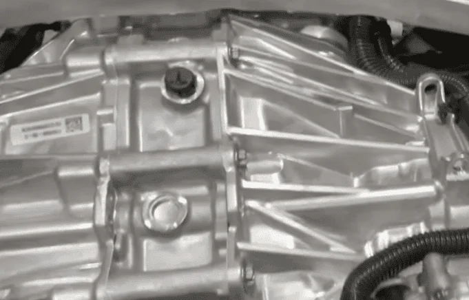

Here is the case vent for the Model S Plaid. My concern is if they are using the same vent location and it's not self sealing then when a warm gear case goes under cooler water it will pull water into the gear case.
Unfortunately you might need to lower the entire subframe assembly to get to it, Model S procedure:
https://service.tesla.com/docs/Mode...UID-B4DA6D1A-DFBC-4FEF-9C36-A2CF60B7AC68.html
Had NOT thought about that, in some of those clips it looked like they were driving pretty quickly so would assume they got warm, suppose no way to tell if there is water in those unless something goes wrong or you pull them apart?
Pull a drain plug, water is heavier than oil so it would come out first after sitting for a while. If it's mixed in then the oil would be cloudy or grey colored.
