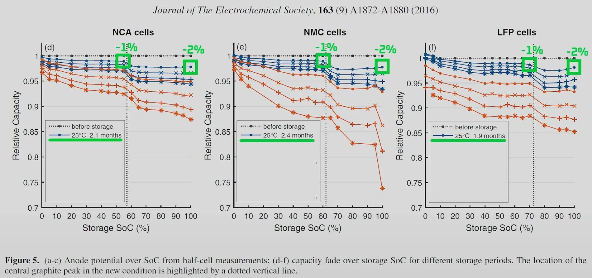

When I got my 2018 Model 3, I read all of these battery posts. I read about cathode cracking at 3.92V and anode plating, etc. If you look at this graph, that 3.92V change is approximately, 63% SOC. Notice the vertical dashed line at ~63%, and the drop by 65%.
Tesla Cybertruck What’s REALLY Ruining Your EV Battery // Stop Stressing - The Limiting Factor 1744397139200-yo
So, as an experiment since I didn't have more than a 25mi rt commute, was to only charge up to 60% SOC for daily usage. Now for roadtrips, I'd charge up to whatever was necessary. It's okay to charge up high, as long as you don't leave it there. So, what was the result?
Tesla Cybertruck What’s REALLY Ruining Your EV Battery // Stop Stressing - The Limiting Factor Image 8-1-24 at 2.39 PM
I'm at 6yrs 4mos now. And, I'm currently showing about 4% deg, thru SMT data. But, up until the last few months, my battery was still using the upper buffer, and showing 100% EPA-estimated range, and I was far above the normal battery deg.
