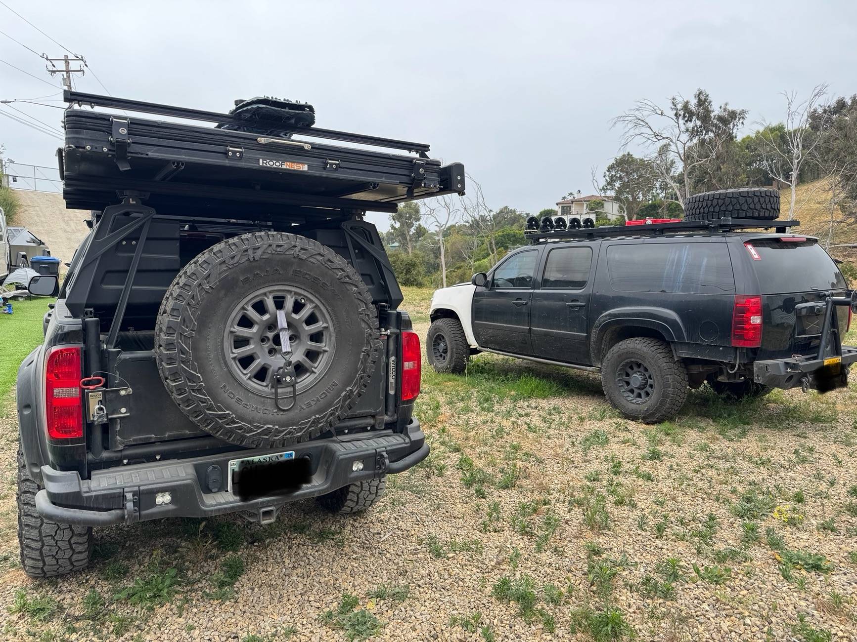

This is true too. That’s why I posted my kit for my CyberBeast and what I carry on my other Trucks. Everyone has their own use case. Prepare as needed.
Your pics of your tire system for your CT don’t show a jack or an impact wrench/breaker bar. The other normal trucks as shown have only 85-ft-lb torques specs, jacks and wrenches. You or I can get those wheels on and off. How do you deal with changing the CT tire? Or are you limited to the patch kits and compressor as shown? If that’s the case (no spare), you’ve covered some flat tire cases. Repair kits wont help with most flats from rocks, glass, curb strikes, potholes, debris, valve stem breakage, rim damage, belt failure, or any type of blowout. They are good for screws and nails, and that’s pretty much it. Those are the most common tire failure reason in urban areas which is why I carry an inflator/slime kit in every vehicle, so clearly a legit strategy, but we still must plan for wheel/tire replacement, hence my comments above - and roadside assistance having supplanted most self-help strategies. A Cybertruck isn’t a Tacoma when it comes to replacing a spare tire.

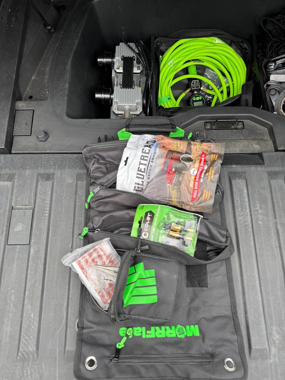

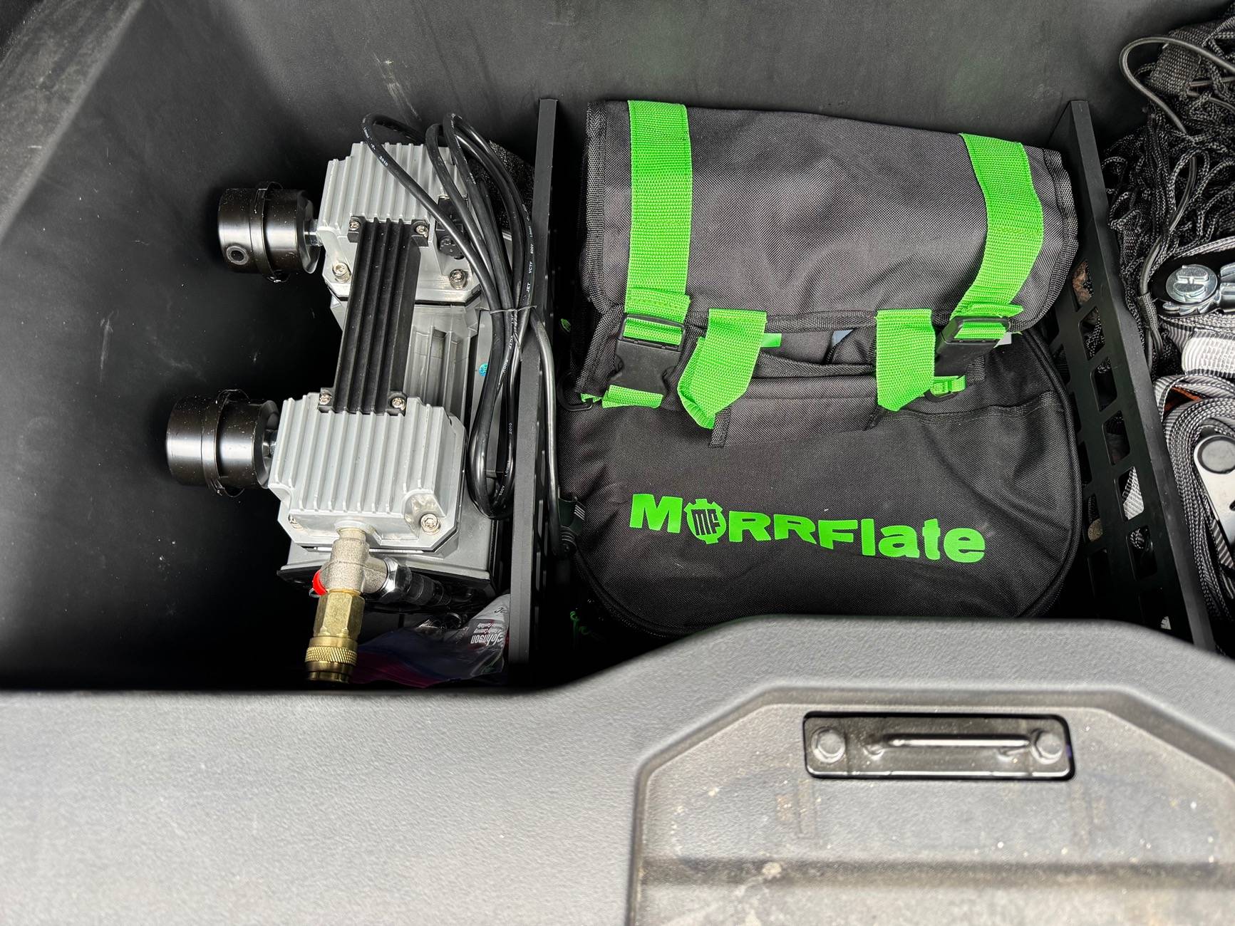

For anyone interested in what is in my “get you home” Tire Repair Kit. Watch the video.
The only flats I have ever had on my vehicles could and can be fixed with this kit.
I’ve plugged several holes from screws, nails and even bolts. Replaced a leaking valve stem. Have had a cut sidewall but didn’t have this kit with me but confident it would have worked to get me home or to a shop.
Watch the video if you’ve never plugged, patched or changed a valve stem in the field before (without having to jack or remove your wheel!).
and for all you nay sayers this is a good one about stacking rope plugs to fill nasty gashes to get you home.
Tesla Cybertruck What do you do if you have a flat tire IMG_4475
Tesla Cybertruck What do you do if you have a flat tire IMG_4476

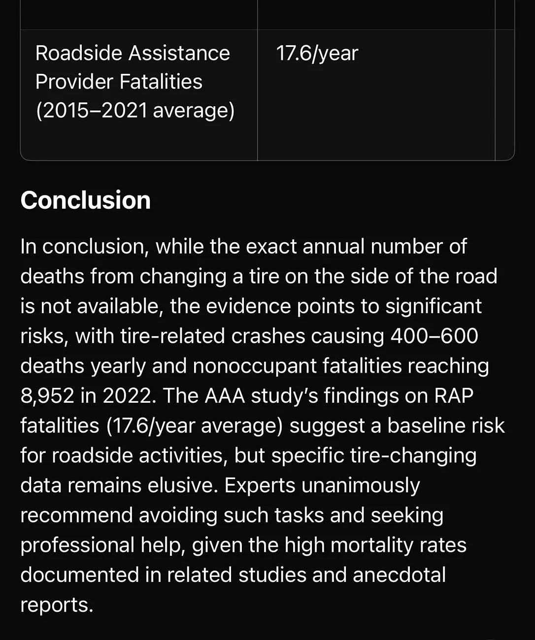

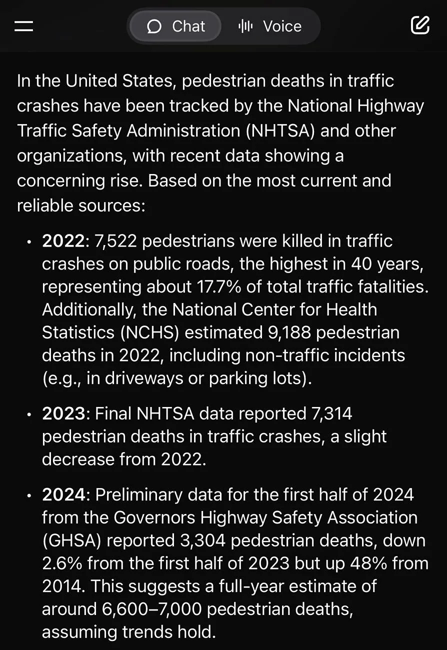

Dangerous yes, so is crossing the street.
Just for context so everyone can make informed risk assessments. There were an average of 17.6 deaths per year from Roadside Assistance from 2015-2021.
Contrast that to 6600-7000 Pedestrian deaths last year.
Do we not take the risk to cross a street too?
Just ask Grok:
Tesla Cybertruck What do you do if you have a flat tire IMG_4499
Tesla Cybertruck What do you do if you have a flat tire IMG_4500

Still won’t do the side of the highway change if I can avoid it. Yes, there are risks in everything. But some I can reduce by choosing to not do.
