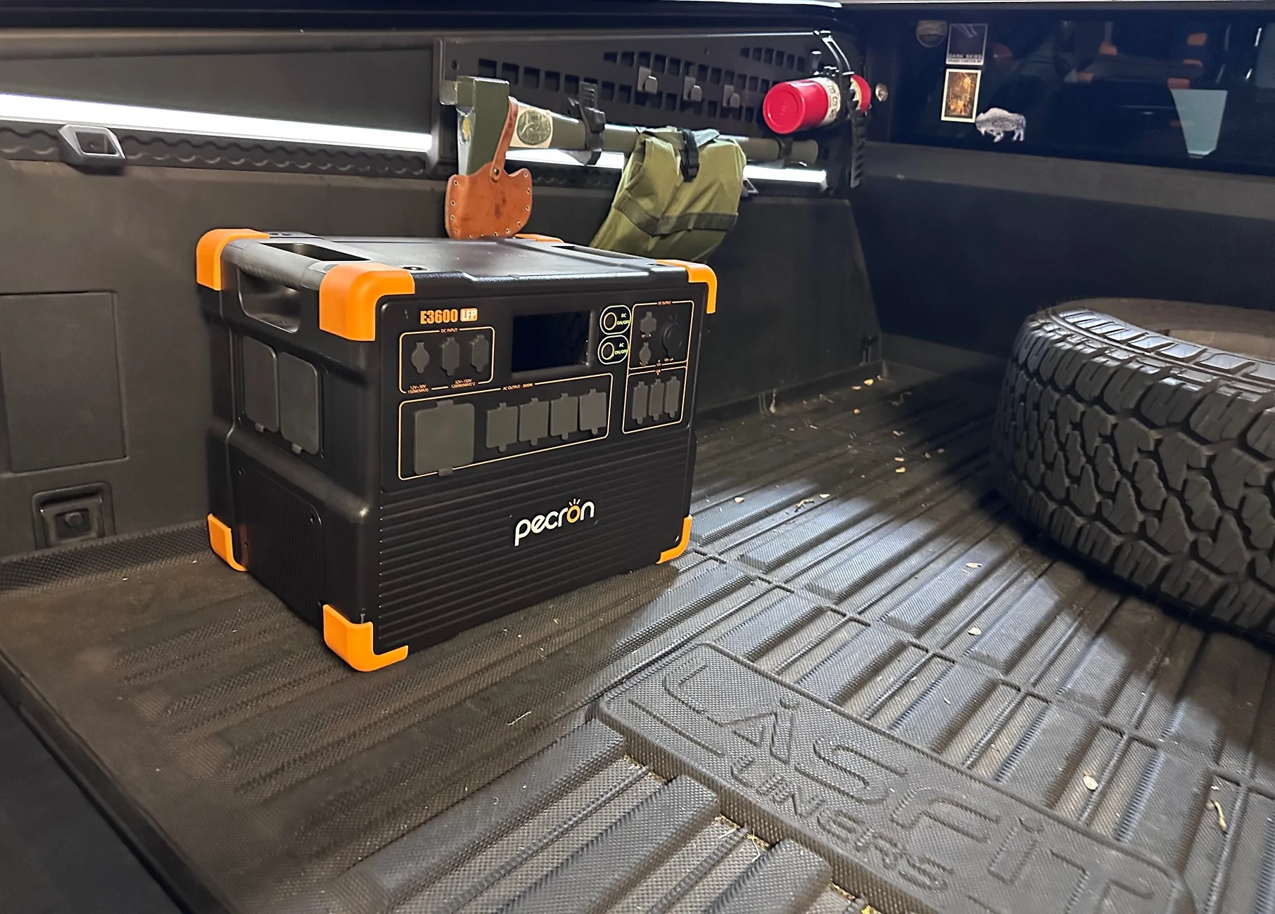

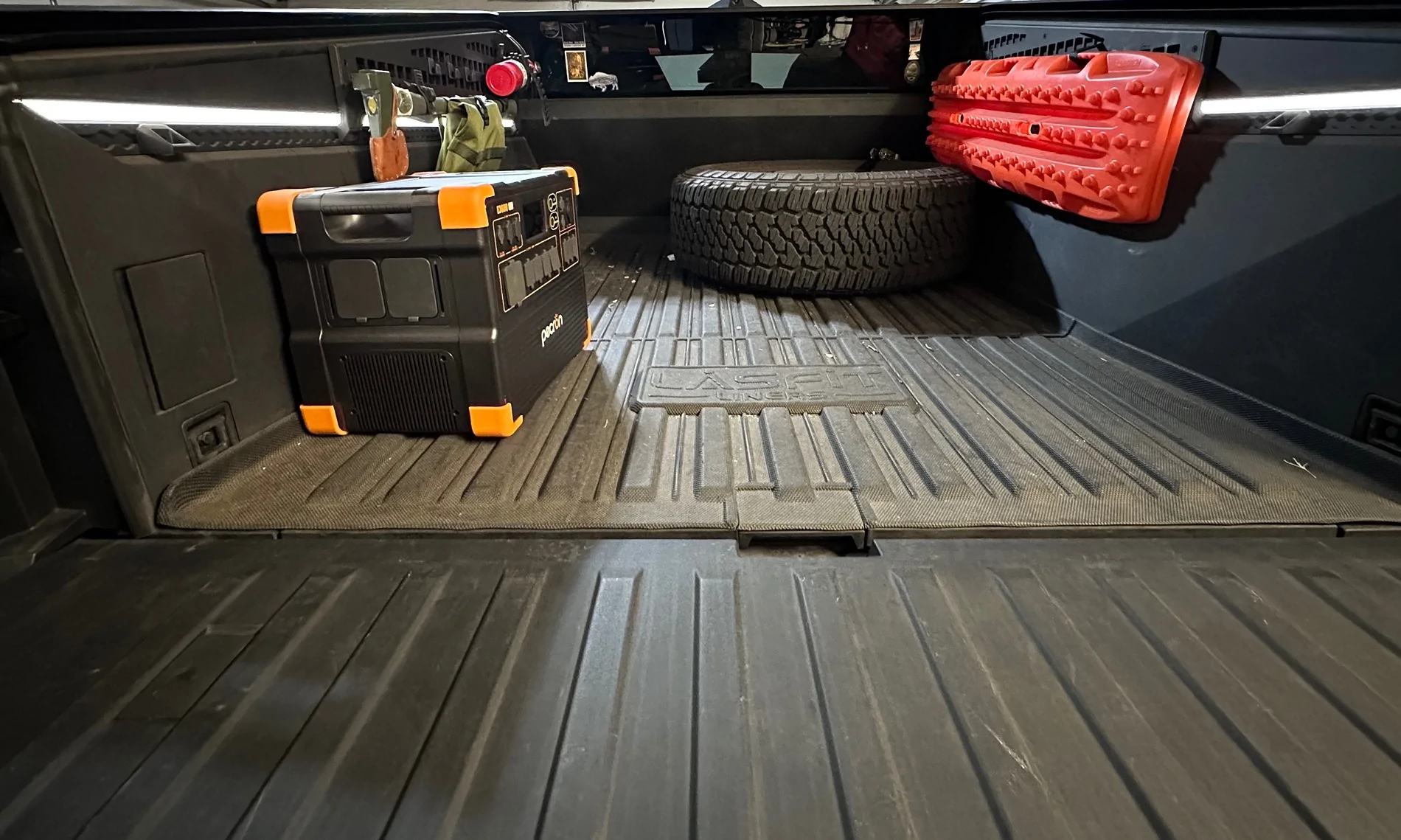

I’ve considered that option strongly too. Do you have any pictures of it in your bed? (Of the truck😀).
I have two Ecoflow delta pro 3’s and 50 amp hub but the issue is they are a hair too tall to fit standing upright under my cybertent. Would love to see how this fits back there.
It’s fits below the track in the bed. My ultimate goal is to have the cyber tent plus 15kw of battery and 1200w of solar panels all tucked in the vault under the cyber tent when open.
