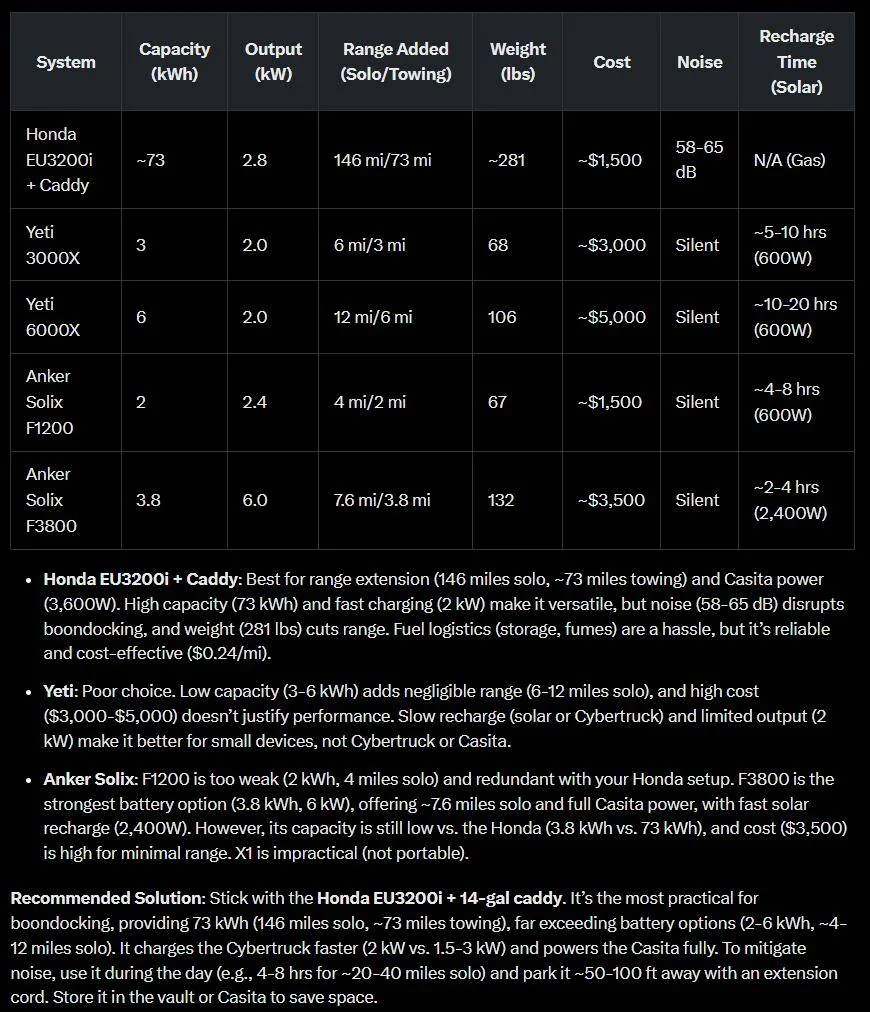

I have a Honda EU3200i, and a 14 gallon gas caddy, picking up a Casita RV July 8 in Rice TX. This option gives me about 73 miles of additional towing range (assuming the Casita cuts my 300 miles in half). Grok compared the options in attached table. Obviously have not tried it out yet but fyi if interested:
You're going to love the Casita. I have a freedom deluxe. You should get about 120-175, depending on the location of the next charger and how daring you are lol. I made 175 miles of two full charges with rightly 10% left. Right now, I'm camping on a beach on Long Island with no service and the CT is powering the entire camper.

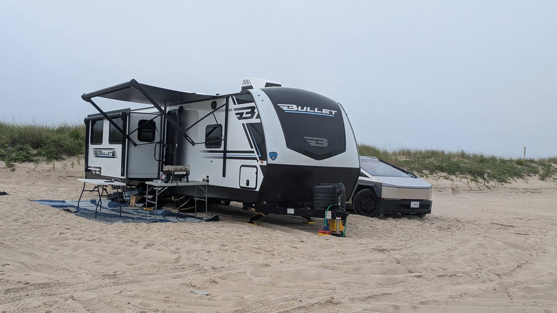

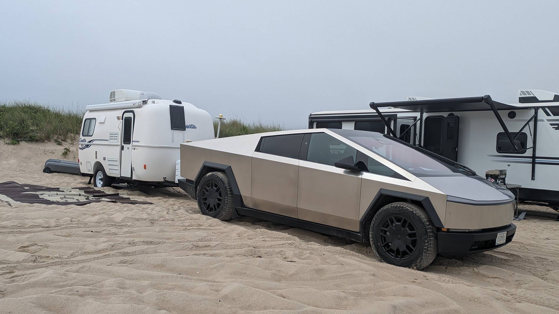

The re-gen will help but you won't recoup all of the energy it took to go up the hill. The sun barely came out now so I will take a picture of us on the beach. First picture is my CT and my camper the second picture is my brother-in-law and sister CT and their camper. I am powering my entire camper with the truck The fridge is running on gas but I'm running the TV and the fan on AC.
Tesla Cybertruck What is good generator for CT if in case road trip in Alaska or in desert where no supercharging available. PXL_20250610_204959462
Tesla Cybertruck What is good generator for CT if in case road trip in Alaska or in desert where no supercharging available. PXL_20250610_205017382

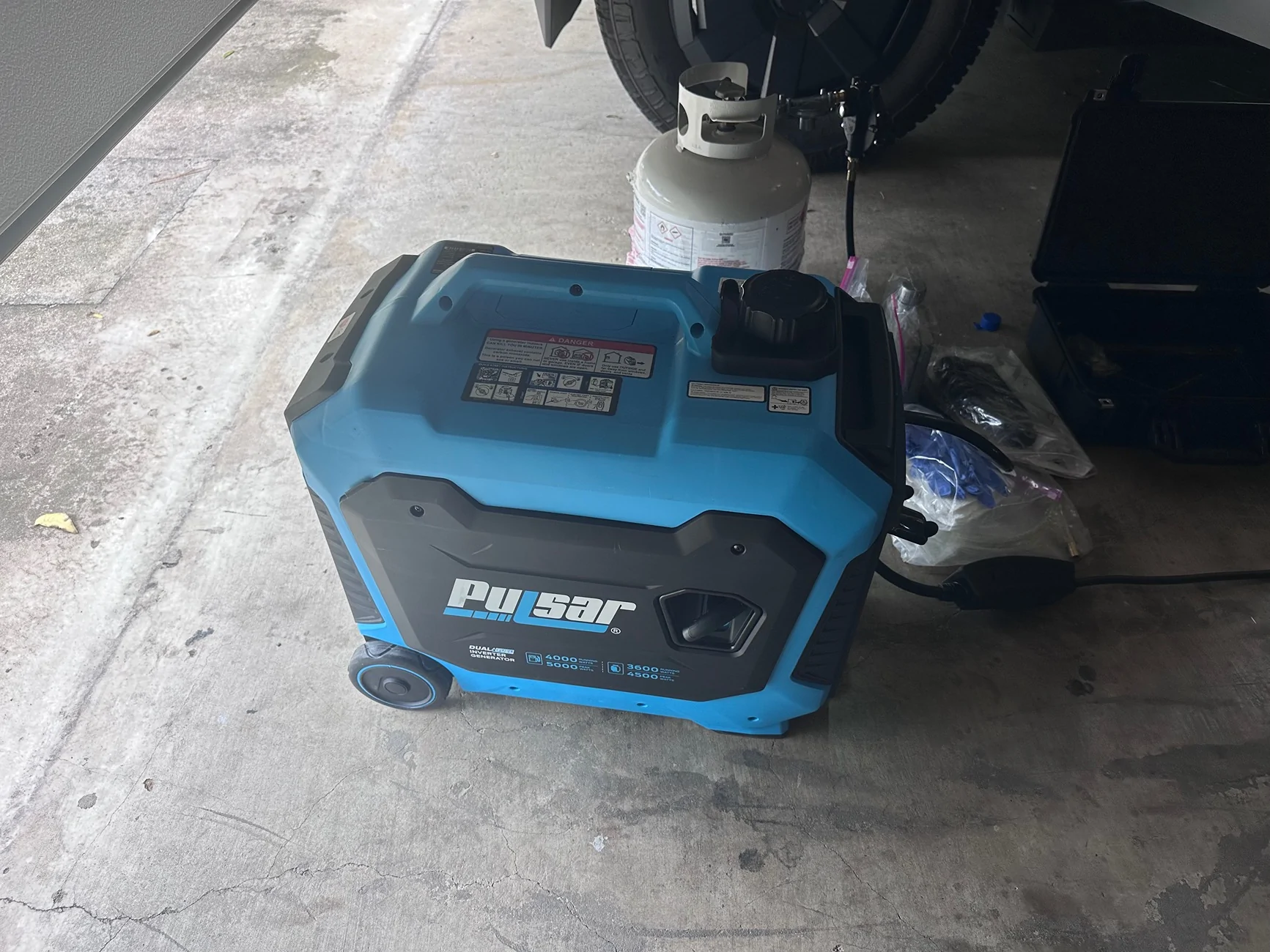

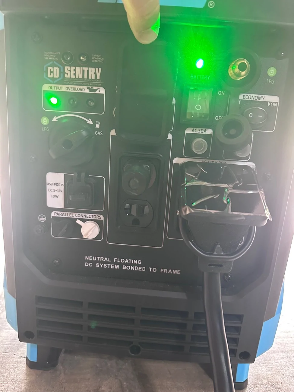

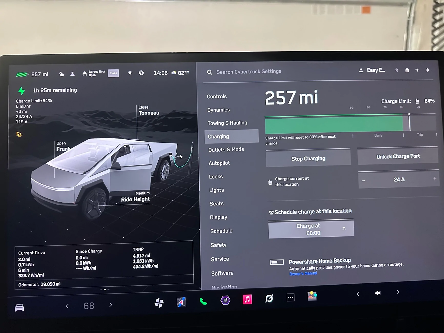

This is with the level two charger that comes with the truck? And also do you have any pictures of your setup and lastly …
Any chance you could post a link to your ground plug? Please and thank you.
Correct. I use the standard TESLA portable charger that you get from them. You’ll need a 30A head as the charger only comes with a 50A and a 15A.
The ground plug:
https://a.co/d/gh0XpQ1
Sorry. No pictures. If I have time I can try and set it up. It works quite well. 3 Kw/H isn’t fast but that’s not the point. Other than testing it’s a backup. No different than when I used to carry 6 gallons of diesel on my Diesel Jeep Wrangler. That was an extra 120 miles of range that I never once needed to use.
Sorry it took so long. Getting ready for another roadtrip and was checking all the gear. Remembered to take pictures.

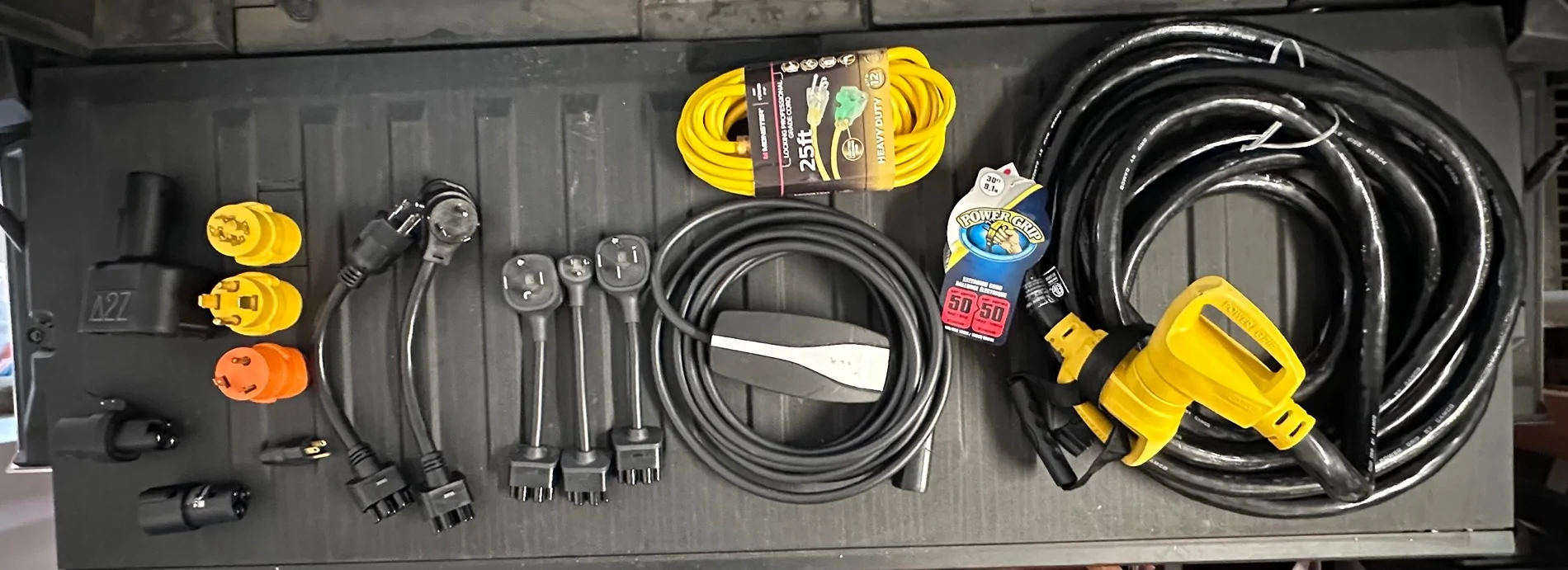

This is my charging cable/attachment setup. From Left to Right:
A2Z Cybertruck CCS to NACS adapter.
EVJECT breakaway adapter.
TESLA J1772 to NACS adapter.
Various 14-50 to different 30A adapters.
Grounding plug for generator.
30A to Tesla wall charger plugs.
Tesla 30A,15A, 50A wall charger plugs.
Tesla Wall Charger and 25FT Heavy Duty 15A rated extension cord.
30FT 50A Extension cord

Tesla Cybertruck What is good generator for CT if in case road trip in Alaska or in desert where no supercharging available. IMG_0676

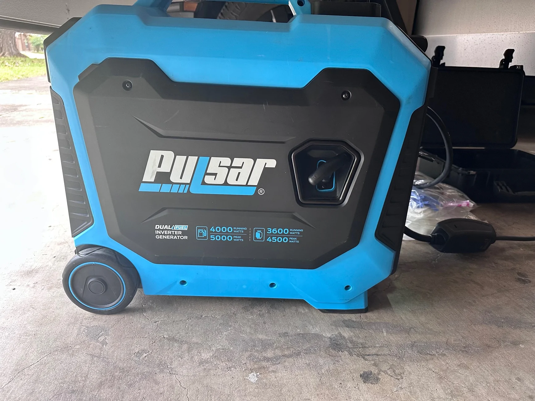

All depends on your use case. That Predator is almost 275lbs. I’m not getting that in the bed of the cybertruck. So it’s not an emergency solution for me. Neither is it a solution for getting some energy while camping in a place that has no power. It’s is very good at charging quickly at home or at an off grid cabin where you take it and leave it there. I don’t know that you can even close the cover on the bed with that predator in the back.
I use my Pulsar as both insurance on my many roadtrips and as a way to get some juice at campsites that aren’t electrified if I need it. You’ll notice I’m at 19k miles in one year of ownership. 13k of those are roadtrips.
I’m waiting on somebody a lot smarter than me to just tell me which one to buy.

That WEN is nice. Says is bonded neutral for charging hybrids. So it should charge the Tesla without the extra plug.
