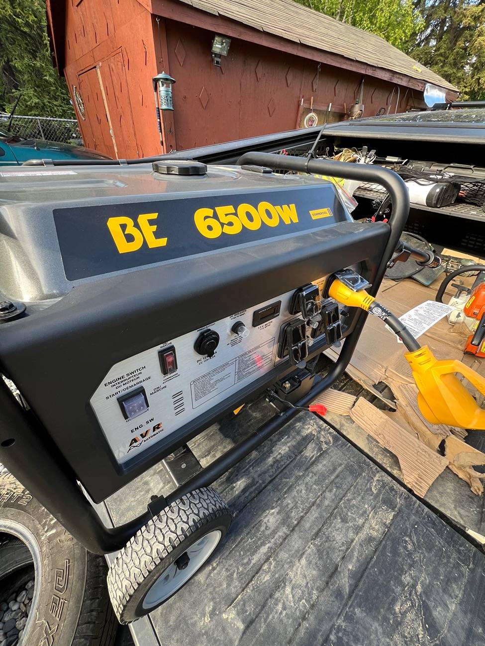

i picked up a 6500 generator, made by BE. Got it running today at 24amps 13mi/hour not bad for emergency uSE! I might be 50 mileS OUT OF THE CITY AT MOST!

Tested both 120 and 240 outlets, just remember to lower the amps on ct main screen so it doesn’t error or kill your generator by having 48a set by default start with like 8
this setup can get 13mi/hr for 7 hours with gas at $3.50gal equals 25 bucks for 91 miles.
About how many gallons of gas would that 7 hours be?

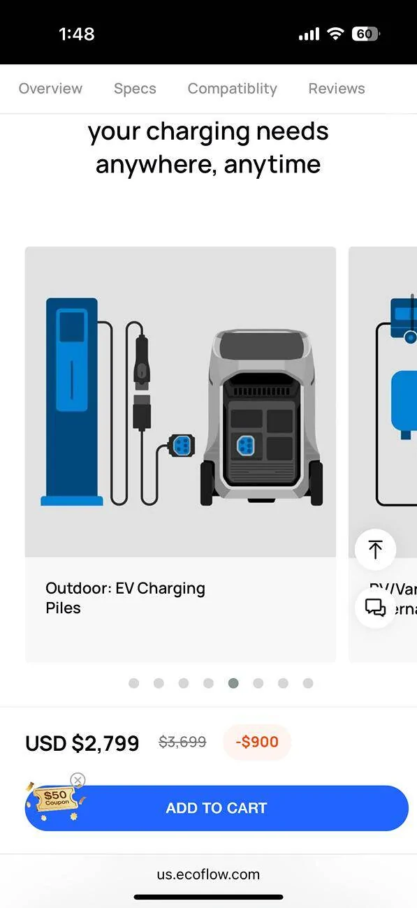

Does anker or delta or ecoflow etc make a battery back up that can be charged with a nacs plug? Or are there adapters that allow for that?

My Ecoflow delta 3 pro charges at almost 4kw with my Tesla wall connector and an adapter. I think the big anker can do that too and possibly the large Pecron but I don’t own either so not certain

You’re saying that you can charge a Tesla with a delta 3 pro, correct?
I’m wondering if the delta 3 pro can be charged with a wall charger or better yet a supercharger.
So like if the power is out in your area, (and you don’t have solar panels) can you drive to a supercharger and charge the battery backup either directly or via adapters

Ah found it! Delta3 can do it:
