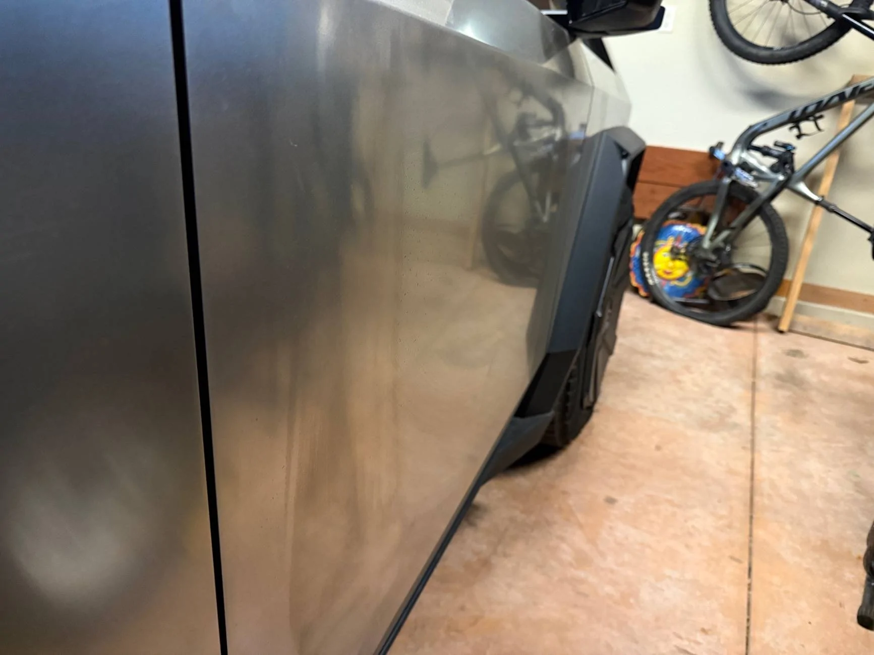

This spring I plan to apply a metal ceramic coating after super cleaning the truck. looking forward to it.
Same here. Good luck. I'll probably have to do some heavy bug removal. Neat that the windshield stays bug free for the most part, at least...
