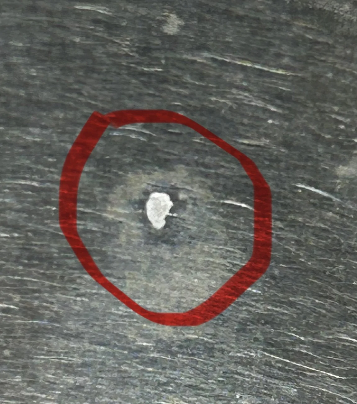

WASH FREQUENTLY!! We have salt and Mag Chloride in Co , went 8 weeks without washing due to frequent snow and below zero temperatures, corrosion pits all over , and pretty deep! 🤷‍♂️🤦‍♂️🤦‍♂️😢

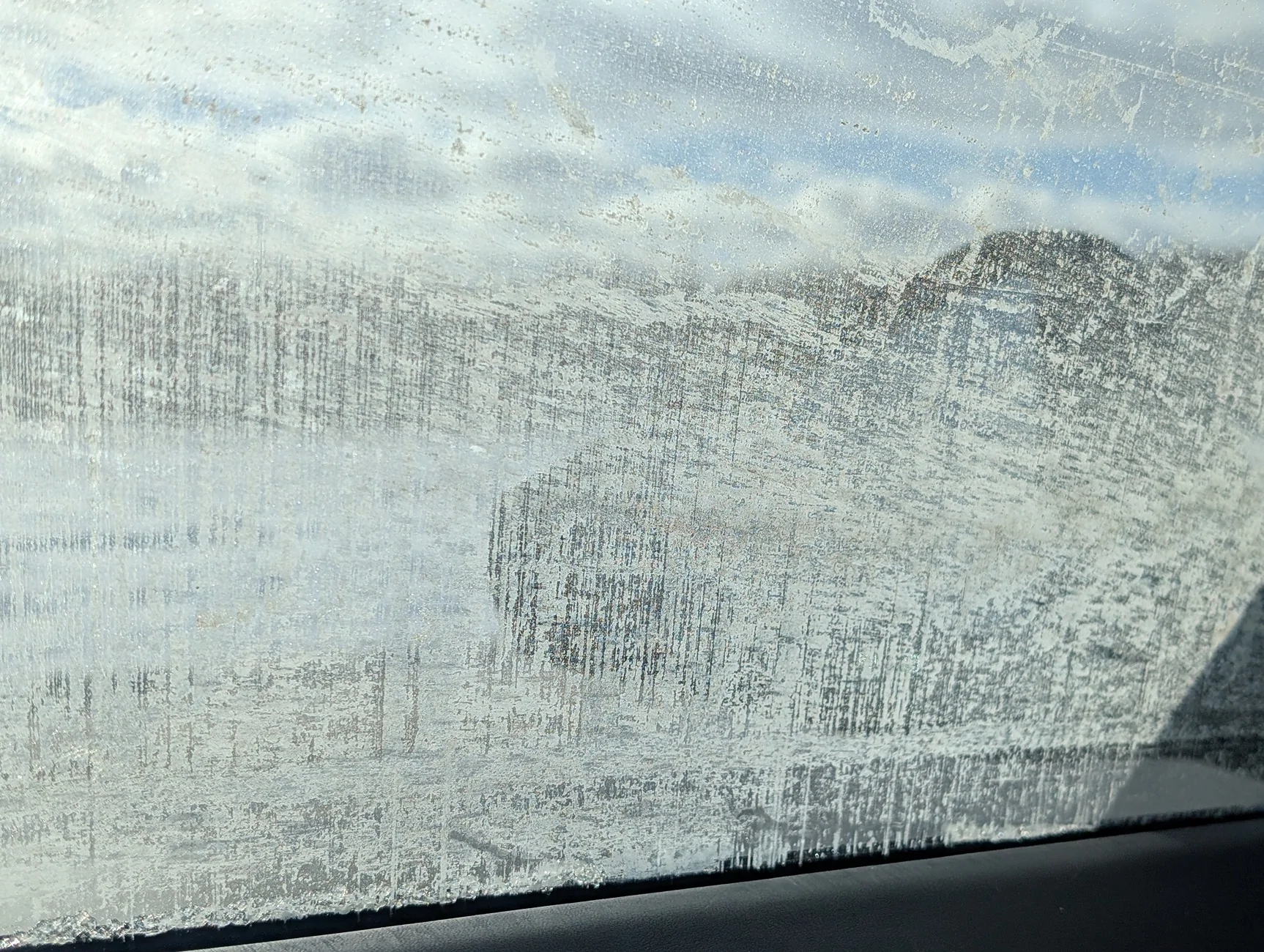

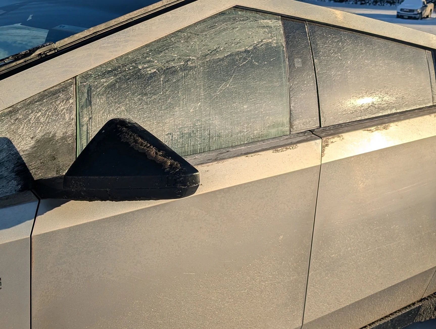

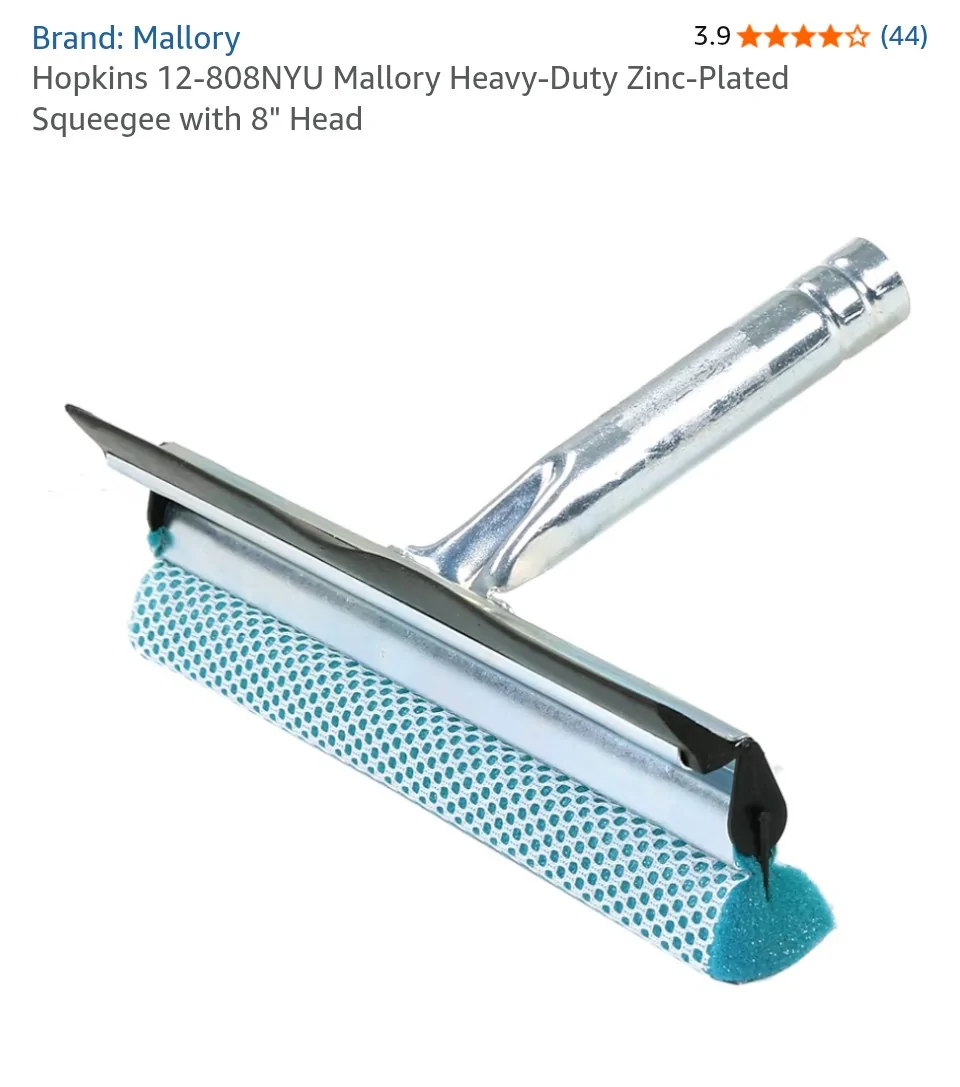

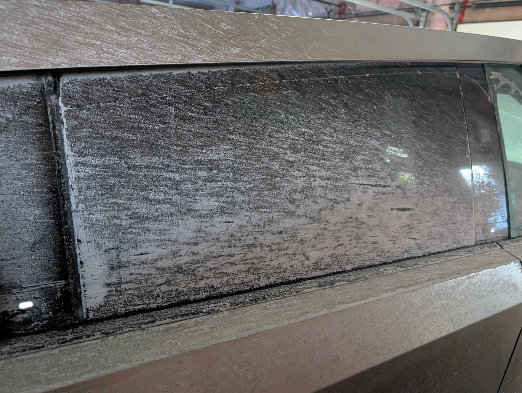

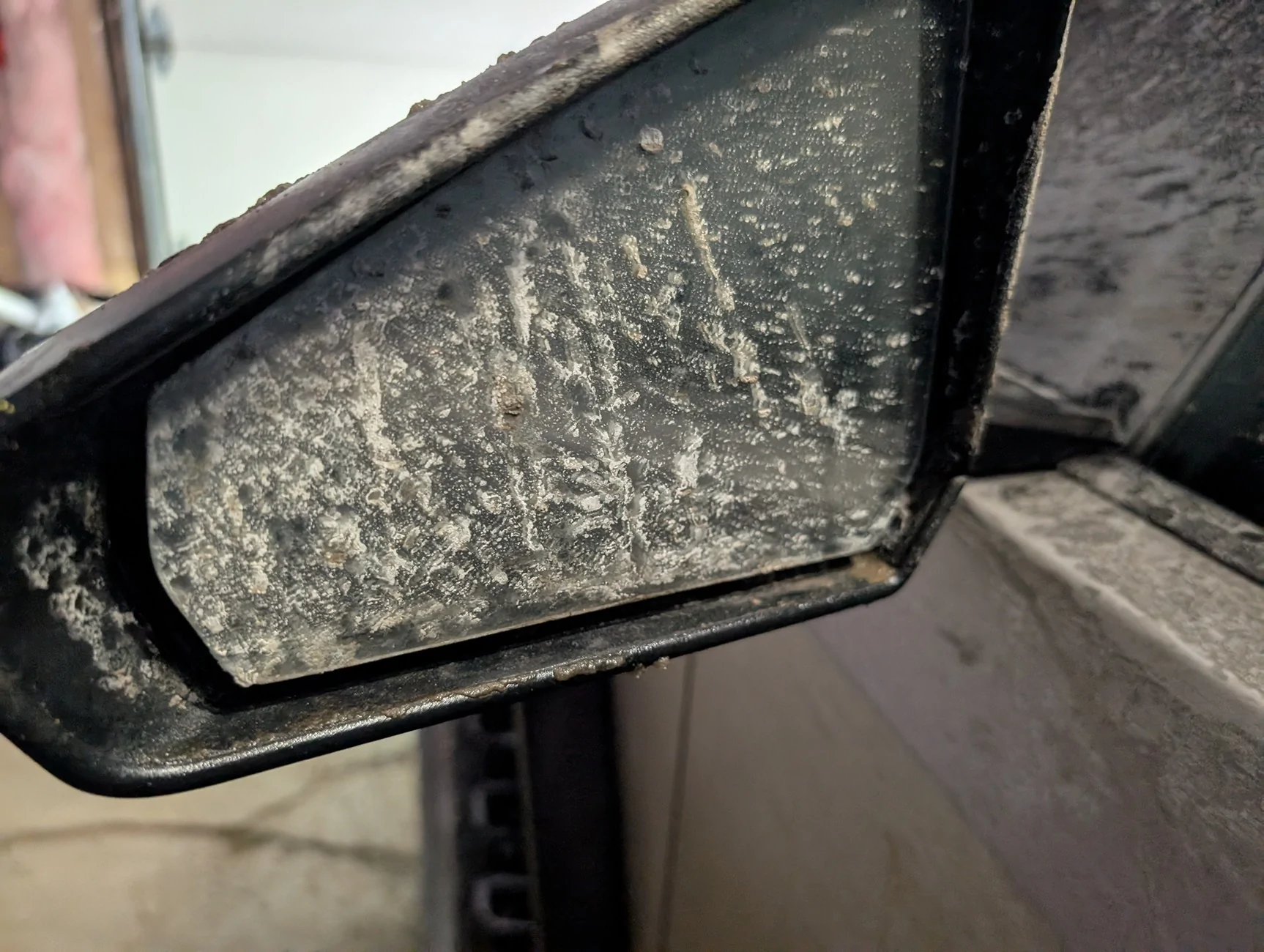

I recommend a Mallory 8" squeegee, small bucket, and extra windshield washer in the frunk so you can do the windows and mirrors when you are supercharging or before leaving the garage in the morning. It gets a little claustrophobic not being able to see out and then it throws salt inside if you roll down the windows to see.

That is a LOT of salt!
