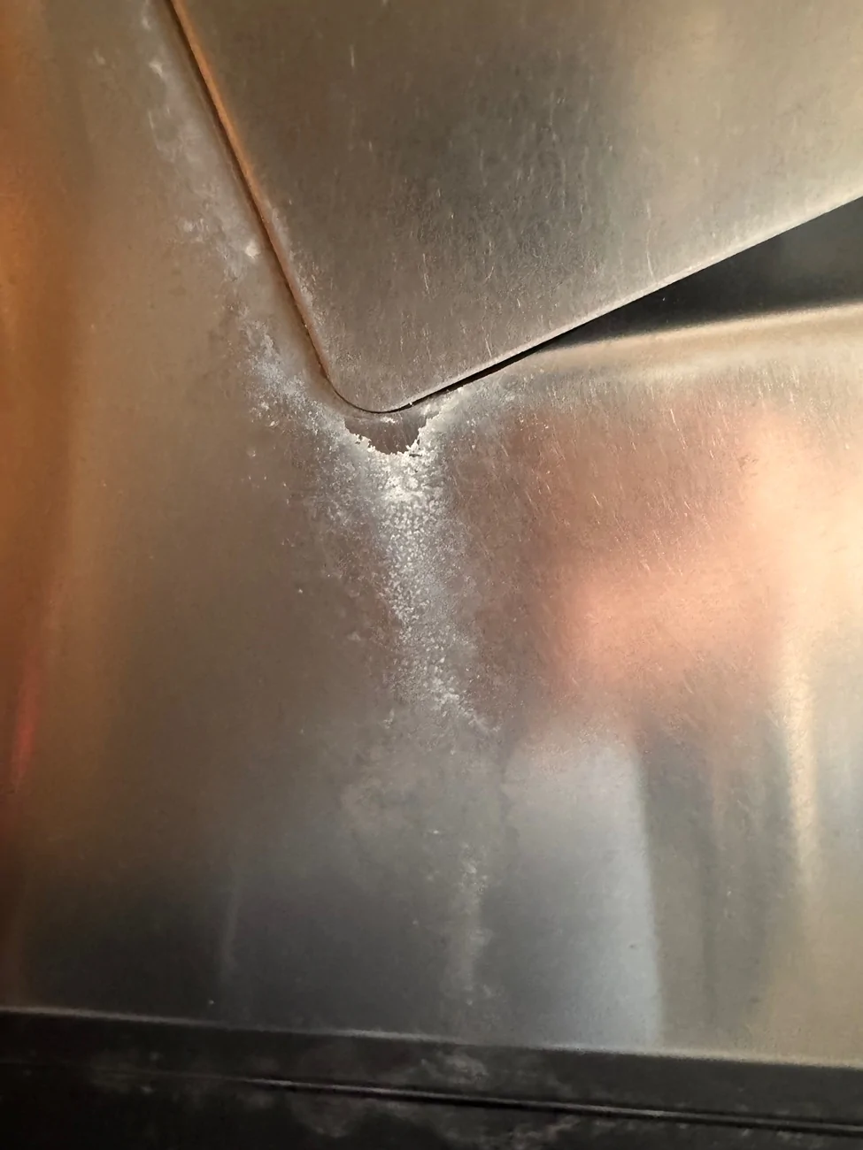

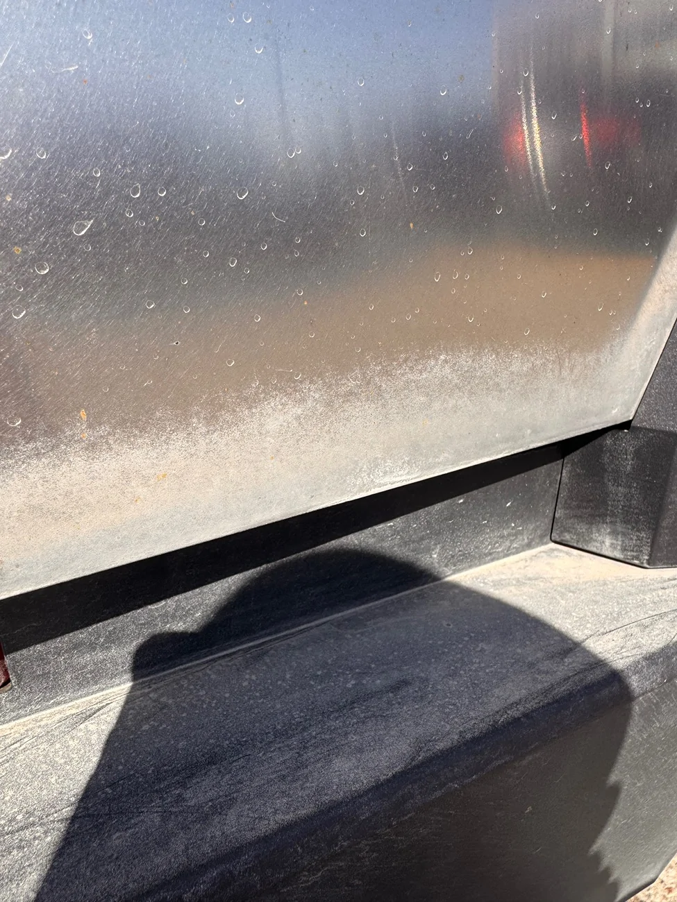

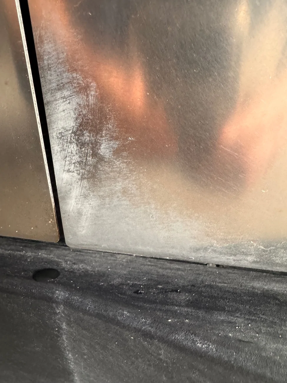

just power washed my cybertruck for the first time after the long winter and these stains didn’t come off
even if I rub my finger on them they don’t clear ip
any suggestions on how to remove these stains? Will I have to do entire panels at a time if I have to use a harsher chemicals?

I managed to get mine off with simple water, regular car wash (gallon jug cheap Turtle brand) soap, and a hand mitt. Though, I've never actually put on the friggin mitt. I just use it like a big rag. But, it worked.

The black plastic bumper on your Cybertruck is also still dirty and covered in dirt not just the stainless steel. I think after you use your power washer to do a pre rinse to remove the loose dirt then you have to use your hand with a wash mitt and soap to scrub the dirt off.

Yes I cleaned all the black plastic trim after I took those photos
but the salt? Stains are still there regular soap and water and scrubbing doesn’t seem to get them off

I went for 3 month ski trip to Colorado and Utah last winter and has those rusty looking salt stains as well. Power washing did nothing to the stain. I used drill attachment with buffing pad wet and Bar Keeper Soft Cleaner Liquid. A little elbow grease and it took it right out. No scratches. Amazon has it. Recommend the liquid.

Agree. Try Cyberbrite and follow instructions meticulously. I would not bring it to a detailer
https://cyberbrite1.com/
Also agree. I see the same salt stains on the front and rear quarter panel leading edges. Power washed with a foam cannon and manual scrubbing mitt, sprayed Iron-X to remove the bulk of the surface contaminants, then Cyberbrite. Removed the salt stains pretty easily. In the past, I've used a synthetic clay bar, but the new process is much less labor intensive.
