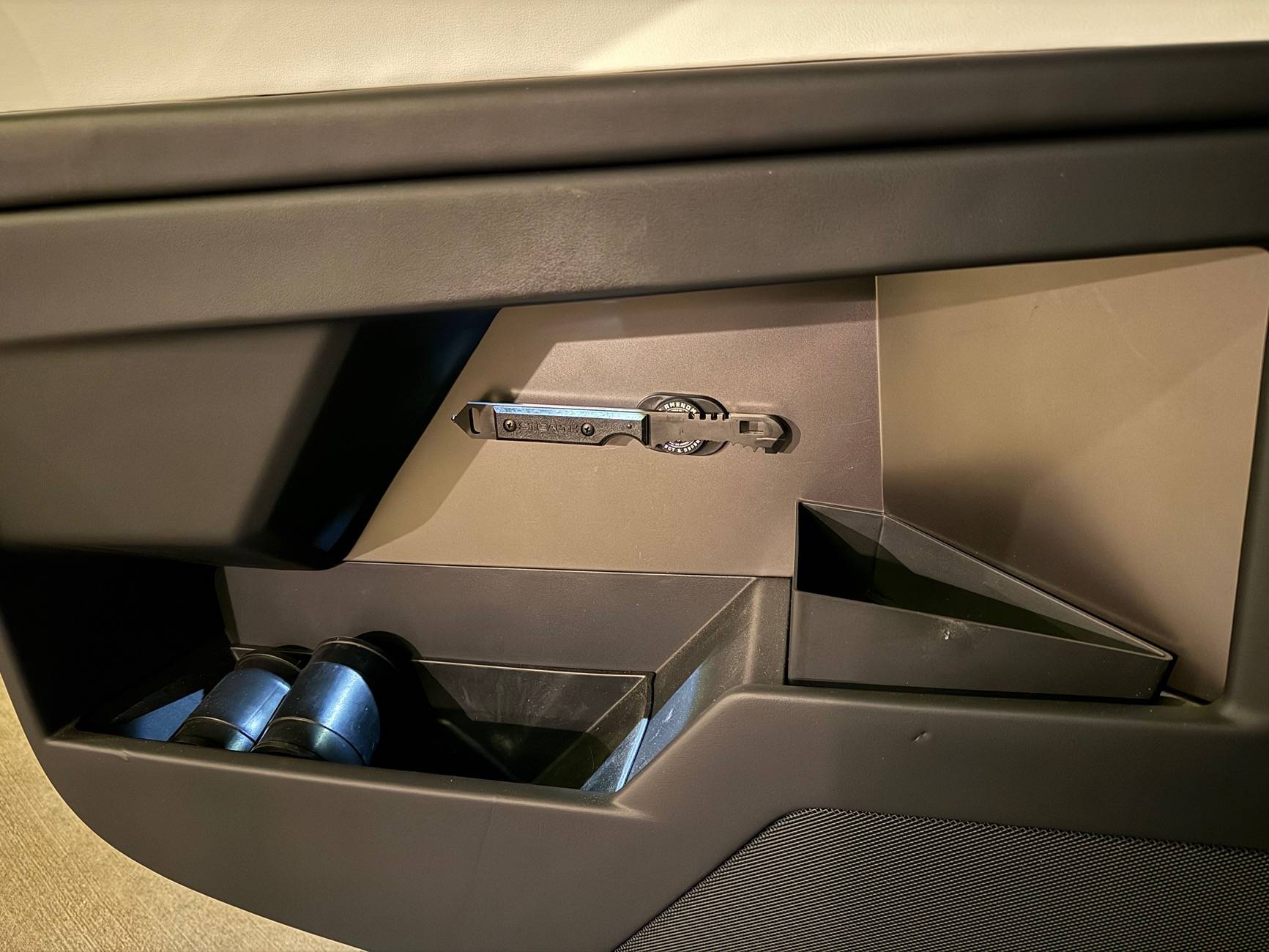

Hopefully will never test it but looks like it's a reasonable option, small & compact + I have a small breaker bar.
Lifeline Rescue Tool + magnet mount from Amazon. Going to add another magnet mount for flashlight near the same place.
