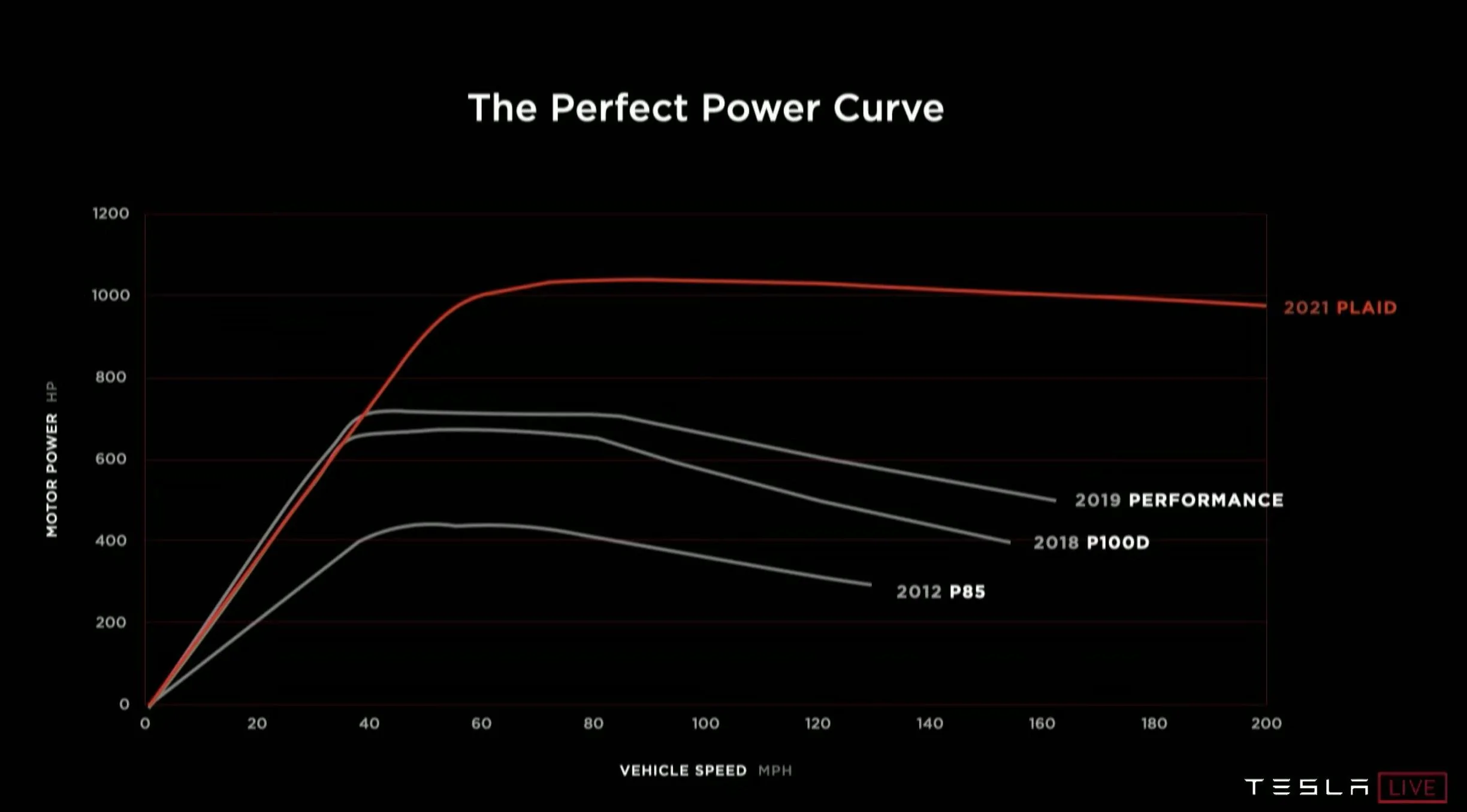

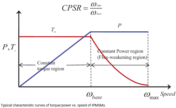

Are you trying to say that Tesla need not have bothered with the higher RPM part?
High RPM and High power works for the Model S. You're argument, if I'm understanding you correctly, is take the motor designed for the Model S, change the gear ratio, and it will work for the CT, which, technically is true. But I don't think using a motor optimized for speed and acceleration is the best fit for a vehicle where speed isn't needed but low end torque is.
From the information given (albeit vague and incomplete)
If Model S is 200MPH at 23,000 RPM, 60MPH = 6900 RPM.
If the truck is 120MPH at 23,000 RPM, 60MPH = 11,500 RPM.
From your Model S Speed/Power graph it looks like the motor goes into constant power region at 60MPH which is 6900 RPM. 6900 RPM on the CT would be 36MPH. After 36MPH the torque on the CT would drop as speed increased.
JBee
JBee
JB
Nov 22, 2019
4,913
6,362
. Professional Hobbyist
Ok. I think I can see what you think the problem is, but consider what happens if you don't change the gearing at all, as a comparison. Imagine you simply put the Plaid rear end on the back of the CT like a powered trailer. Will the CT still accelerate? Will it be able to maintain speed using the Plaid drivetrain? Of course it will.
So now have another look at your graph again, and you can see the torque drops off once you hit the power peak, but it doesn't go to zero until speed max (I'm assuming this is max rpm). That means that provided there is enough power available to overcome vehicle drag, the vehicle will continue to accelerate with the remaining available torque. If your concern is that they will run into a torque or max RPM problem first, then I'm sure that would be factored in.
If the powerband were a problem, in the MS Plaid the acceleration tapers off as well, just at a higher speed, so that shouldn't work either.
Just to be clear, I'm not proposing an actual MS Plaid motor to be used, rather that they make a custom CF wrapped PMSM with more compact dimensions and a liitle lower power output, and use one on each wheel independently and then use the correct gearing, given it has much larger wheels, and uses whatever extra RPM it doesn't need over 120mph for extra torque instead, and move the powerband into the lower speed range, where together with the extra torque its much more useful for the CT.
Without a definitive torque/power graph its hard to tell how to configure the gearing or drivetrain exactly. But I'm not really trying to do that either, except to demonstrate that a higher gearing would benefit the CTs performance for its intended use.
