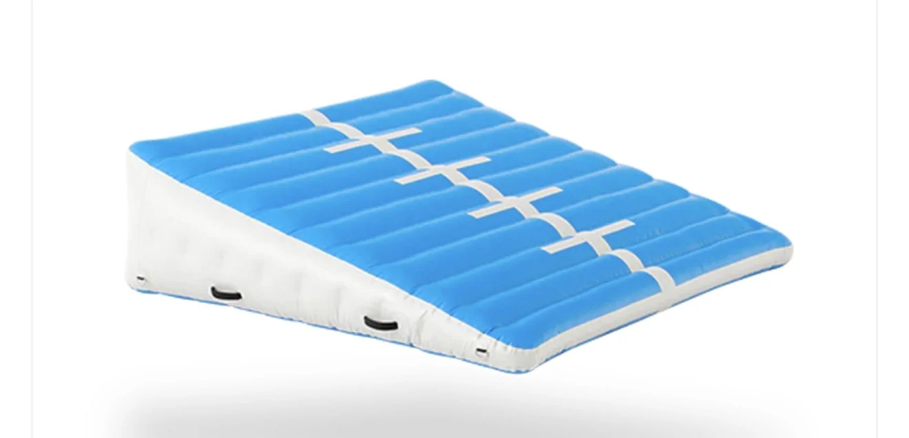

Check this out…not my video nor do I know this guy, but I ran into this video browsing. Basically an inflatable rooftop tent in a bag I could keep in the vault under the cybertent.
the one thing I’d need to figure out is an inflatable wedge to create a flat surface over the glass roof. You could of course stick it on a mars AG short rack or something like that, but that would sort of defeat the goal of driving around with nothing on your roof.
Wonder if Flated or someone like that could make such a wedge.
Is this genius or dumb? I can’t make my mind up.
Was thinking something that kind of looks like this but larger.
https://www.airtrackus.com/products..._0nTOzkcLh3V2yLp5rK8fcwXxFOUcI14F0xBMlXrygSvq
Tesla Cybertruck Yakima Exo Swingbase with Dual shelf and dual gear lockers - Will it work? IMG_5546
