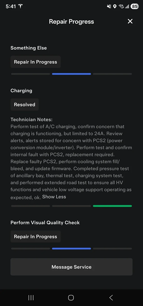

I somehow missed the posts discussing this way back in December. Apparently mine has been doing the same random stopping of charge as yours for around 2 months. I need to peruse the forum more diligently, thankfully I caught this while I still have 2k miles left on the warranty.
Yea hop into service mode and see if you see some PCS_xxx errors. Take a screen shot next time it’s alerts you it stopped and make a service apt so it’s at least logged and you can fall back to it when it does fully fail.

"When the PCS or power conversion system was replaced previously in July, the seals that prevent intrusion from the elements into that area were not replaced. Instead, after the PCS was fixed, everything was closed using the same seals. This allowed dirt from the many off-road trails I have been driving on to find its way onto an area that needs to remain clean, causing intermittent shorts in the communication harness that damaged the high voltage battery."​
