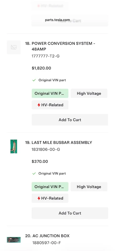

That’s a nice (most likely vibe coded 🙂) app.
Without any data on average miles driven or hours charge per part number this means nothing. if there are only 6 “G” version with only 5 hours charged, and no failures then we can’t confirm it’s fixed.
I have the G version, driving >2,500mi and only L2 charging.
That still doesn’t mean it’s fixed. it’s a very low failure rate to begin with, I have 25k mi and mostly L2 charging and no issues. Others have 60k and no issues, yet.
I didn't say or imply mine will never fail. Just that it's the newest revision.
Gotcha, I thought you were saying that since the chart said that version said “fixed’ and you had 2000 miles that it was confirmed or something.

This will probably end up a recall eventually. While recalls are for safety issue, that will usually include any systemic issue that can result in loss of power while driving or requiring you to pull over immediately. The cases where it simply prevents charging likely won't qualify, but I believe some people have claimed they were warned to pull over immediately. It would certainly be helpful if anyone who's had that type of failure raises a complaint with the NHTSA.
There's absolutely nothing that suggests the latest revision of PCS2 sufficiently fixes the issue, since some of us went 2 or more years before a failure.
Mine finally threw an alert this week, 19k VIN w/ ~16.5k miles. Daily 48A charging, roughly 74% AC charging with occasional Powershare usage.
