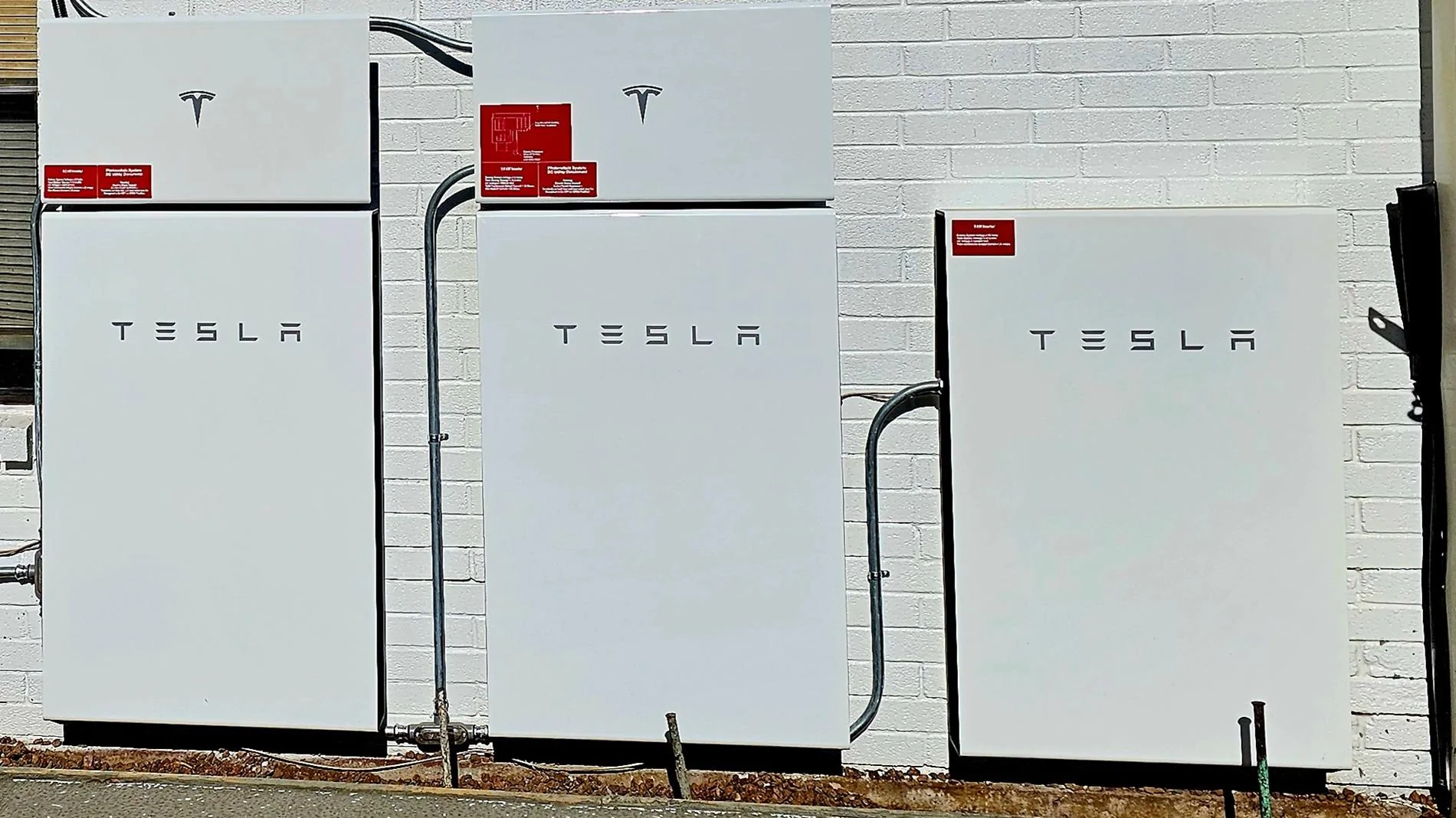

I have 3 Powerwalls and a universal connector. So I'm good to go ? ...Oh wait, my Cyberbeast is still in GigaTexas's womb, no VIN assigned yet?

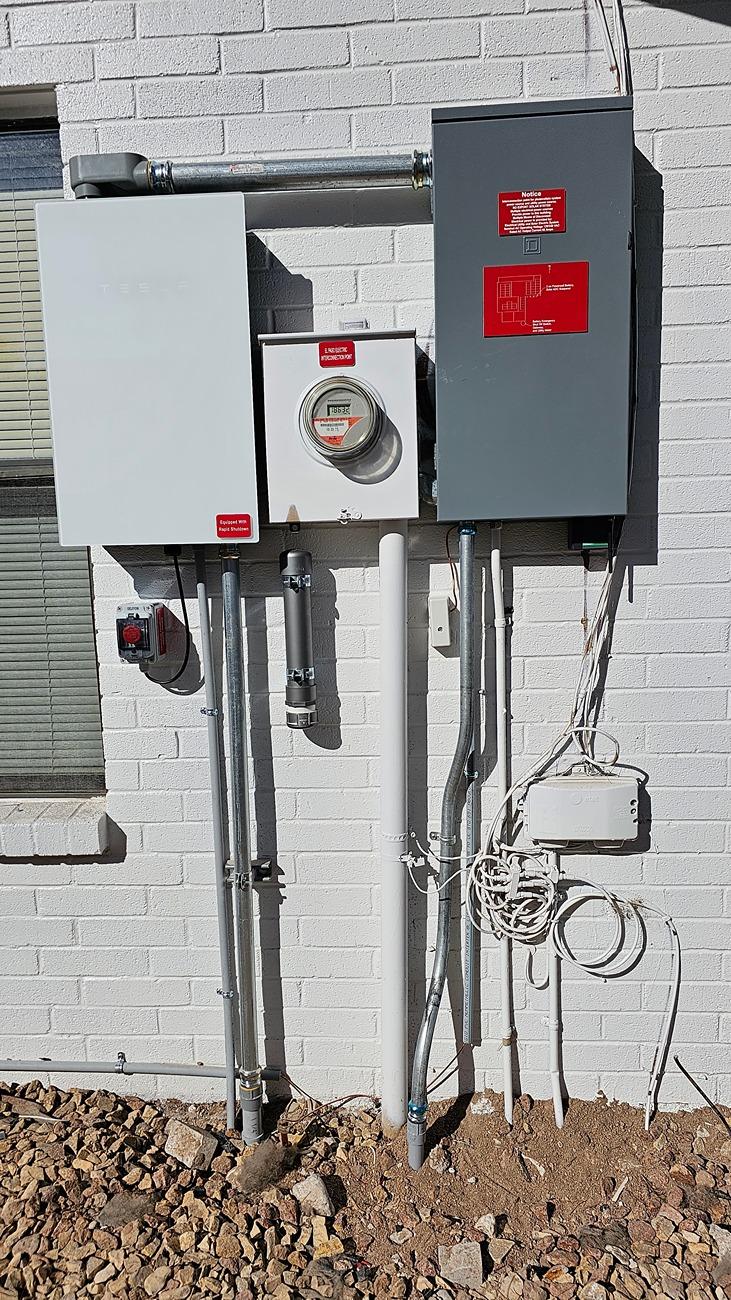

Not sure if that statement is completely accurate. You will need the Gateway to isolate the grid from the house still at least, so just having two Powerwalls won't suffice to use the CT as a Powerwall when the grid fails.

It is implied that if you have powerwall installed by Tesla then a gateway should be installed already.
I have 2 powerwalls and a gateway v2. So now just need new gateway FW to detect and control CT when grid offline. I received VIN today and likely will deny powershare installation.
