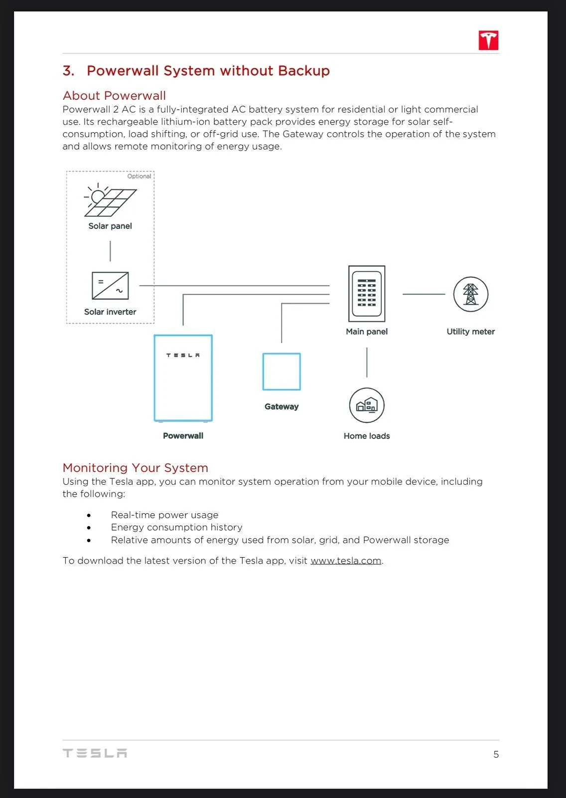

Currently, I have two 13.5 kWh Powerwalls with a gateway. I have solar and multiple Tesla chargers, with a 400 amp single phase service (Pacific Gas & Electric) and multiple sub panels.
My Powerwalls will not power my house during a power outage because the gateway doesn't isolate my house from the grid.
I bought a Beast because of the hardware and installation credit of $4,000.
After I completed the second survey I received a response saying I could power my house with the CyberBeast in the event of a power outage. This is not true because I can't isolate my house from the grid.
Since the software hasn't been released yet, I'm fine with waiting. However, June is coming quickly and I want to be able to get my new gateway/changes to my gateway completed.
Is anyone else in the same situation and, if so, how do you plan to resolve this?

I wonder why your system was set up that way where you can not operate independently of the grid. Given all the hardware you have, you seem to be missing one of the key feature of that Tesla ecosystem.
Ability to go off grid at the push of a button from Tesla app.
Did Tesla design that system or other Solar 3rd party solar installer?

It sounds like you have the deployment without backup. You may be able to have it change to put some circuits behind the Gateway.
Tesla Cybertruck Does anyone have their Cybertruck connected to their powerwall and confirmed it works? IMG_8496
I wanted to minimize the cost of installing the Powerwalls.
Tesla designed and installed the system.
The value of the Powerwalls is the ability to arbitrage rates when my solar is producing power (10:00 am to 3:00 pm) to when I am paying a high price for power (5:00 pm to 8:00 pm).
The CyberBeast includes the labor cost to isolate the circuits and that is of value to me so I can truly be resilient.
