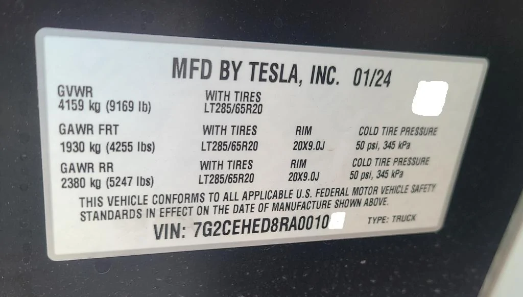

Check the "Vehicle Certification Label" on the driver's door jamb. Should specify the vehicle-specific GVWR and the factory tires.
Here's an example of a real-world Cybertruck Vehicle Certification Label, which was previously posted in an old thread here.
Got a chance to check out and drive a friend's Cybertruck that was recently delivered (a week ago)...I took a photo of the door label for grins, since I hadn't seen anyone post a photo of one...
Tesla Cybertruck 2026 Cybertruck Models in Production & Arriving Now 37510-b63bf9127c4581206b9d4645c2534d60
The D in VIN digit 8 shows that this is a dual-motor AWD. It came from the factory with All-Terrain ("LT") tires, and therefore has a GVWR of 9,169 lbs, and therefore gets H in VIN digit 6. Which all makes sense.

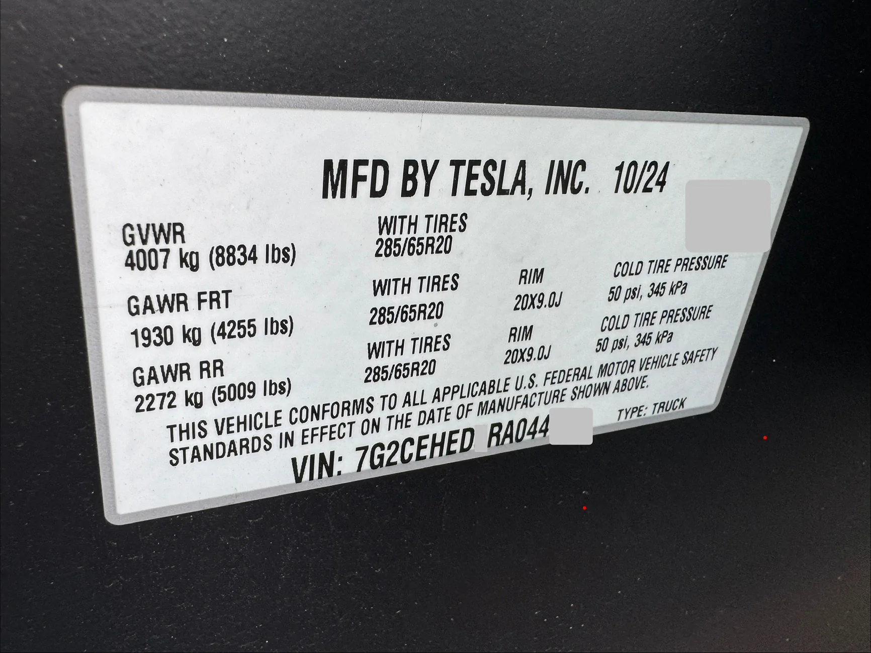

H (6th), D (8th), with AS tires (no “LT”). 🤷‍♂️
OK, I'm stuck.
Tesla's 2024 and 2025 VIN decoders are on file with NHTSA. On the last page, they both state the following about Digit 6 on Tesla truck VINs:
Tesla Cybertruck 2026 Cybertruck Models in Production & Arriving Now ct gvwr
Your sticker shows a dual-motor (D in VIN Digit 8) with AS tires (no "LT") and a GVWR of 8,834 lbs. That GVWR matches the specs in the Owner's Manual for an AWD with AS tires.
According to the VIN decoders, a GVWR in the 8,001-9,000 lbs. range should get Class G in Digit 6.
Obviously a GVWR of 8,834 lbs falls within that "G" range.
So I can't explain why a Cybertruck with a GVWR of 8,834 lbs gets Class H in Digit 6. H is supposed to be for GVWRs in the 9,001 to 10,000 lb range. Tesla doesn't seem to be following their own VIN decoders here.
I searched for partial VINs online; VINs are commonly listed when used vehicles are advertised for sale. No problem finding 7G2CEHED VINs (AWD) or 7G2CEHEE VINs (CB), with H in Digit 6.
But I'm not seeing any 7G2CEGED or 7G2CEGEE VINs, with G in Digit 6, even though some AWDs and CBs (with AS tires) do have GVWRs in the "G" range of 8,001 to 9,000 lbs. So in practice, maybe all AWDs and CBs get "H" in Digit 6, regardless of the actual GVWR ?
Apparently the (rare) RWDs out there do get G in Digit 6. Here's an example of a 7G2CEGEC VIN; the C in Digit 8 means single-motor. According to the Owner's Manual, the RWD has a GVWR of 8,199 lbs.
