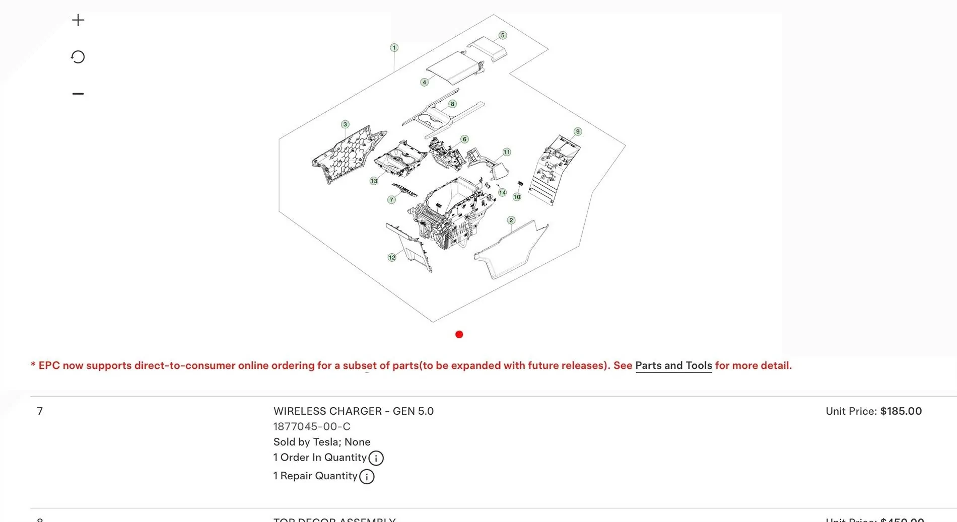

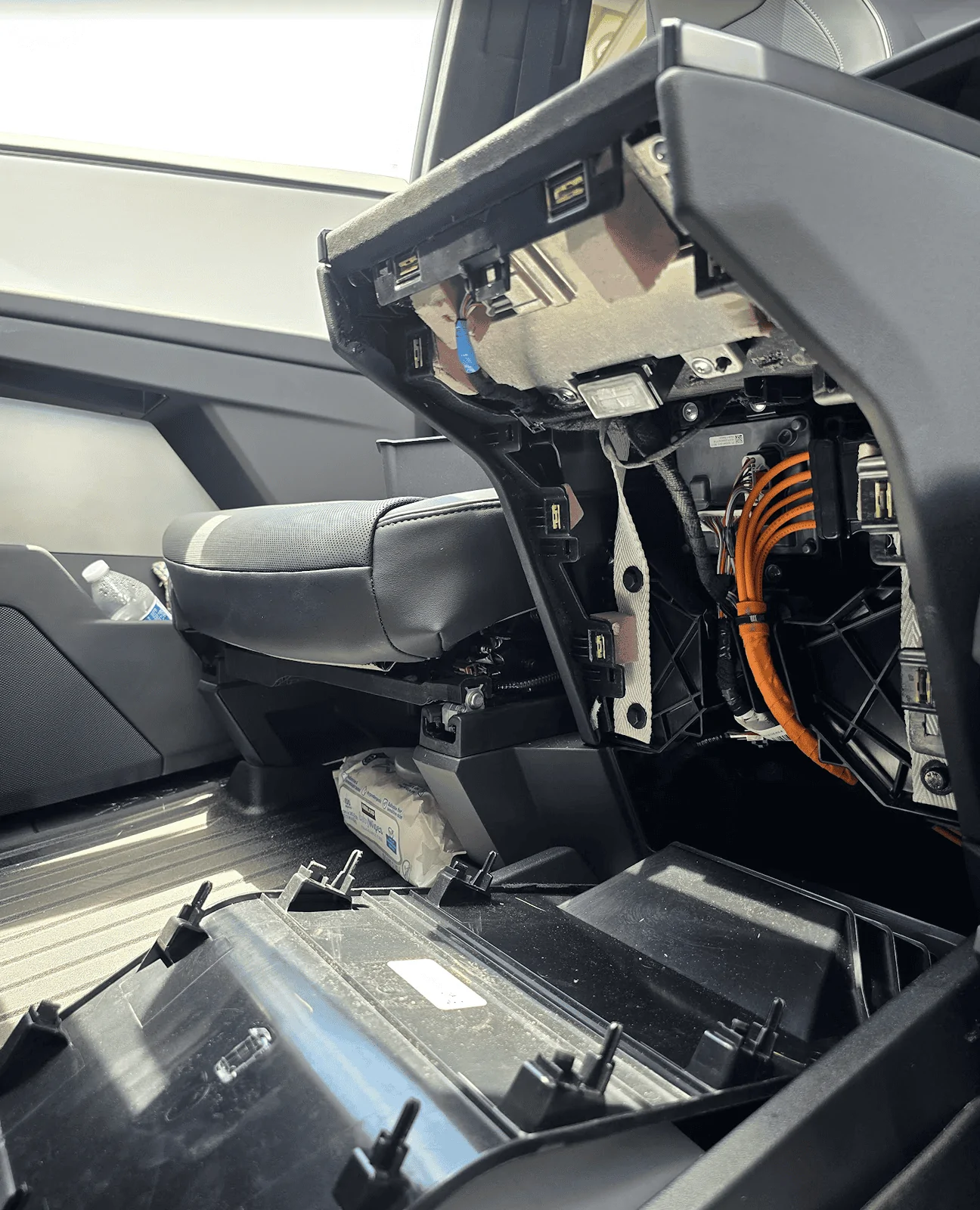

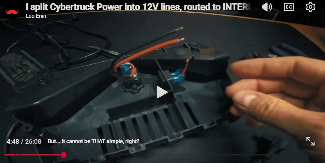

MCraft99
Feb 20, 2026
145
134
FS CB 8/24
You can tap in to the center console 12V feed for the wireless chargers. I'll try to find the thread where they opened the panel to see the wiring below the wireless chargers. Here's a different thread that just shows what it looks like: https://www.cybertruckownersclub.com/forum/threads/disable-wireless-charging-pad.15032/post-343274

Acitty
AC
Apr 8, 2026
Puerto Rico
Thank you! That looks terrifying to me ;)
