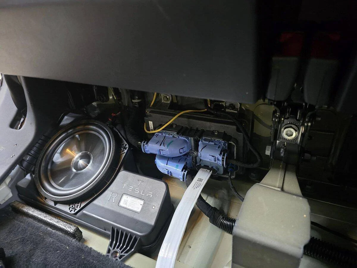

If you've listened to a Cybertruck's audio system, the first thing you'll notice is that it has deep bass, but there are only two 8" subwoofers with small enclosures under the rear seat, buried in the floor. What's the secret? ?
Tesla Cybertruck Cybertruck subwoofer teardown reveals why stereo system's bass is so good 1732220254025-c5

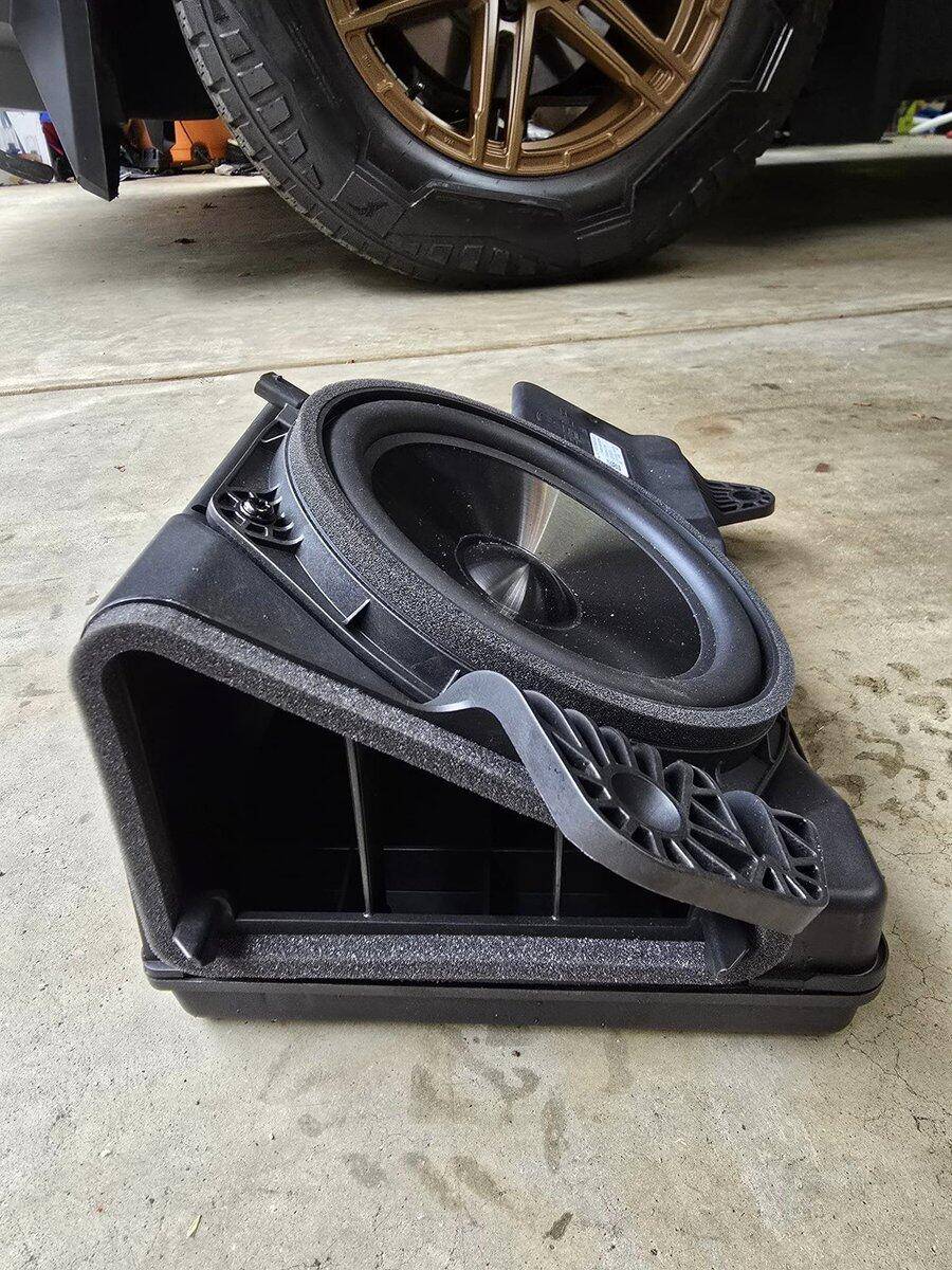

Removing the enclosure, it looks like it is a simple ported enclosure. But it is so small, and the port is gigantic. Not a great way to get lots of bass.
Tesla Cybertruck Cybertruck subwoofer teardown reveals why stereo system's bass is so good 1732220292280-bx

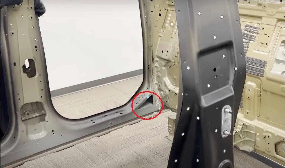

The secret is revealed by that foam gasket. The enclosure tightly mates up to the frame and creates a much larger sealed enclosure, using all of the dead airspace within the structural frame cavity!
Tesla Cybertruck Cybertruck subwoofer teardown reveals why stereo system's bass is so good 1732220332336-6v

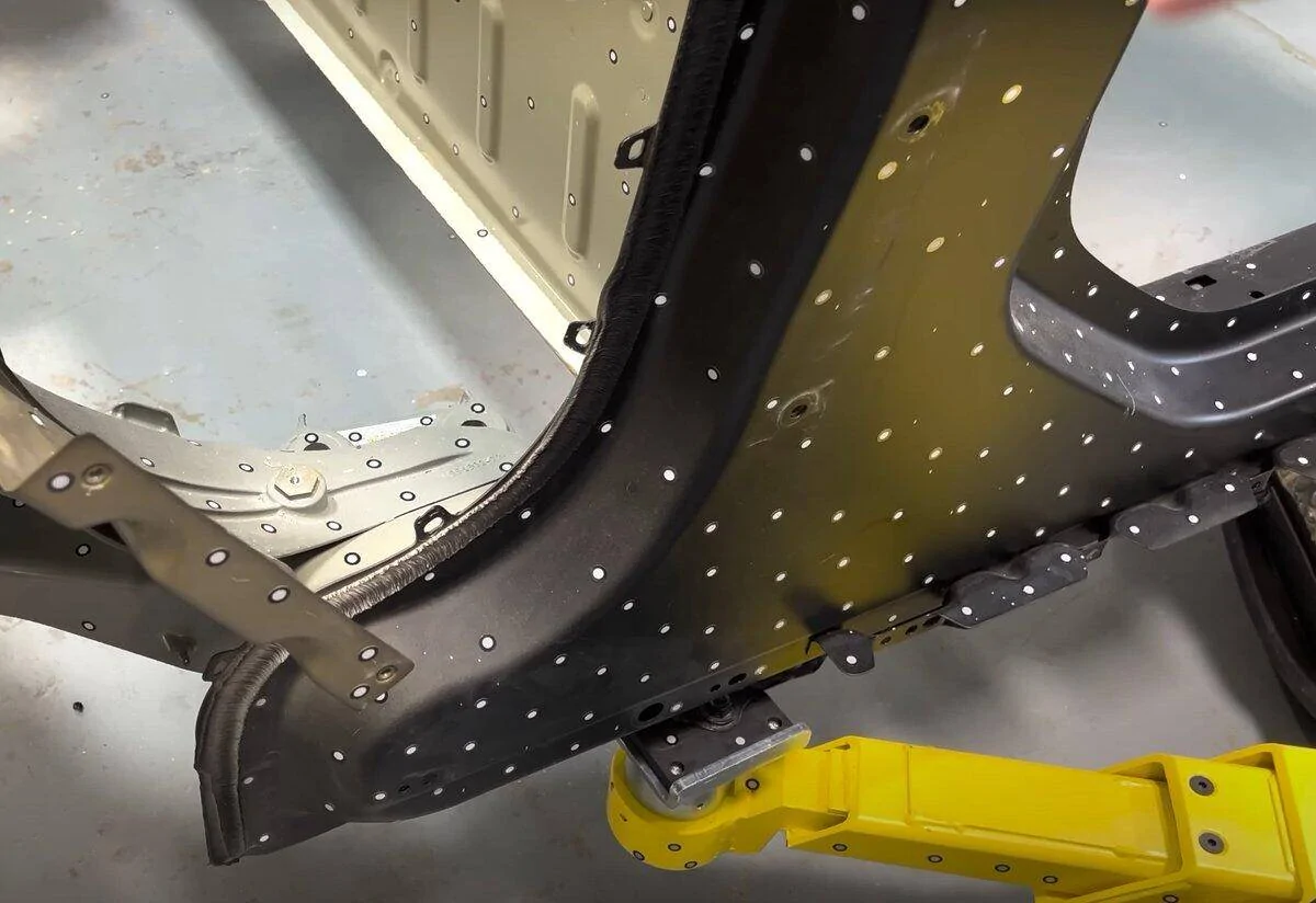

This cavity extends backwards past the rear wall, and up the C pillar. Very clever engineering, with typical Tesla cross-functional cooperation.
Tesla Cybertruck Cybertruck subwoofer teardown reveals why stereo system's bass is so good 1732220362025-1j
Having a larger sealed enclosure allows for a deeper bass response, while still being punchy and even across the spectrum. Typical vehicle subwoofers use a ported design which can be smaller but is tuned for specific frequencies and is less controlled.
