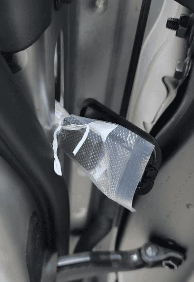

Going in for tint tomorrow. Given the issues reported with post-tint water interfering with the door controls, I thought it would be prudent to cover the exposed, up-facing, mirror connector. I used my Foodsaver to create a custom-sized bag. Had to slit up the back halfway to make room for the connection to the cover but the exposed pins are fully covered now.

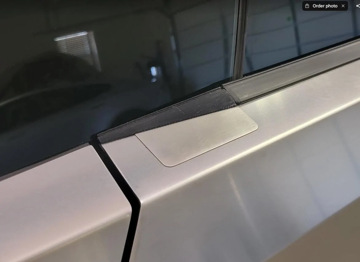

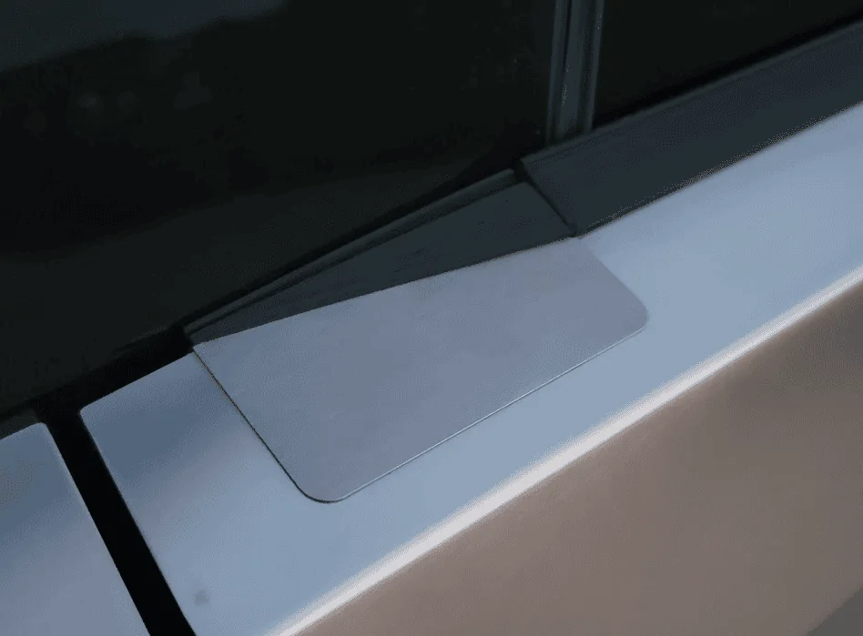

Update: I went through a few more iterations and finally have a decent model for SLM printing in 306 stainless. I printed them with in3dtec for about $60 total for the pair including shipping. The model is uploaded here - use the v3_metal versions for metal only (design rules are somewhat different for SLM than for FDM printing).
I got two pairs so I could put one on while I experiment with sanding the other to match the CT finish. However, the standard glass-bead finish that they come with doesn't look too bad:

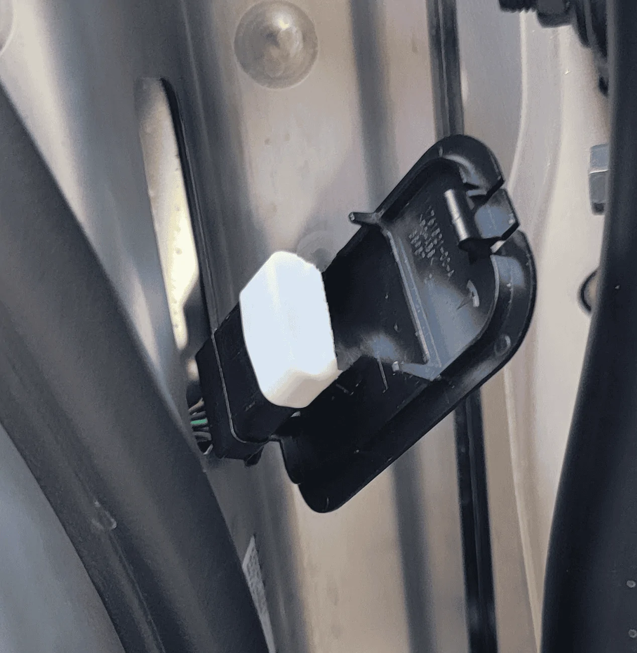

I don't know if anyone else printed the metal version of the mirror delete covers. I designed and uploaded a new trim version (_v4) which I think looks better. It extends the trim taper all the way to the edge of the door instead of stopping at the edge of the cover.

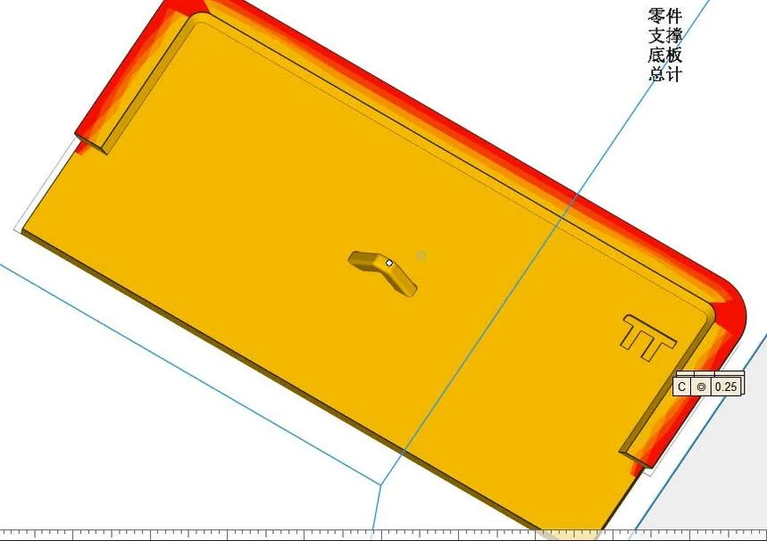

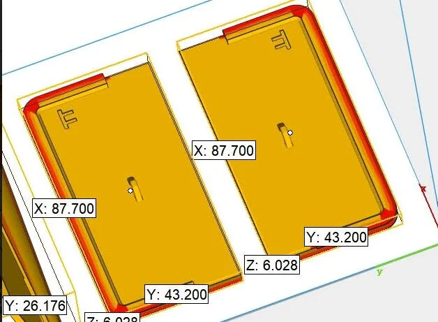

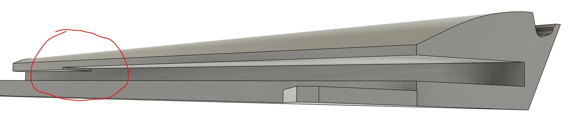

I received this response from IN3DTEC:
"Thanks for reaching out to us. My name is Stephanie and nice to talk to you.
Please check the below image, the below two parts have thin thickness which might break during the printing. Please help increase the thickness by using the below recommendation.
Metal Printing: 0.5mm is minimum
TPU: 0.8mm is minimum
Thanks and please feel free to upload your files to our website and get instant quote."
Tesla Cybertruck 3D Print Mirror Delete Covers (now printed in stainless steel) Screenshot 2024-09-14 at 7.18.40 AM
Tesla Cybertruck 3D Print Mirror Delete Covers (now printed in stainless steel) Screenshot 2024-09-14 at 7.19.10 AM
They recommend a minimum thickness for metal parts. Did you get a similar warning? Should I tell Stephanie to proceed with the files as is? Thanks for your help.

Dang it! I *did* see that same 0.5mm DRC message and I fixed it. However, it appears I forgot to update the file on the Prusa site. Delete the _v3 you have and download the "vSS" models I just replaced them with instead.
TPU is a great choice for the trim since it is flexible. The only geometries I found <0.8mm were at the logo and at the notch for the cover (see below). I don't think we want to increase that notch since the cover is only 0.5mm thick. I uploaded a _v4b set of trim pieces with the logo removed. You can see if they will accept it. If not try PETG - that may not have the same 0.8mm rule.

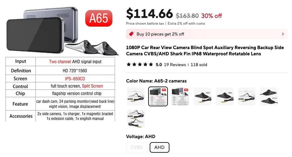

BTW, I've been testing the use of Tesla's 3-camera display as a substitute for using the side mirrors. It works well for benign driving situations. On a recent road trip where I found myself more dependent on the map view, however, I found myself going back to using the side mirrors. I've concluded that I need dedicated side view cameras installed before removing the side mirrors on the truck.
I ordered a blind spot camera system from AliExpress that might serve the purpose.
Tesla Cybertruck 3D Print Mirror Delete Covers (now printed in stainless steel) Screenshot 2024-09-14 at 9.38.20 AM
I chose this system for the less obtrusive shark fin cameras that are mounted ahead of the front doors, and the 6.25" split screen display. I plan to do a quick, preliminary install to test the system as a viable mirror replacement on my trip to Arizona. I think that mounting the display on the dash above the steering wheel will be ideal. It's a 12V system, so if I decide to do a permanent install I'll have to find a 12V circuit in the truck to tap into.
Another option is to buy two displays, one mounted on the driver side A pillar and the other on the passenger side A pillar which would be more natural for drivers used to mirrors.
Unfortunately, the 120 deg camera view angle will make cars appear further away than they really are, much like the CT's rear view camera display does. A narrower angle camera (e.g., 80 deg) would minimize that distortion although at the expense of a more restricted field of view.
The link to the AliExpress page is here if anyone is interested.
