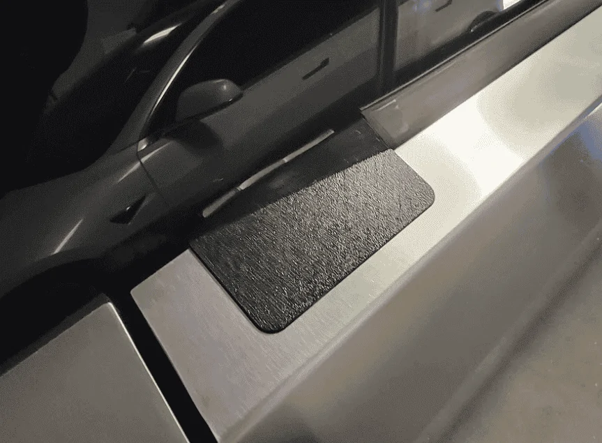

Nice work! I personally like the side mirrors and wouldn’t remove them even if Tesla themselves provided a cover. Towing without mirrors and only cameras would be super hard. However these covers look slick and I would use them if I removed the mirrors.

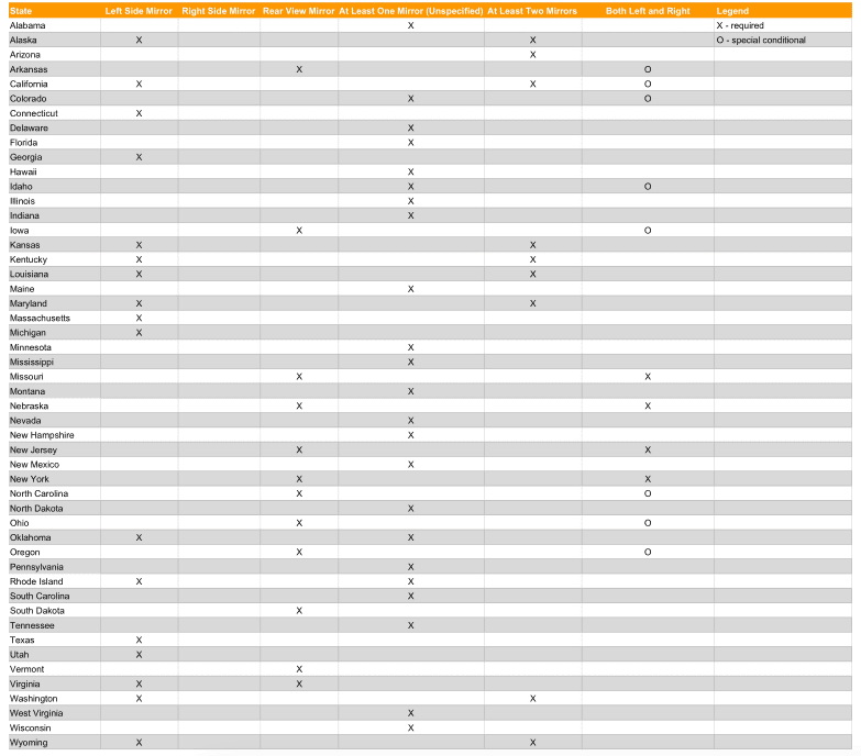

According to this summary of state mirror requirements, only 15 states require two or more mirrors on a vehicle. A CT without side mirrors, but retaining the rear view interior mirror, meets the requirements of the remaining 35 states provided the tonneau cover is retracted. Of course, driving with the tonneau up defeats any efficiency gains by removing the side mirrors.
The intent of these laws is to insure that the driver has reasonable visibility to traffic behind and to the sides of the vehicle. As I see it, the CT meets the intent of these laws using camera displays, but having to convince a judge of that is not something I look forward to doing. There's also the matter of liability in the case of an accident. The other party's insurance company could claim that I was at fault due to not having the required mirrors on my truck.

Tesla Cybertruck 3D Print Mirror Delete Covers (now printed in stainless steel) IMG_0205
Tesla Cybertruck 3D Print Mirror Delete Covers (now printed in stainless steel) IMG_0206

Interesting. Do you know how they populated this table? It says two required for Arizona but the law I was able to find said that was only required if you did not have a clear view behind the vehicle. Did not say without the use of electronics or mirrors.
Current Arizona law on the subject of vehicle equipment states:
A motor vehicle that is constructed or loaded in a manner that obstructs the driver's view to the rear of the vehicle from the driver's position shall be equipped with two mirrors located in a manner to reflect to the driver a view of the highway for a distance of at least two hundred feet to the rear of the vehicle. This section does not apply to a fully autonomous vehicle that is incapable of operation by a human driver.
A.R.S. § 28-956
Amended by L. 2021, ch. 117,s. 11, eff. 9/29/2021.
So you're right, the table is wrong on that point. Arizona doesn't require two mirrors. Furthermore, Arizona law doesn't explicitly state how a clear view 200 feet to the rear of a vehicle is to be achieved unlike, say, Illinois which does. If the vehicle is constructed or loaded to obstruct such visibility, two side mirrors are then required. Since the CT provides a means to provide a view to the rear of the vehicle for 200 feet using a camera and display, one could argue that mirrors on the CT are not required.
