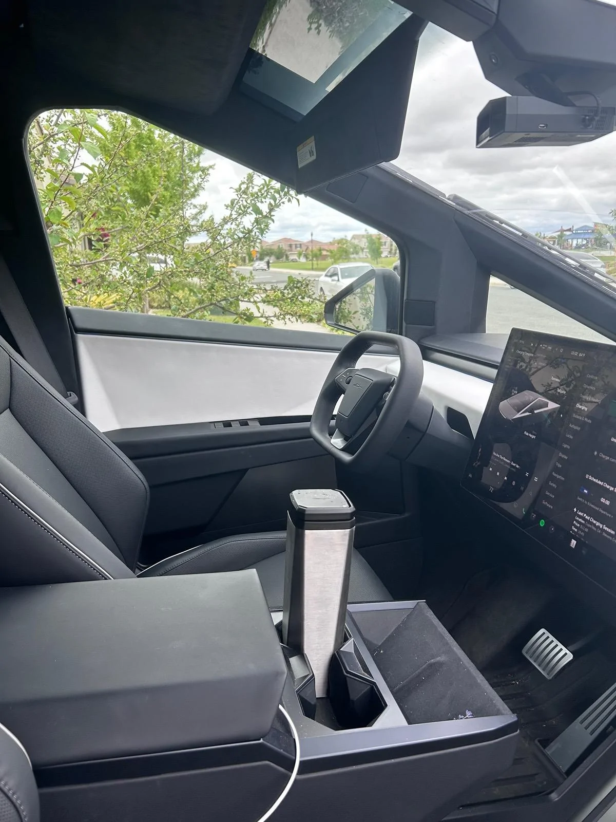

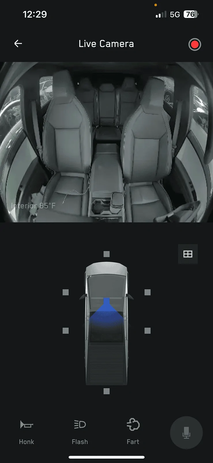

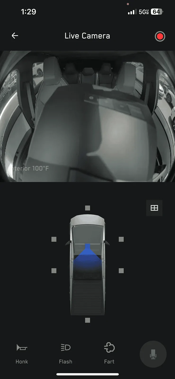

This is great. Does it block the in car camera at all?
It blocks a little bits and you can still see driver and passenger faces. I may redesign it when FSD available and if it prevents FSD functionality.
Looks like it block most of it not a bit of it.

Would love if you can share a 3d print file of something like this for same mount point where it doesn't block the interior camera view a lot. Perhaps extending the length slightly can make it out of view to the interior camera?

If it blocks the interior camera fsd may Not work when it comes out.

Yes, would love a version of this I can 3D print where it won't block any of the interior camera view. FSD will not work with view obstructed like this when it comes available in June for Cybertruck.

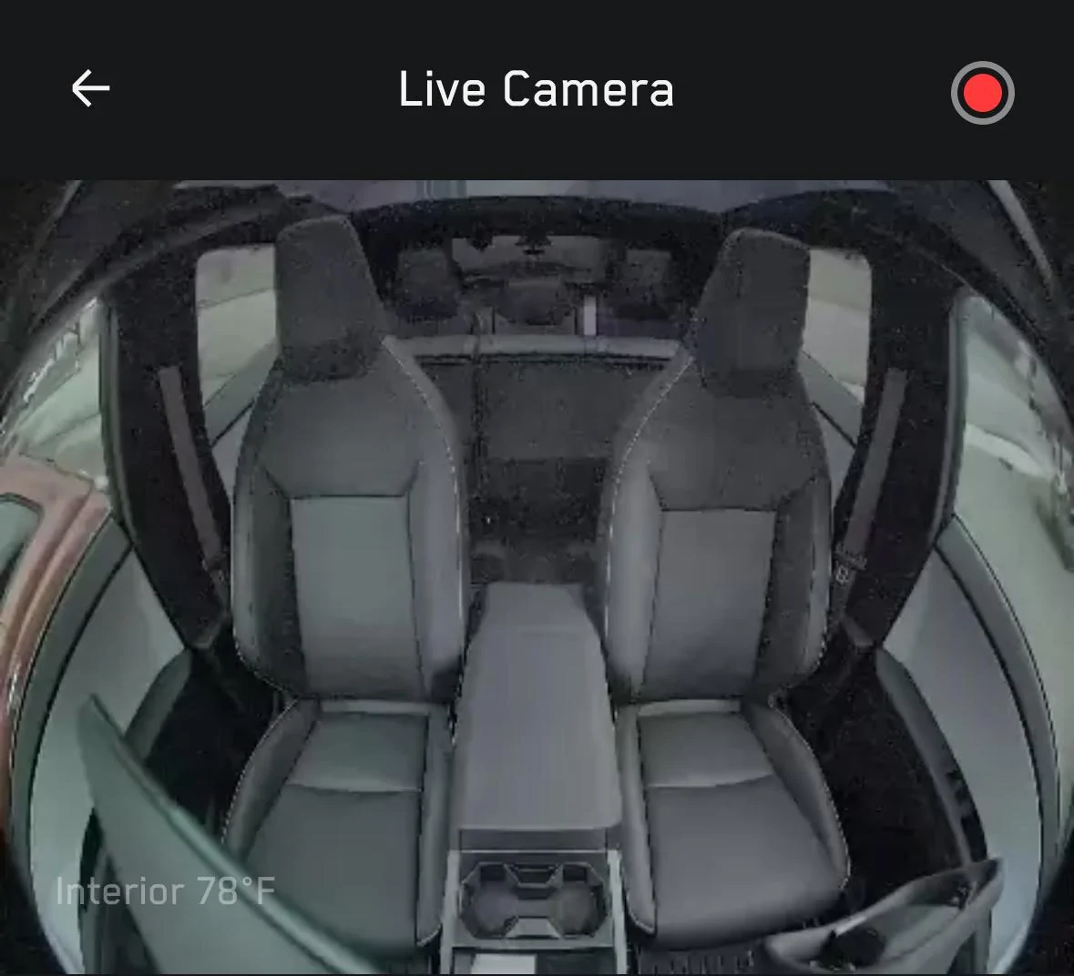

Working on new version that doesn’t block the view.
Here is the view. You can see the new Cybervessle :)
