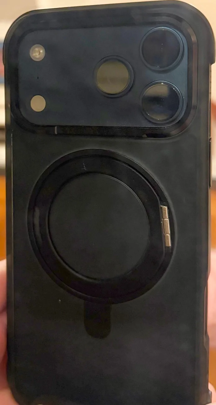

This does look very promising. And may work for some phones, however phones that have a camera bump out like most of the iPhones out there will have issues because they won’t be able to lay flat on the magnet surface. Probably two ways to correct this. One would be to decrease the spacing between the top edge and the magnet.
To work with my iPhone 17 Pro Max, it would have to be around 1/8”-3/16” with the case I have on it. The other way around it is to raise the magnet. (a better more universal option.) and the magnet has to be high enough from the bottom in order for iPhone Max to fit in it so it may require you lengthening the bottom portion as well.
iPhone 17 Pro Max with case

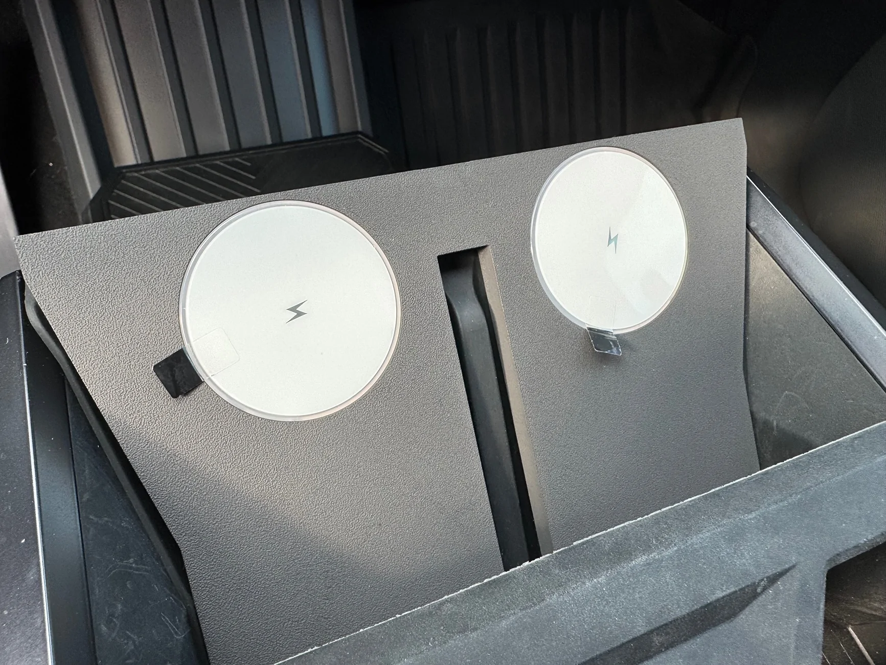

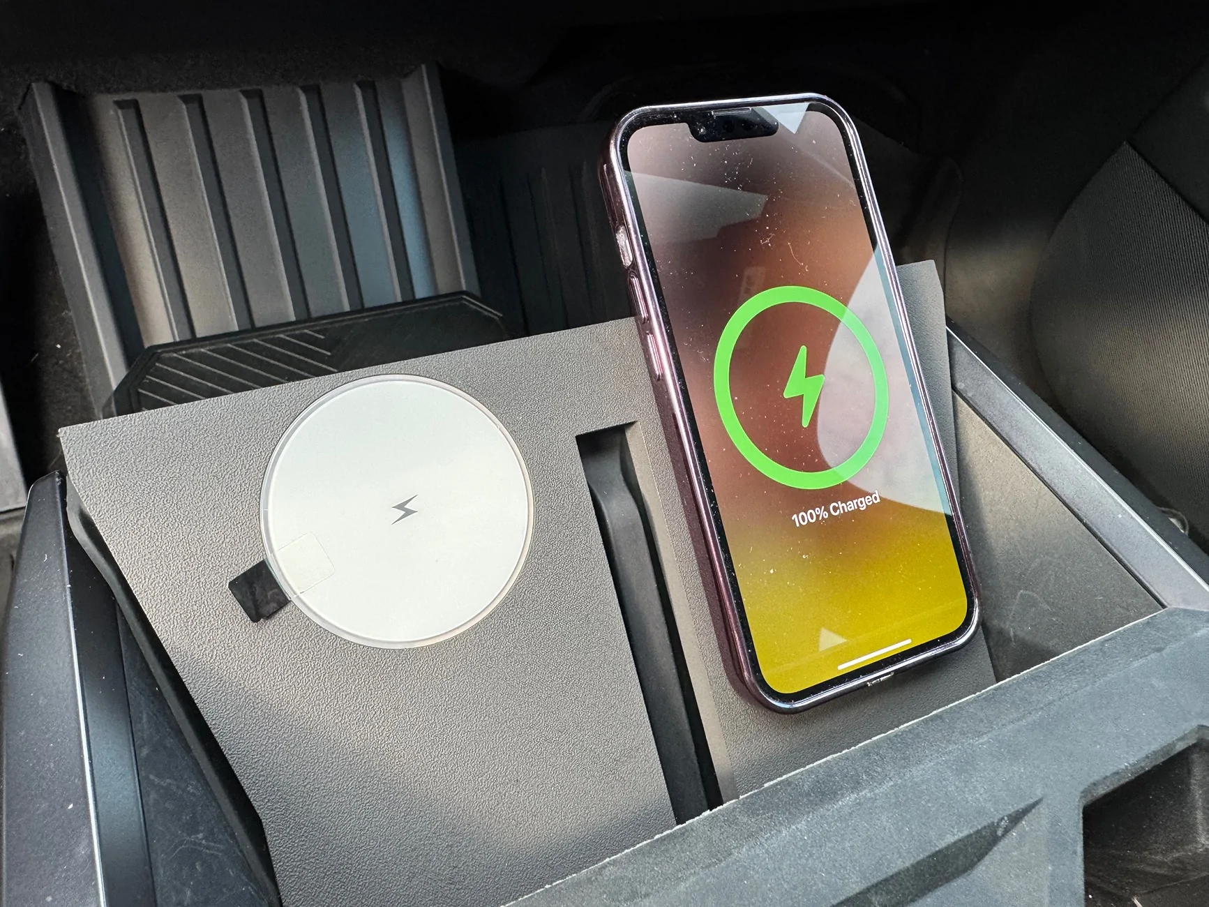

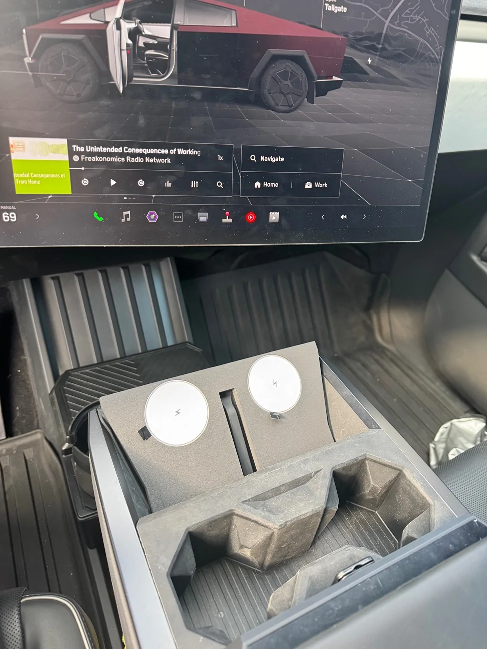

Update: I’ve tinkered with the design and have been using it for a week or so I’ve decided that the native look off the printer, without painting it, will likely be best. Nice textured look without the chance of the paint getting marred. I’ve moved the chargers up a bit so that the phones can lie flat without interference from the phone’s camera cluster.
The chargers charge as expected and the phones do not get hot as before. They do get warm - as expected.
As I mentioned, I already have a charger mounted on the center screen - but I do like the phone on this mount a lot. It’s a bit higher -by an inch or so - so it’s a little more visible but not nearly as distracting as when mounted to the screen.
