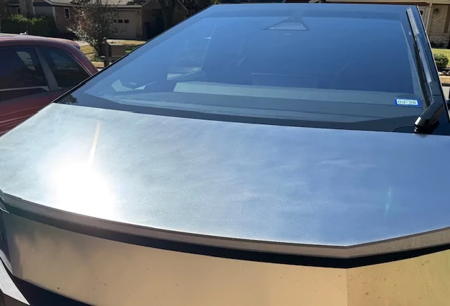

This guy shows you how simple it is to bring an old, abused and scratched-up finish back to brand-spanking new. This is, by far, the best, no-nonsense Cybertruck surface re-finishing video I've seen on the net:
I see a lot of people spreading fake and misleading narratives that this is a difficult process. This video proof should dispel those false narratives - it's dead simple and relatively quick compared to finish restoration on cars with soft, damage prone paint. The Cybertruck, with no clearcoat, no easily scratched paint, just solid, homogenous damage-resistant metal, polishes back to better than new with a simple surface sanding. Watch the video to see how easy it is.
The video follows the procedure provided by Tesla in the online Service Manual almost word for word. I've done this on my Cybertruck after multiple muddy, heavy-bushwhacking trips that left the surface covered in ultra-fine linear scratches that show up when the angle of the lighting is just right to expose them. Works a treat!

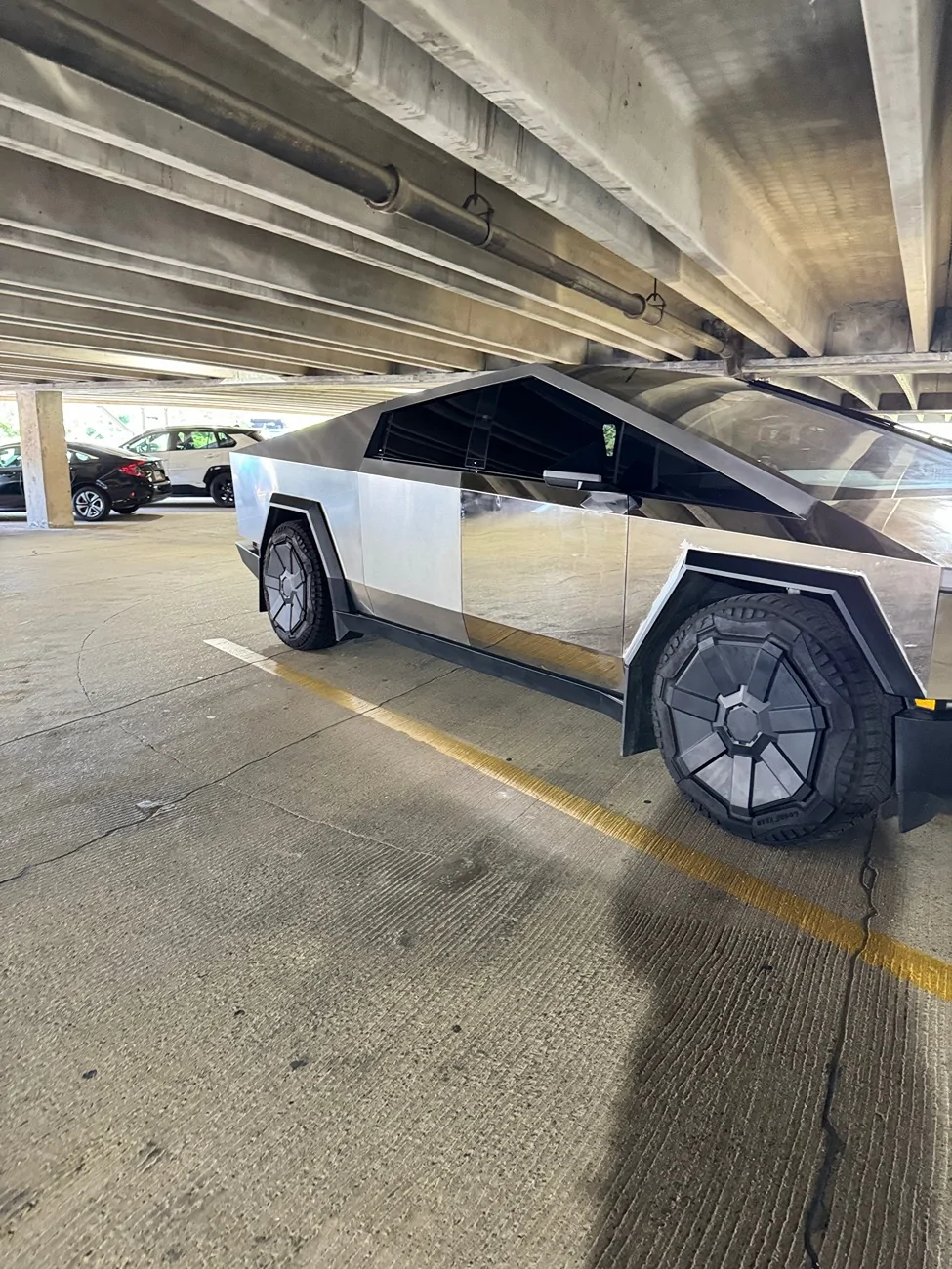

Just the video I was looking for. I have made a terrible (stupid) mistake while taking off the old ppf on it. Now I have hope that I can recover. Thanks OP

I had it about 2years on there. Some idiot decided to damage it with a knife or some unknown object and made a tear on the top part. Granted it was applied by an amateur (that’s me) wasn’t evenly applied. It was 50$ to replace with the same ppf I got from amazon. So why not?
While removing rushed and didn’t even used a heat gun hence it left an extreme amount of residue. Again being a rushing idiot, didn’t ask ai or google how to remove glue residue. Looked around and see some abrasive pads laying in the garage and combined with panic brushing…well here is the result. Clear enough? lol

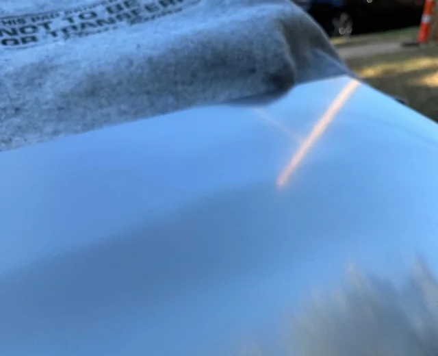

I have a DA polisher, and two sets of off-brand disks from Amazon (maroon and gray). I plan on doing the whole truck but thought I’d start with the frunk lid, since it’s got a scuff mark and a couple of scratches that I wanted to work on.
After a few passes, it looked shiny and new:

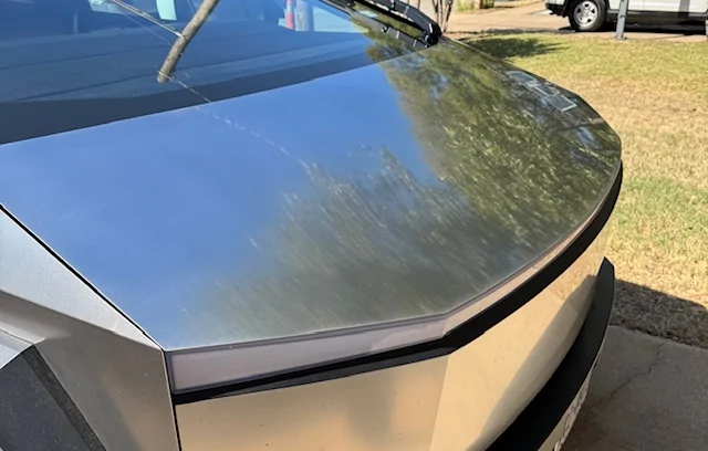

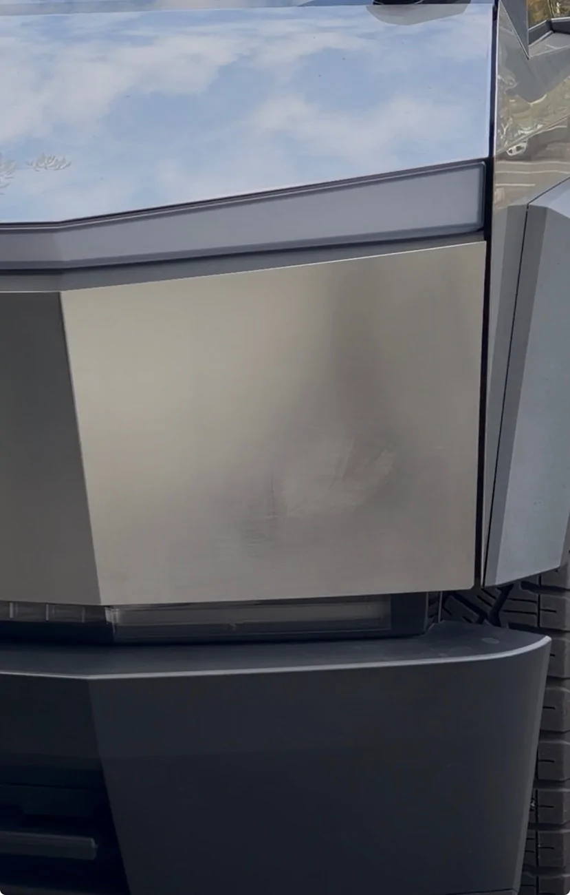

While good from this angle, I had worked the scratch aggressively, which left a dark streak:
Tesla Cybertruck Super-easy Cybertruck refinishing: How to Fix Scratches on a Tesla Cybertruck IMG_1563
Blending the area did little, and neither Citri77 nor BKF made a dent. It seemed to fade over time, after a couple of hours I could barely see it.
Once the sun came out, I could clearly see the swirl marks and banding from my efforts.
Tesla Cybertruck Super-easy Cybertruck refinishing: How to Fix Scratches on a Tesla Cybertruck IMG_1566
