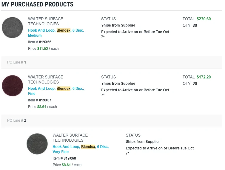

Excellent video! I'm anxious to try it to repair a few crates on my hood. Has anyone found the pads Tesla recommends or something equivalent at a local hardware store or a site online? I've looked and not found anything. The Grainger site has a minimum purchase of 20 for each disk... I don't want to buy that many just for a small hood scratch repair. I have a 5" sander.

Agreed. Great video. Love the level of detail. But, does anyone know the part numbers of the discs? 3m or otherwise?
This is a snapshot of my Grainger order (part numbers taken directly from Tesla's refinishing guide). The 20 pad minimum order quantity makes it pricey, but then again it's an 80K+ truck that you can refinish in your driveway (I sure did). For the <$1K in pads and tools you likely couldn't even get a good spray gun and dryer system. Not to mention the neurotoxin 2K paint, compressor, and paint booth required for a good paint job that has to be followed up wiht sanding, compounding, and polishing.
Link to my post below with a link to another post within. Linkception :unsure:
https://www.cybertruckownersclub.com/forum/threads/caught-my-ct-in-the-sun-and.49056/post-30679977
