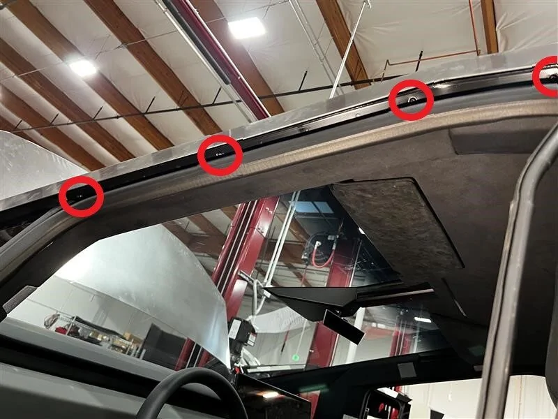

They could run some kind of attachment under the cantrail. I seriously doubt they would go the first attachment, it’s to far back, and if it’s mandatory, and people have stuff installed there, they wouldn’t be able to use it.
Mine has been installed since Oct 24, no issues. Not going to replace it until the offer me money like they did with the cantrails.
Not much there though...
Unless they make a combo cantrail hold down bracket...
