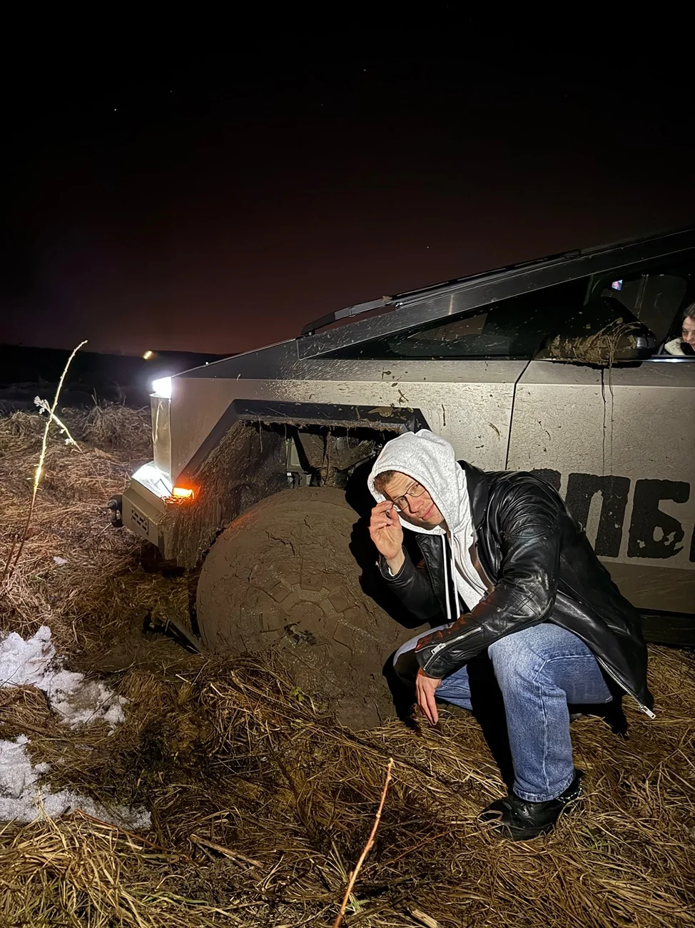

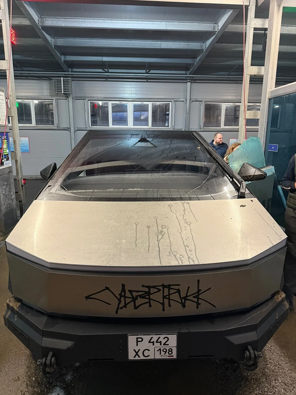

Many of you who travel in the northern regions know that the side cameras get dirty. I decided to solve this problem in a simple way, by adding a "cap" for the camera.
I had to retype the part several times in order to get the right shape.
Tesla Cybertruck Side camera cover installed on fender (to protect against elements / snow / ice) IMG_8734
The result was not bad, this element really helps. I haven't been able to take a photo of a dirty car since it happened once, the weather has improved and the cameras aren't getting dirty yet.
On the Internet, I saw a video of people installing a side camera washer. I didn't like this solution, as in winter, wet snow will form in the lower part of the car.
