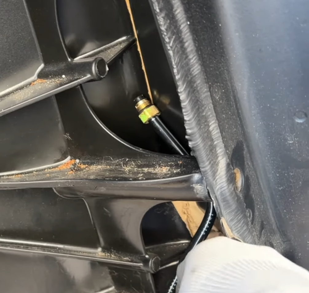

What do we need to fit 37X13.5 R20 tires?
Will your 2" spacers survive launches and offroad use?
37" is not a great fit, honestly. Would require trimming wheel well liners and bumper brackets. And/or limiting your max turn range. Check my video here
Spacers - have never had an issue, throw whatever you like at them!
MCraft99
Feb 20, 2026
237
224
FS CB 8/24
Thanks for the reply. I have no problem heat gunning the wheel well and rerouting the air hose behind the casting as well as cutting the wrench flats on the UCA. I have the cybertruckco lift rods that add 1" in low and 2" in high. I will be ordering your CTX front bumper and winch. I made a thread a lil while ago looking into fitting 37" BFG HD-Terrains. I think with spacers, the rear of the wheel well will be the hard to address since the aluminum casting is right there. https://www.cybertruckownersclub.com/forum/threads/how-to-fit-37s.55612/
