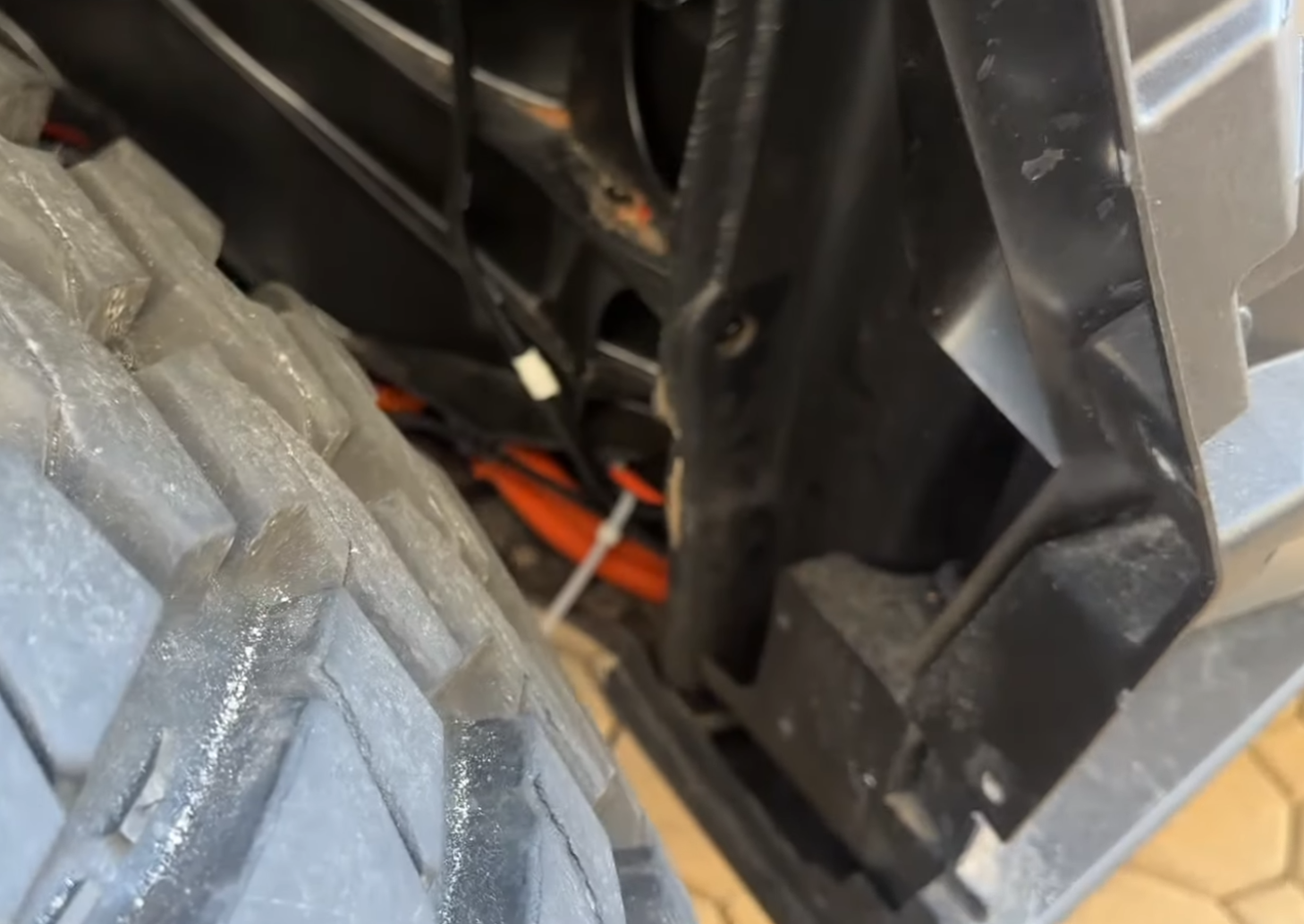

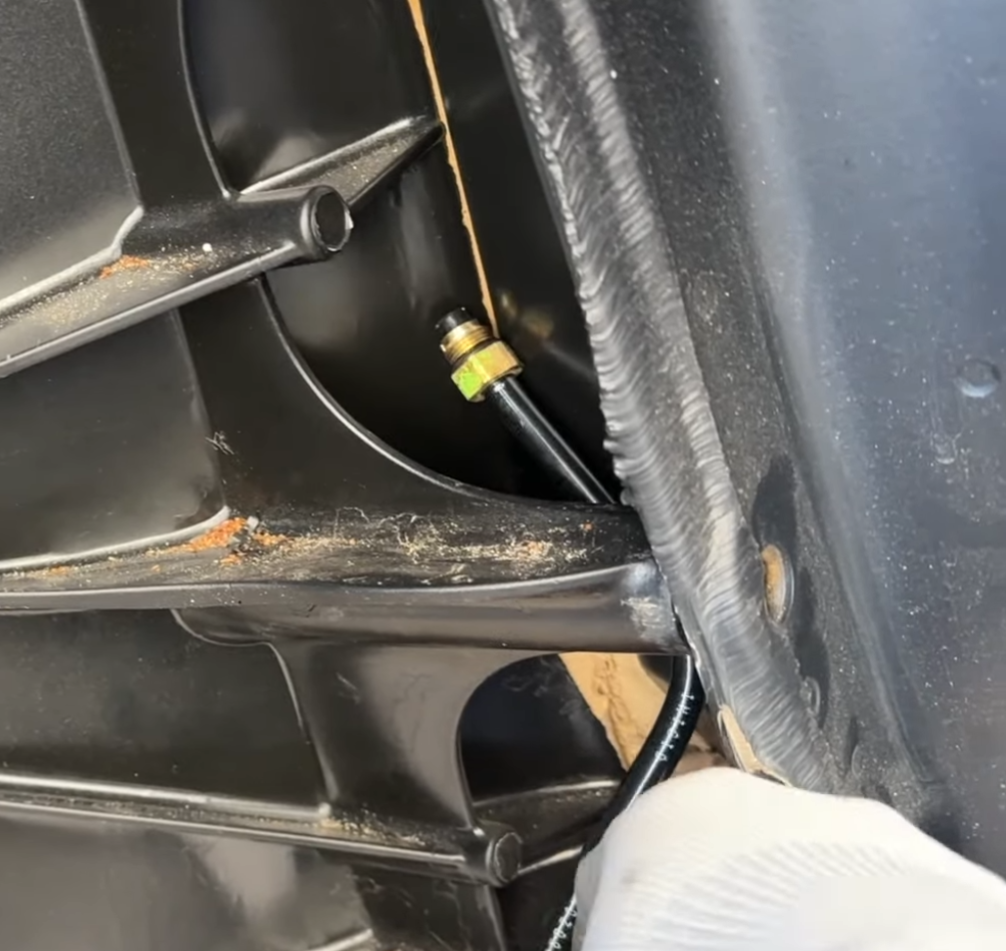

I've read a few threads about people with 37s. I'm looking into how to get 37x13.5r(18 or 20) BFG HD-Terrains. to fit on mine. I have no problem trimming the front bumper and using the heat gun on the wheel wells. I'm willing to re-route the airlines like SonsofAnxieety did. Apparently BFG tends to run 1/4-1/2" smaller than their advertised size.

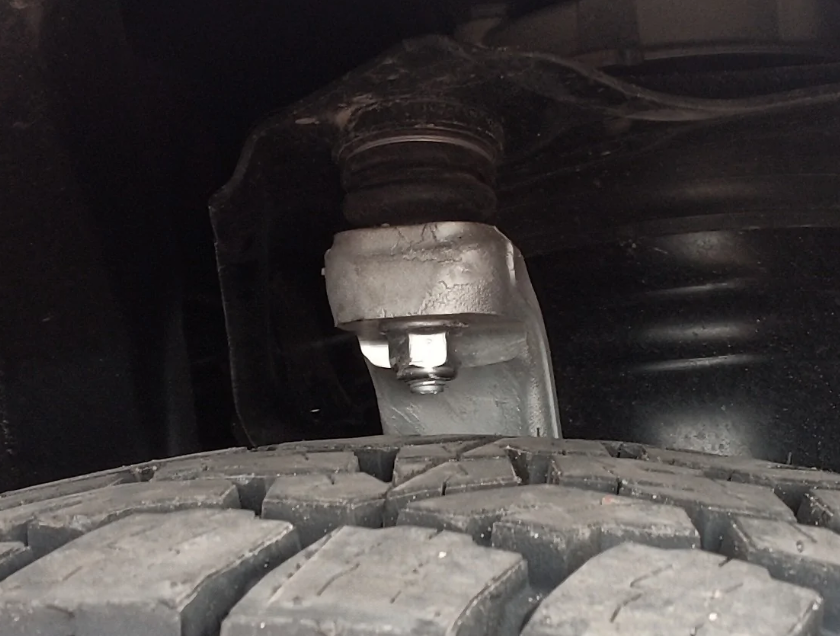

- I have no issue cutting the wrench flats on the UCA if needed.

I've been looking into it too, but on the fence whether the juice is worth the squeeze. There is one off-road tire that comes in 37x11.50R20 (Nitto Ridge Grappler), for a narrower tire so you don't have to use wheel spacers. I think it would be close with the suspension uprights. Another consideration is cutting off the hex heads on the upper ball joints; meaning if you need suspension removal or new ball joints you have to cut off the old one instead of unbolting.
If you want a super wide tire like 13.5, don't think you are going to accomplish that without huge wheel offset changes or spacers. I'm not a big fan of wheels sticking outside the wheel wells far, hence I'd rather get a narrower tire like 11.5's.

SonsofAnxiety messaged me back saying he's still rocking his 37x12.5r18x9.5+10 Nitto MTs with minor rubbing at full lock.
Method had some -40mm offset wheels but this may rub too much?
Tsportline and Unplugged sell overpriced fender flares that would make them not stick out as much.
I prefer wider tires due to having more grip but if I have to use 12.5" due to 13.5" requiring spacers, I'm fine with that.
