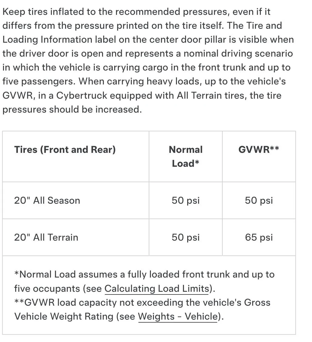

I think I have figured it out
I am almost always carrying about 800 lbs in the back
I think I will have it aligned with the full load next time
Good thinking.
If you have all terrain tires, the manual calls out putting them at 65 psi when at GVWR. Note the manual situation calls out a more even front/rear weight distribution than load in the back only. 800 pounds in the rear would be maybe 55-60 psi based on axle loads.
https://www.tesla.com/ownersmanual/cybertruck/en_us/GUID-B3DD905E-4642-4B5C-9149-480CA2C4F177.html
