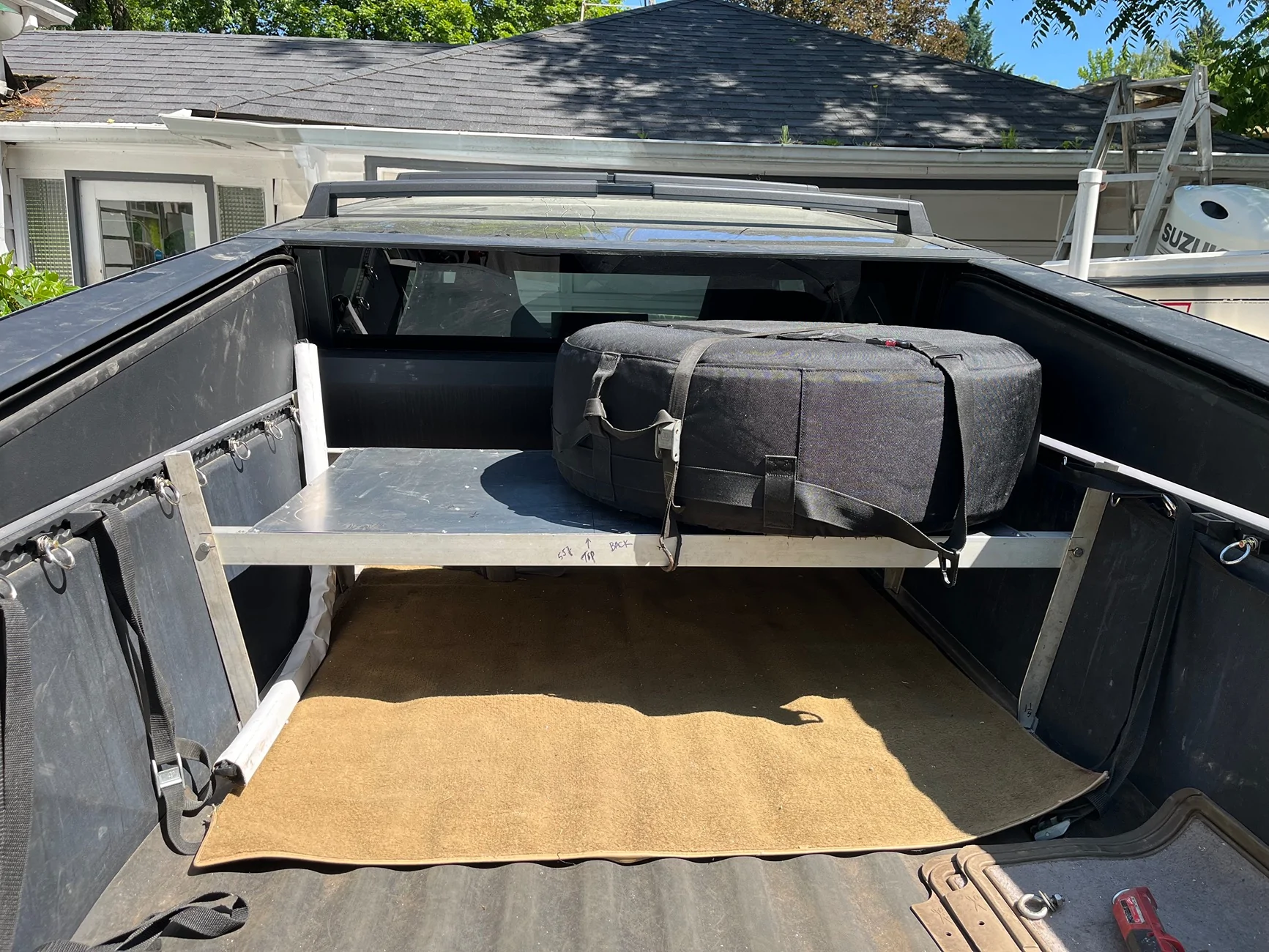

I'm in the camp of "over time, that's going to pull in the bed sides a little and that tonneau isn't going to like that much" camp. As a first stab at a viable solution, it's brilliant. I think the ultimate solution is 2 or 3 offset brackets attached to the tracks on each side and something solid going from side to side.
On the "Hey, this is a cheap fix" crowd, a piece of chain through a pipe that spans the bed. The chain has carabiners attaching it to O-ring T-Rail tiedown things. The length of the chain would determine the drop. And you could easily make something that goes through the tire (like on a conventional truck underneath) to hold the tire to the pipes.
This would change the force from mostly pulling the sides towards each other to pulling directly down on the L-Track.
Just idle thoughts. I do applaud your solution even though I would be uncomfortable with it.

I love it. How ? What ? Etc?
I bought 4L track stud fittings from Amazon. I bolted four pieces of aluminum angle to the L track. creating the four legs. I then bolted two pieces of aluminum angle to the four legs as cross members to support the tire platform. The tire platform was made with sheet aluminum riveted to some additional cross members between the two width way pieces to create a frame. At the bottom of the four legs, I riveted some thin aluminum angle up to the front of the bed of the truck to keep the legs vertical and spread the point load of the legs The whole assembly weighs only about 20 pounds and will support 300 pounds easily. This gives 12” of clearance and allows for full 4 x 8 sheets of plywood to be slid into bed.
I’m inspired, got my mind thinking the possible
Nice work
