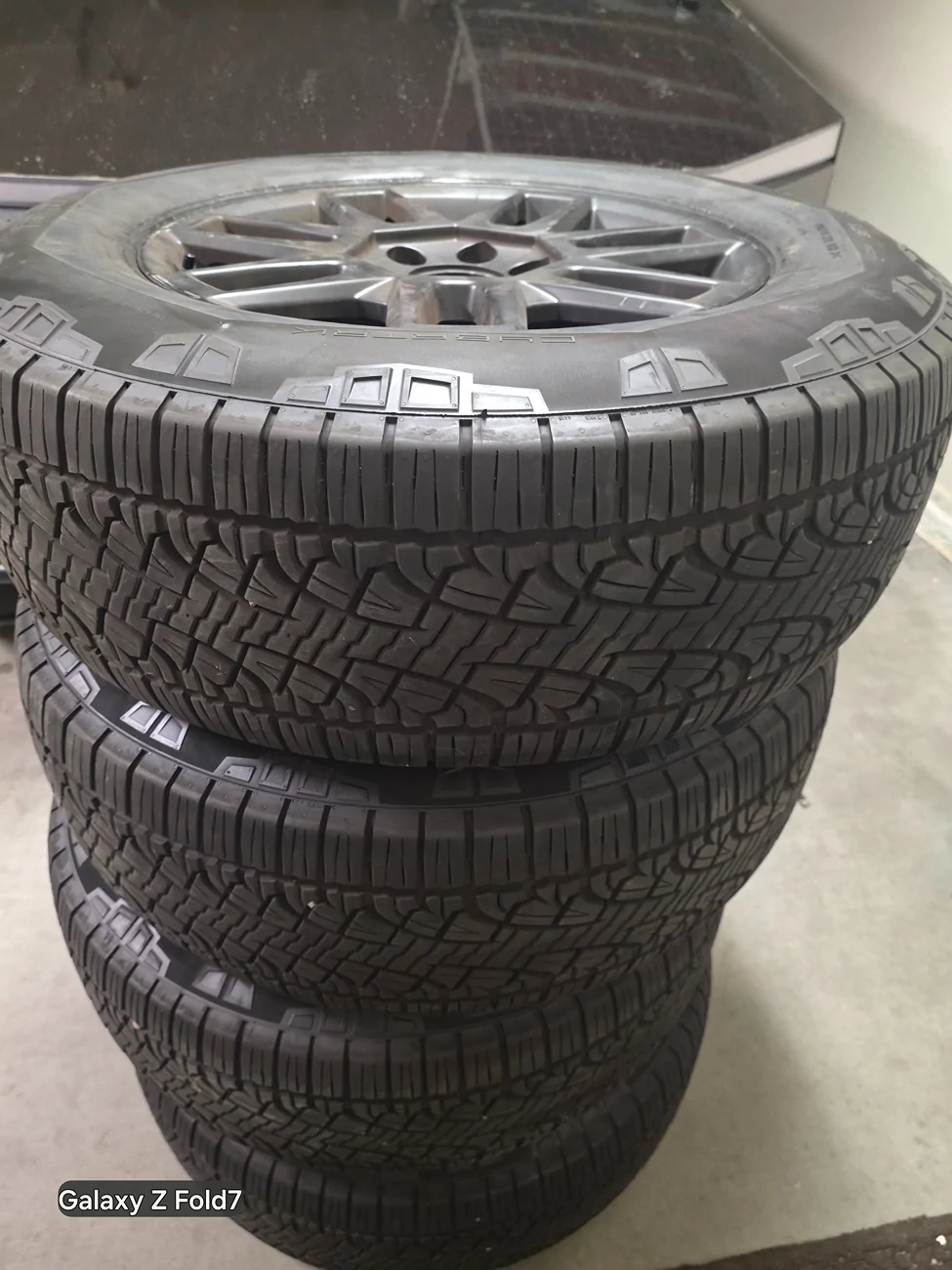

Arizona Peeps.... I have Spare-Tires/Wheels available for Emergency Spare. Message me if you're interested...
When out romp'n in the desert or trails in Sedona or traveling across the country it's nice to have that spare....when you need it.....

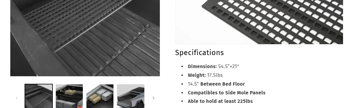

I take it doesn’t fit on top of one of those bed divider platforms? Needs to be lower to clear tonneau?
Could probably build a little set of l track mounts that suspend said platform a little lower.
I absolutely love it. Creative AF and incredibly logical.
Correct! The shelves are too high for the vault to close. Plus, the shelf is just one more thing to have to take out when in need of the full bed.

honoring the OP for his brilliant solution $63, this solution is $320 at best
they dont show the tire on top, probably at L track level, too high
back to the OP solution
but think we found the ltracks are strong enough
Thanks, @kpanda17 - exactly why I skipped the shelf option as vault wouldn’t close with tire on top. Would def do the shelf if someone creates adapter to lower it though!

think the OP has it right
$63 is nothing to try it out and the shelf shows us the L-Tracks can handle even 58 lb tire bouncing, hanging in the bed

But not if you lowered the shelf a little. You could put a couple custom shaped bins on either side of the tire that fit on the shelf to maximize storage, maybe a water tank on one side and recovery gear container type thing on the other or something.
