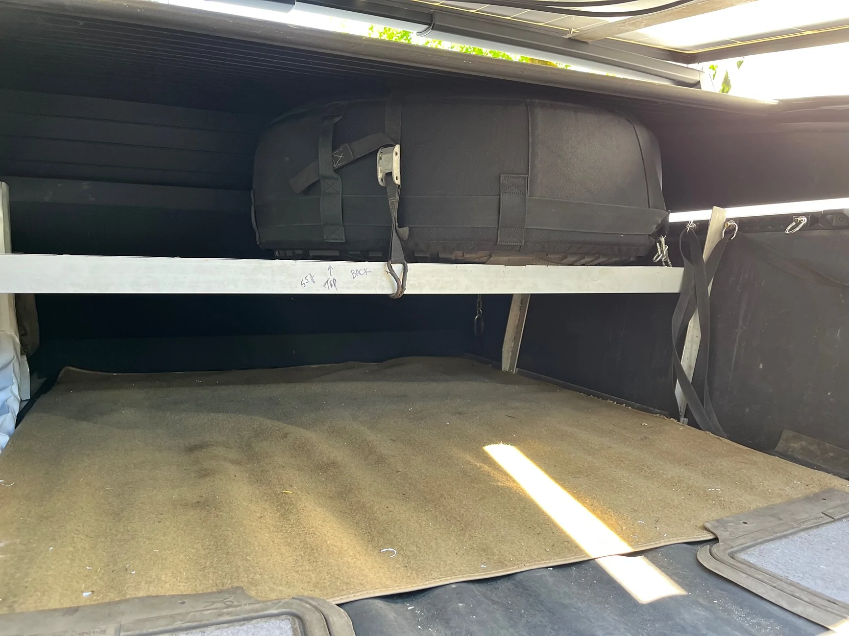

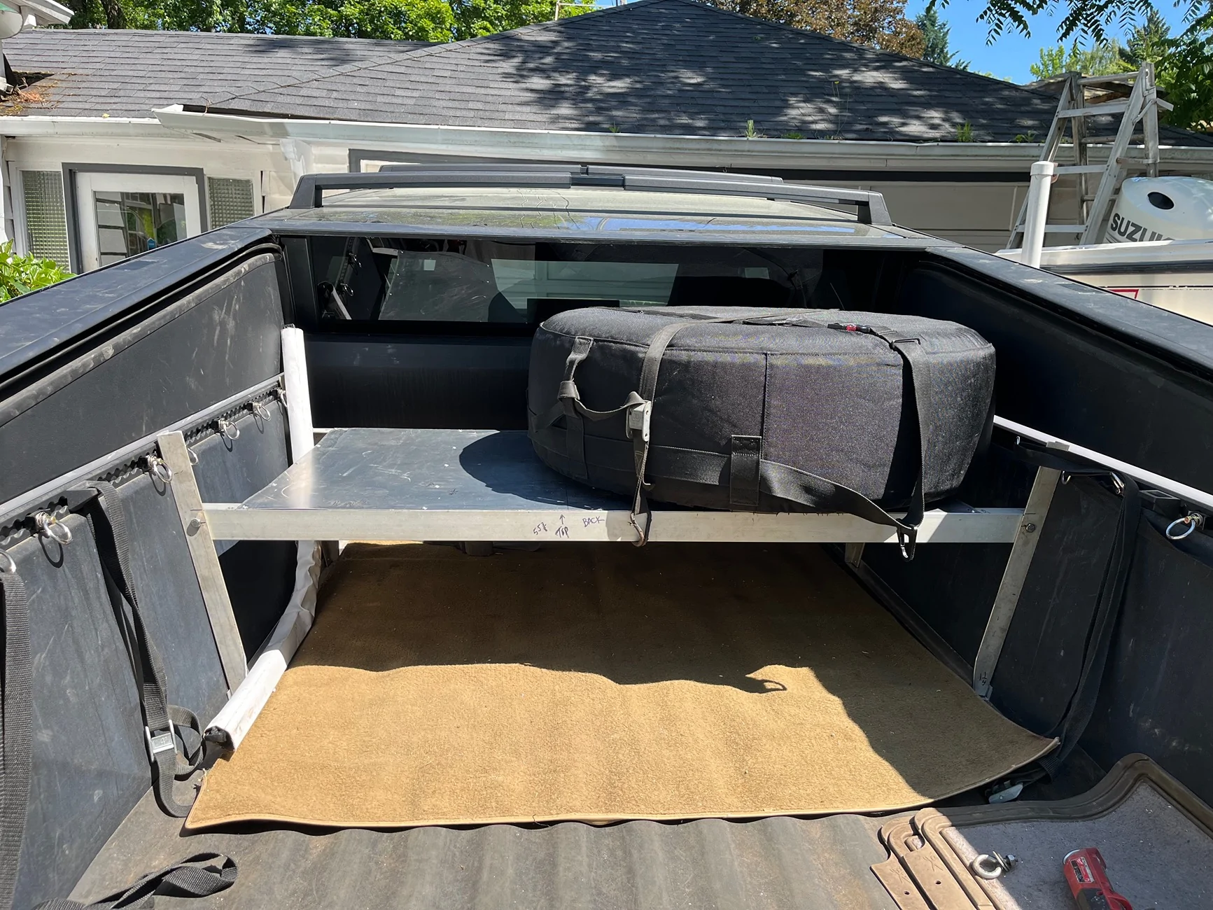

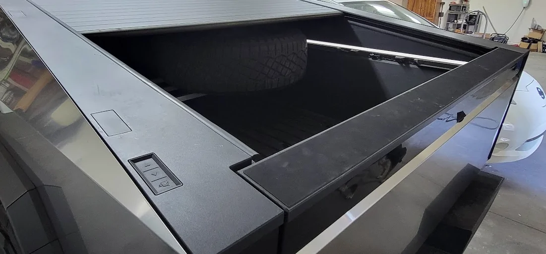

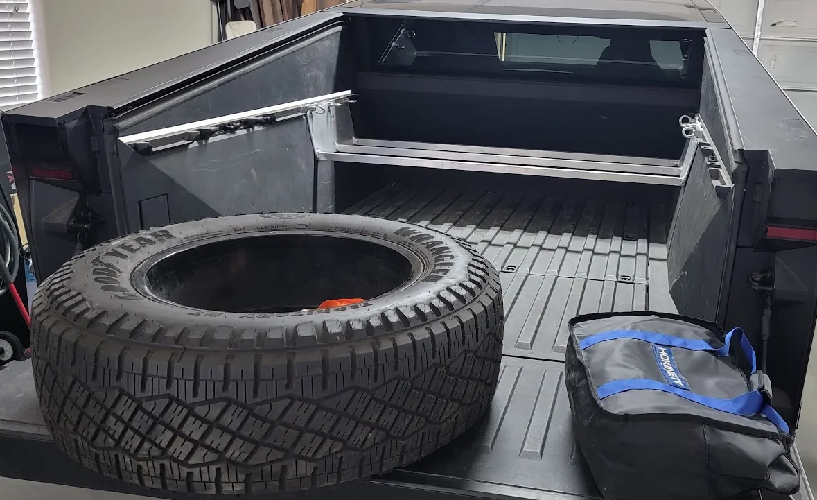

This is a project that has been on my list almost since day one. I finally found a free weekend to crank it out. I wanted a way to secure the tire in the bed while still leaving ample room underneath for 4x8 sheet stock, full sized cylinders, etc. First off, I will go ahead and say I know my welds suck. So all you accomplished welders may just want to avert your eyes :) . I just don't have steady enough hands anymore for aluminum.
I eventually will weld in a plate to attach a more standard tire wingnut mount.
Plenty of clearance.

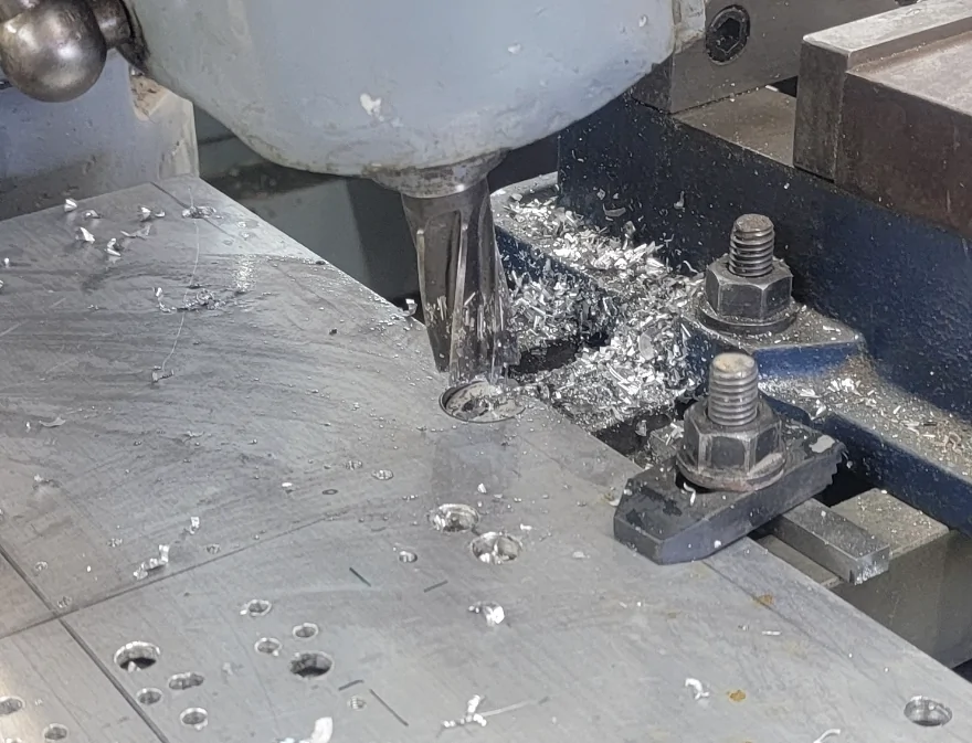

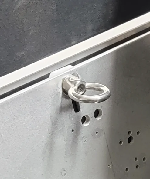

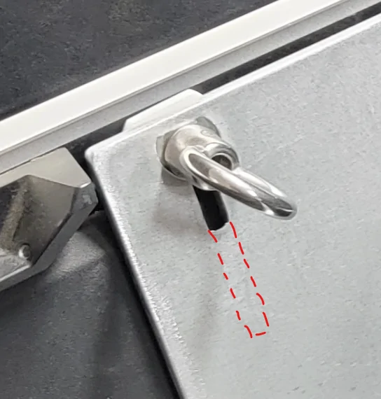

I used eye-nuts and slots in the plate for easy, tool-less, install and removal (as well as convenient connection points). The 1/4" plate was scrap from an old project (why it has TO-3 transistor holes in it).
Looks like you have some cybertent brackets on there. Is it installable with the tire holder in place? With or without the tire? Can it be opened?

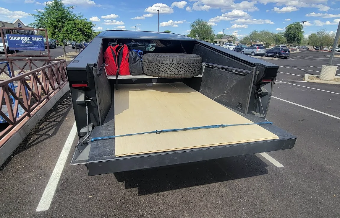

Yeah, that was a design constraint. I didn't want to have to remove the tent hardware so I made the shelf fit in the remaining space. Tire has to be removed to install the tent but the shelf can stay. However, I expect I will remove the shelf when the tent is in use so the tire can fit under it (unlikely to need the tire so don't want it taking up valuable easy access space when camping).

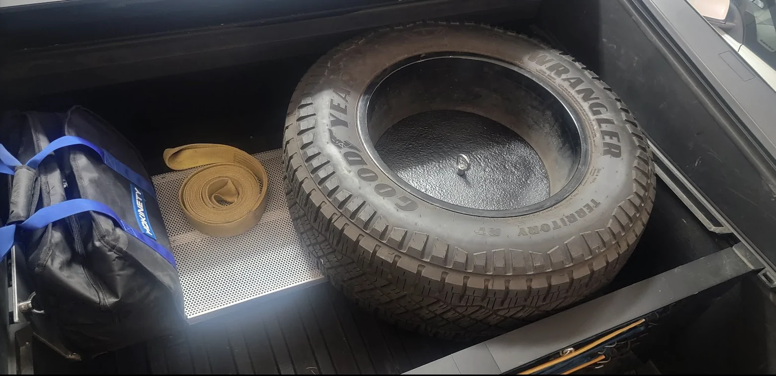

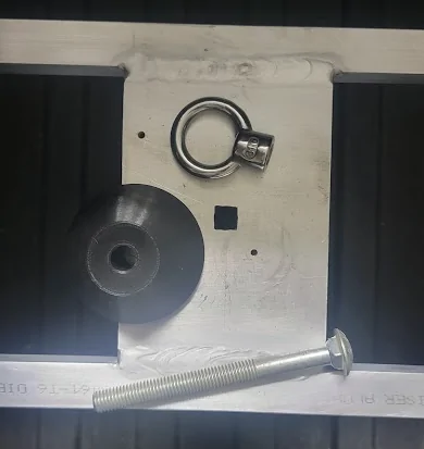

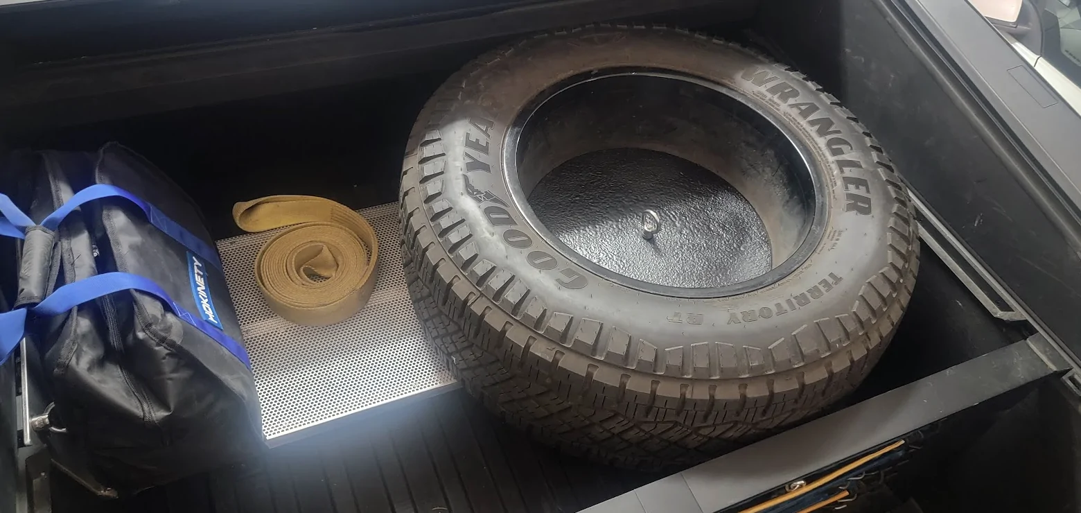

OK. I think I am finally finished. Welded in a plate so I could secure the tire with a carriage bolt. 3/4" plywood insert (with rubberized coating) to hold it in place and also allow me to store stuff inside the wheel w/o it falling through.
Tesla Cybertruck Custom Spare Tire Rack 1773520958969-on
Tesla Cybertruck Custom Spare Tire Rack 1773520994039-6z
The 3d printed cone is just to keep the bolt from falling out when removing the tire.
