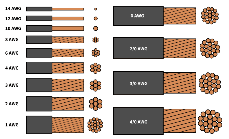

A 5-15 outlet is probably fed with 14 AWG wire. For a 30 amp breaker you need at least 10 AWG. Look at the wire size difference. WAY too big a risk for fire if you did this.
