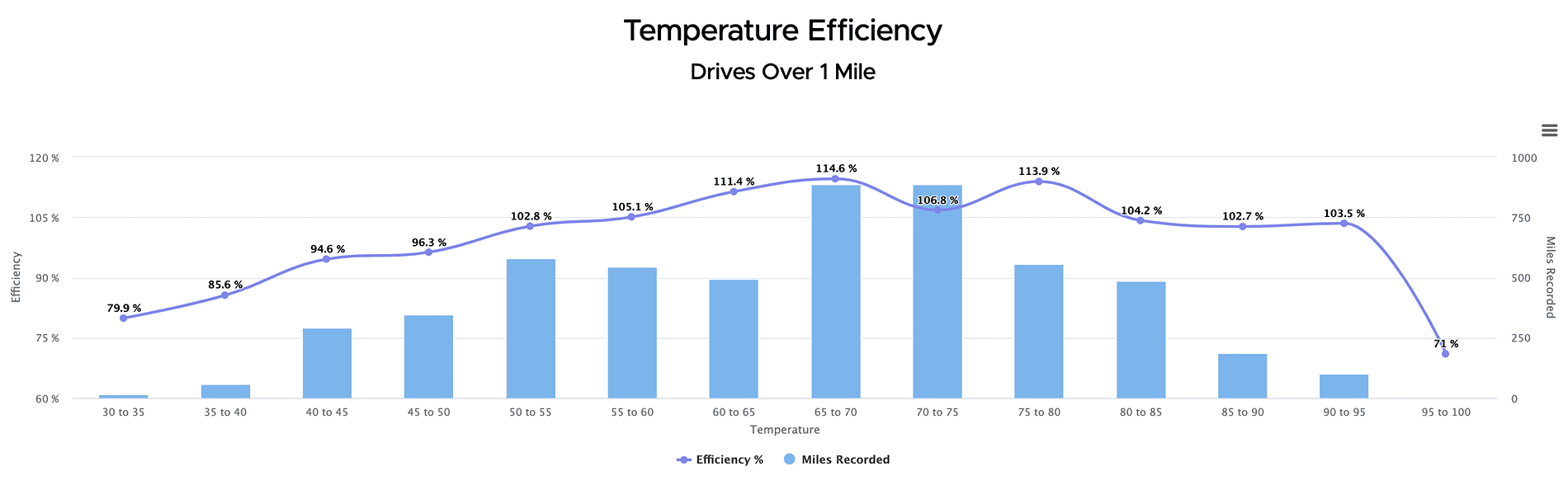

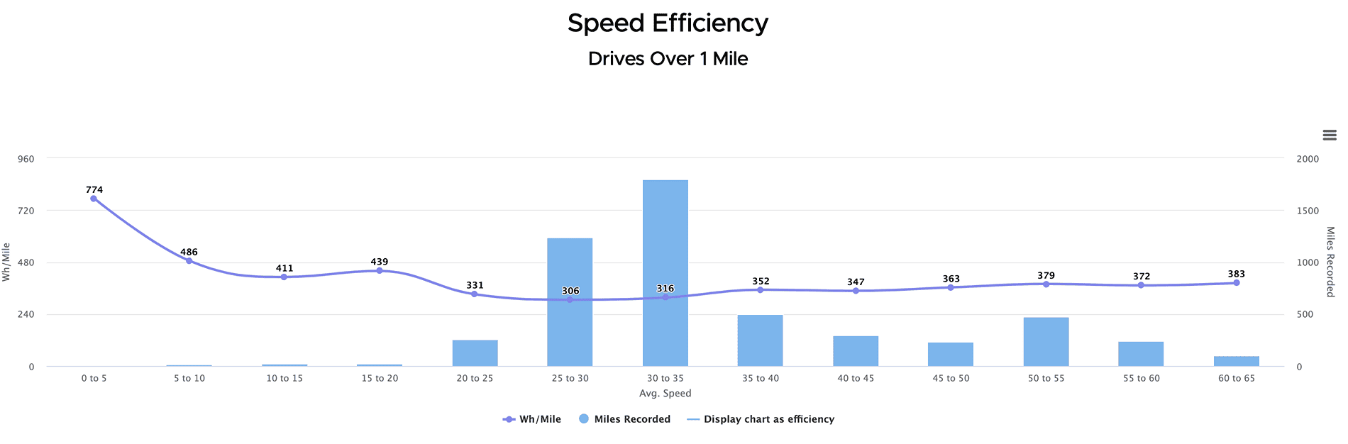

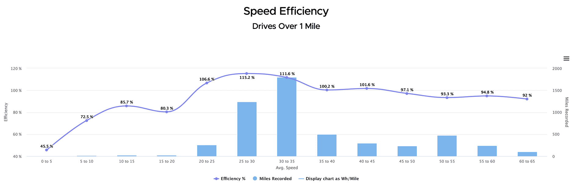

To add to the data points, here are the first 6000k miles on my AWD CT on stock all terrain tires. It tells the story a bit better to split wh/mi by speed and temperature. I'll have some great data after this first winter here in NH, and maybe I switch to the all season tires and get another year's worth of data on those.
