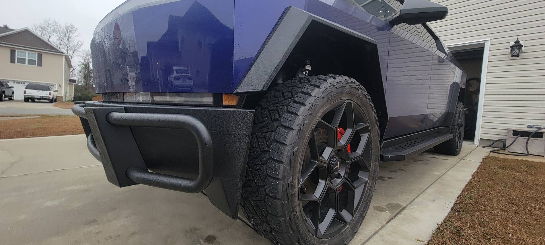

Is there anyone here that knows if theres a setting to have Cybertruck to ignore over pressure warnings when using all terrain tires. I ask because I installed all terrain tires that have a max pressure rating of 80psi. I ran them at 55 psi until it was time to rotate them.(7500 miles). While rotating I noticed that they were wearing a little unevenly on the inner and outer edges of all the tires. I increased the pressure to 65psi to see if this would reduce the wear. Unfortunately I now get the warning of over-pressure in the tires. In the manual it states that AT tires can run at 65psi on the Cybertruck but doesn't show how to set the truck up to adjust to this setting and not get the warning. Has anyone else ran across this and know if theres a way to prevent the warning?

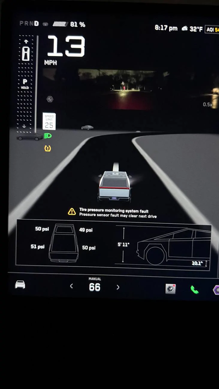

Got a picture of what the over-pressure warning looks like? I get an error running mine at 55PSI, but not sure it's an over-pressure warning....more of a TPMS warning.

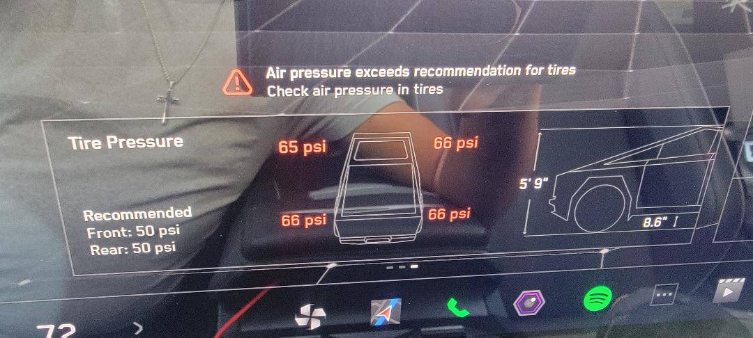

Yes. Here's a picture of the warning I have. The one posted above looks like a fault with a TPMS sensor.
