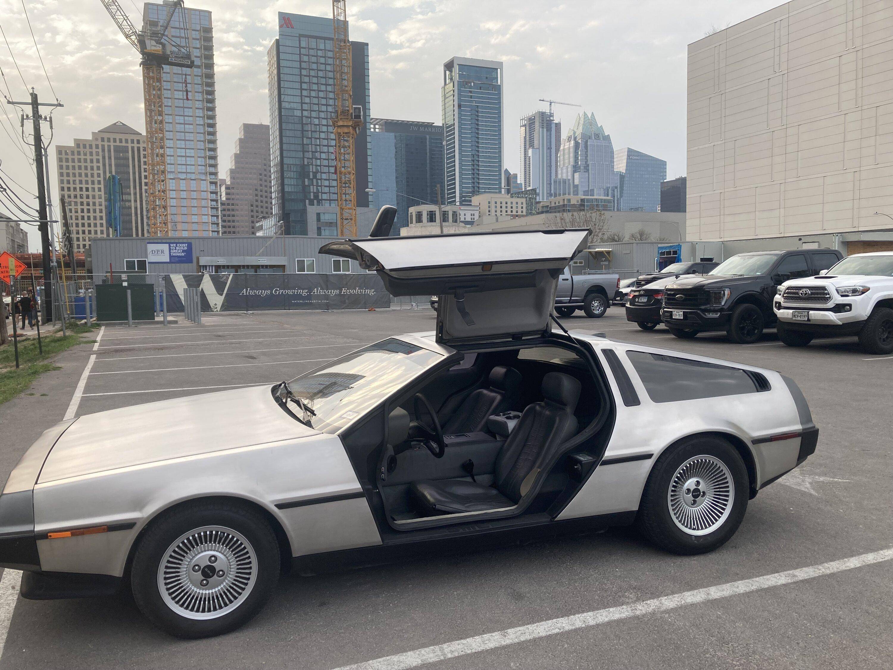

Tesla Cybertruck Any way to remove these imperfections? img_1713-jpe
This is what your Cybertruck will look like in 40 years, only bigger and without the funny doors
