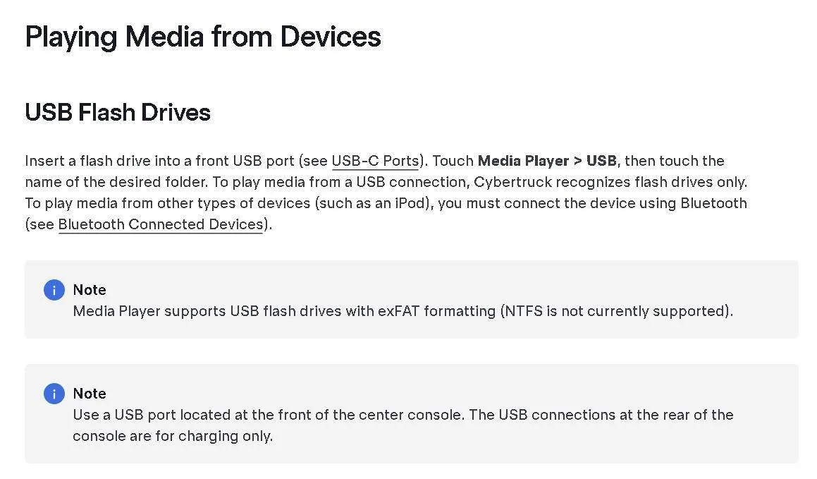

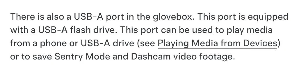

There is a very old thread on this establishing that only the glovebox USBA port allows data, and how to deal with that. My guess is that the USBC ports are hardware capable of it, but Tesla has probably blocked them out of security concerns. If that's true the situation may change in the future.
(87) USB Music Playback | Page 3 | Tesla Cybertruck Forum - Cybertruck Owners Club
After looking through the schematics, I see no data connection for the console USB ports. Rears definitely don't have 3.0 data lines. Front USB-C might just be unlisted like the glove box one, but I'm thinking the MCU only has one port.

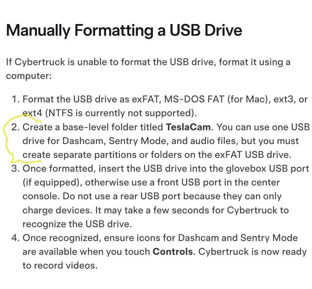

Simpler chips with only one port, less to go wrong. Zero reason to have back seat USB-C doing anything but charging (security risk with something the driver can't see happening, given that USB can be abused to give hacker level access), and the front console USB-C port being anything other than power could cause confusion, since while a USB-C connector can support USB 2.0 without supporting USB 3.x, it usually supports the latter (and not all devices with USB-C connectors necessarily support USB 2.0). It's clearly stated that whatever hooks to the glovebox port must be USB 2.0 compatible - which isn't necessarily a performance problem even using both camera recording and audio playback at the same time. And from what I've seen on other OS's, even if the controller is one chip, if it supports both USB 2.0 and USB 3.x, it looks like two controllers to the OS.
What combination of those, or were they just cheap? Doubtless cheap figured in, but probably not just by itself, since the difference in cost for wires and chips isn't necessarily that much.
It is what it is. You can do everything with the one data port. Whether that's what you WANT or not, world's littlest violin playing a sad song just for you.
Tesla should fix the manual. They should also document the best way to partition and lay out everything for a single drive in the glovebox to do it all. But if you're a technophobe, what the heck are you doing driving a Tesla anyway? :)

No, you can't do everything easily with one port. It is a major pain plugging and unplugging drives in the glovebox for different purposes. If you want to change any data on that single drive you have take it out of truck and then it's not available for its other purposes. While you are messing with for one use, many just frivolous, you risk trashing it for everything.
It is very inconvenient to access. You can't see what you are plugging into back there. You certainly can't do it while driving even if you are able to contort to reach it from the driver's seat. This is the first Tesla ever to have just one USB data port, and to not have it on the console.
