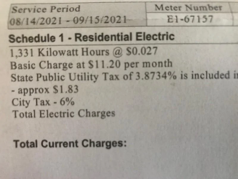

Tesla Cybertruck Anyone considering getting Solar with the new Green Act 51580339167_dc43d9d1e9_c
I'd still like solar too
YeahYeahYeah
Jan 6, 2020
41
57
Washington State
2017 Tundra(sold),02 Subaru Outback,1967 Fastback
Electrician
kW envy… no wonder WPPS defaulted!
Lol, I think were the cheapest in the nation, we have a big hydroelectric dam on each end of town
