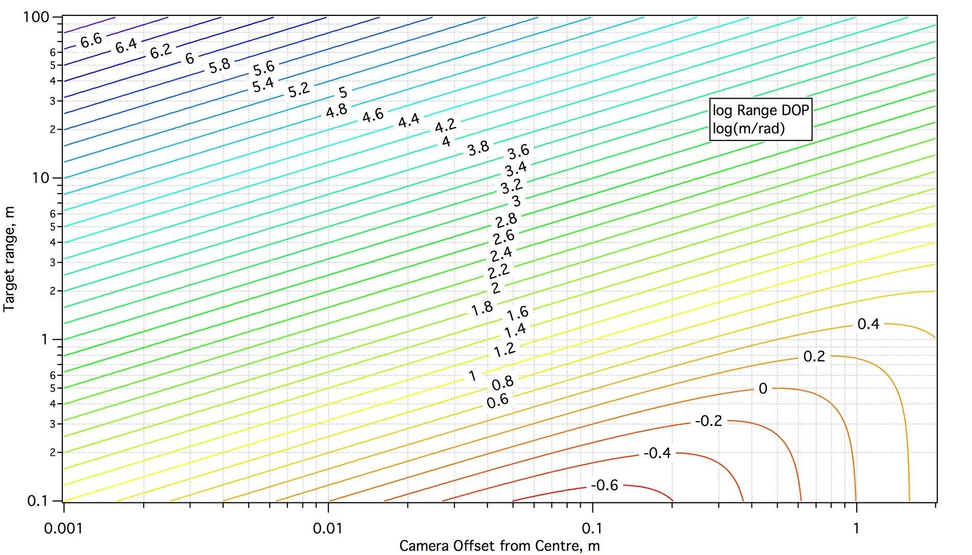

No it doesn't because the graph (which I put back in - don't know what happened to it) quantifies DOP. I kept harping on DOP because it is a central concept in estimation but as you don't respond to anything said about it I conclude that it is completely foreign to you and therefore we cannot really have a meaningful discussion of range estimation using the usual language. So let me try another tack.
Suppose you are off the coast and, come out of a fog and see the light from a lighthouse on shore. Can you tell how far you are away from it by taking a picture of it? Can the camera measure the range to the light? No. It cannot. But supposing it is daytime. The camera still can't measure the distance to the light but it can measure the angle between the base and the top and from that the range can be calculated if the height of the light house is known. I was taught this in high school. I think it should be intuitively obvious that if the light house is very far away or short or both that you will have to take very accurate angle measurements to get a good estimate of the range. Mathematically the error in range per radian of angular measurement error is the sum of the squares of the range and light house height divided by the height of the light house. Supposing the light house to be 30m high and 10 km away each second of angle measurement error would correspond to bout a km of range error. Now obviously a camera with a long focal length lens can measure angle better than one with a shorter focal length lens so if you must estimate range from a single measurement then you should use a long focal length lens.
But suppose you are part of a fishing fleet and there is another boat 2 km up the coast from you. He doesn't measure the angular height of the lighthouse nor do you. You each measure the bearing to the lighthouse and use the angular difference to estimate the range. The geometry for this pair of measurements is now such that that each minute of measurement error results in 21.4m range error. Thus the cameras making the measurement don't need to have long focal length. They can have 20 times worse angular resolution and still give an answer twice as good as the single measurement.
Thus a systems engineer looking at the problem of measuring range with cameras on a vehicle would say "Ah, use the hi res camera to identify the point you want to range but use the widely separated cameras to get the more accurate estimate and, BTW, let's get them as far apart as possible.

No, it is definitely not until you learn some of the basics of estimation theory. There are many textbooks. I think you have thoroughly demonstrated your lack of qualification to judge which points are relevant or irrelevant. What really amazes me about these forums is that people who don't have any relevant education or experience in these matters have the temerity to tell me I'm wrong about stuff I worked on for years. If I didn't know what I was talking about don't you think they would have fired me? There are other people here that do have the relevant experience and education to benefit from what I post. I will continue to post for them.

I understand the geometry constraints on range estimation accuracy just fine. It's actually much more involved than you have discussed. And without having a better grasp of the fundamental images these formulas are being applied to, you will never have a good idea of how much range accuracy is possible. There is the complicating factor of how much range accuracy is necessary to safely navigate various environments. But even more important, the geometrical constraints can only be applied to one estimation method at a time. Tesla uses AI which combines multiple ways to understand potential dangers in a synergistic manner. AI is far more powerful in it's ability to extract useful information from moving images. It mimics the way human vision works to understand a scene. Please note I am not claiming it changes the laws of physics. Even human perception is subject to the same laws of physics that govern the performance limits of AI vision.
No doubt! I'm pretty sure I know what they are doing but I'd like to confirm that. But we aren't actually arguing about the AI part of the system. I am trying to get you to understand that there are certain laws of physics and mathematics that you can't get around no matter how much you would like to think you can. You can't go faster than the speed of light and you can't measure the range and velocity to a point target based on measurements made in a plane orthogonal to the range vector.
I didn't want to get into this but it's pretty obvious your understanding of how threats are detected is grossly inadequate to understand what is going on behind the AI curtain. First of all, the system is not measuring range and velocity to a point target orthagonal to the range vector. Because it's not a point target. Images identified as cars are always composed of many pixels. This is where the nature of the images formed by the lenses comes into play. I'm not fully versed in ALL the specific techniques used by Tesla to estimate range to another vehicle and no one is, not even the Tesla Vision team because AI figures it out through trial and error and example. Even the AI system is unaware of the theoretical limits that singular range estimation methods are subject to. But that doesn't mean it has to violate those limits to perform better than any system could by using only one range estimation method. Tesla Vision is primarily an AI based system that is designed to use multiple visual cues to mimic a humans ability to drive a car.
It appears you believe all these range estimates are done in the classical sense (of using math and numbers). While doing it this way can illuminate what the theoretical limits are in detecting range using any one method alone, it's apparent to me that Tesla is using AI to bypass the actual calculations, at least in the case of distant problem detection. Yes, they cannot use AI to detect problems that are so distant they fall outside of the theoretical maximums but the theoretical maximums expand greatly when multiple visual techniques are combined to estimate distance. This is what the AI is doing (without actually knowing how it's doing it). In order to calculate the theoretical maximums it would be necessary to understand all the methods that can be combined and interwoven over multiple frames to strengthen confidence levels. And how the different methods increase accuracy when used this way.
In the end, Team Tesla does not even know what the theoretical maximum is, they have to be content with measuring the systems real world performance. This is the nature of AI. It doesn't violate physics but it can use physics in ways that are not well understood or documented. Yet, you keep coming at this from a viewpoint that is essentially arrogant (for lack of a better word), thinking you need to understand every principle that Ai is leveraging to achieve it's level of threat detection. That's a game you are not going to win.
Again, I'm not saying it violates physics but AI can exploit principles that have not even been conceived of. Because there are multiple ways to calculate range from moving images of road scenes. The theoretical maximums you have brandished are relative only to one method. Humans don't drive using one method either, they drive using the same techniques used by AI, combining all kinds of visual cues with what we know about road environments to make sense of the environment and (hopefully) safely navigate through it. We don't calculate distances and theoretical limits as we drive along, we do it naturally, just as an AI system does. I feel like you don't understand AI at all but are trying to make the system fit your mechanistic view of how you think the system has to work. Remember, humans are subject to the same theoretical limits you keep harping on.
Dillution of Precision is a real concept that has real implications in Tesla Vision. But you cannot calculate the limits of the entire system by applying the limits of a singular method to a system that combines multiple methods to increase capabilities above and beyond what one range estimation method can achieve.

You continually claim that I don't understand the theories you have posted (presumably because I say they they are mostly not relevant to the points under discussion). But I understand them just fine. The reason I hadn't addressed them is because using them accurately depends upon the accuracy of the input data, which you still misunderstand. In one case, the differences between the images formed by a wide angle and a telephoto lens. And you have evaded adressing my contention that the projected image cropped from a wide angle lens is to equal the perspective of a telephoto lens has the same perspective as the image formed by the telephoto lens. It's just a lot smaller and thus covers fewer pixels. This is an optical fact that you are blissfully unaware of and is central to the issue at hand.
You still misunderstand the nature of the input images due to your misunderstanding of the differences of images projected by lenses of different focal lengths. This is fundemental. In other words, garbage in, garbage out.
The other reason estimation theory is not relevant to the points under discussion is none of the points I've raised have contradicted estimation theory. Because without knowing the focal length of the lenses and the size of the pixels (and other less important factors) we cannot calculate the theoretical limits of accuracy of the distance estimation. But this all becomes moot when it is realized AI uses many different methods to determine range and it doesn't even quantify that as a number most of the time, it just reacts appropriately. It doesn't spit out a number in feet or meters. The element of time also plays into this. In other words, how the theoretical limits of accuracy chage as more frames, more subject motion are added into the equations. Because a system like this does not have one theoretical accuracy, it becomes more accurate as each successive frame is processed (and also as distances become smaller) and the theoretical accuracy changes rapidly from moment to moment.
Yes, you can, using the type of video Tesla uses, find exactly the location of a single point of light.
First, it has parallax between the different cameras - three forward ones in this case - to determine the light's position in space. (This is how we use still images to know where stars are.)
Second, it detects edges in the image, so it knows how many pixels any light it sees takes up. Then it compares this to a previous image. This also tells it positional information, as things changing size are usually also moving towards or away from you.
