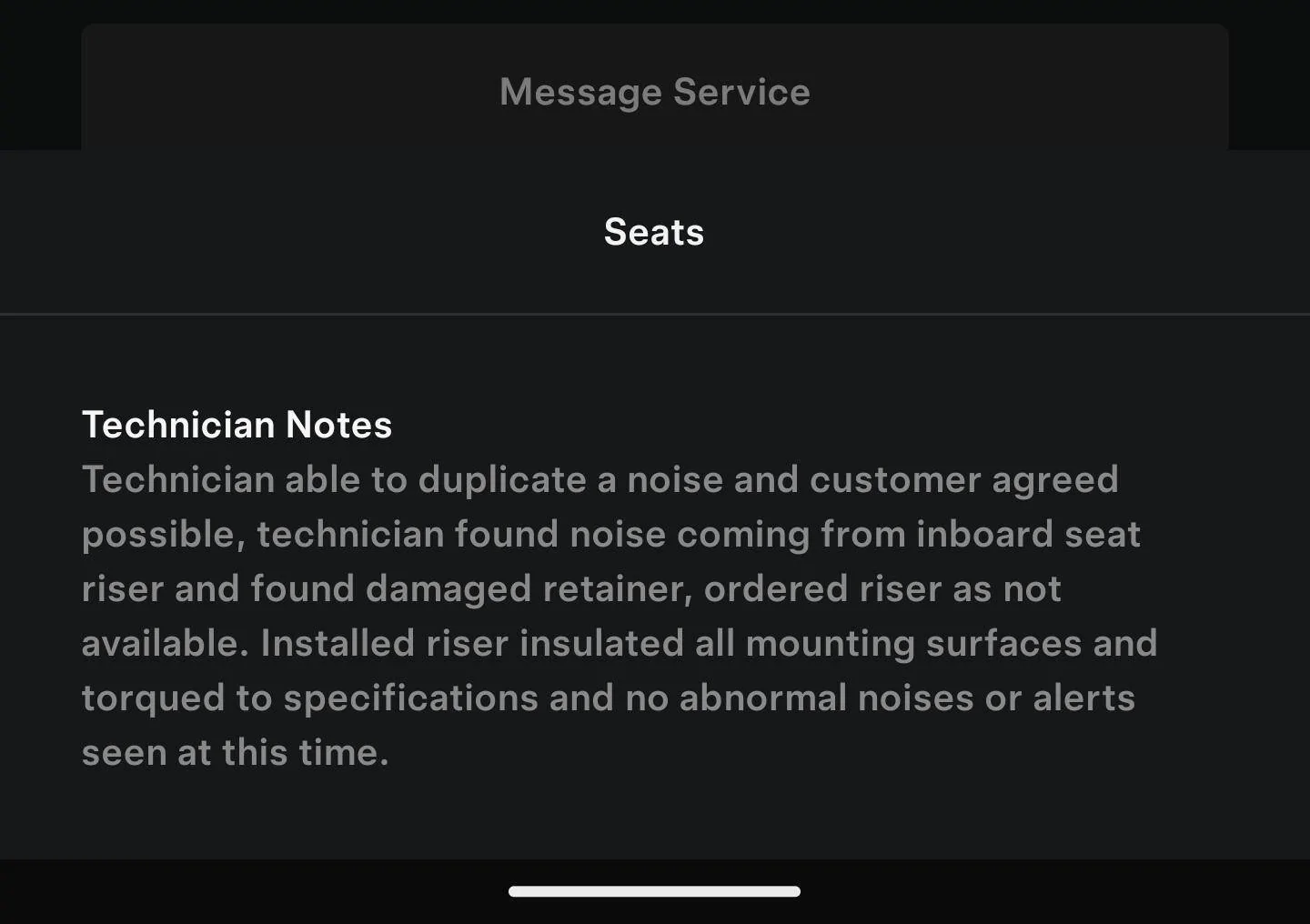

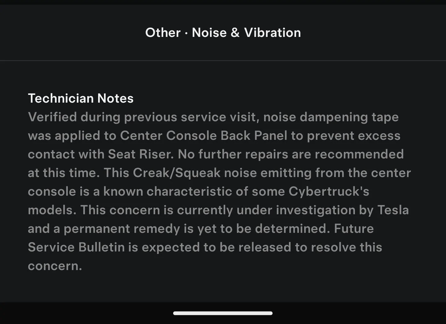

I have the annoying creak in the center console and Tesla can't fix it. This is my 7th Visit since March to get this fixed. This is what Tesla updated me with today.
I requested a new center console, but they will not replace it. I guess I will have to try and fix it myself.
Thank you to the people who posted on how to fix it.

If you still have the annoying creak this is the fix!!
After about 7 months later, they were finally able to fix it! Show this to the service center if you plan on bringing the truck in. Tesla should post a bulletin for the service center techs. I hope this helps people out. I got this service done 3 weeks ago and wanted to wait to post, just incase the creak came back. All is well after 3 weeks, so it's safe to say it is definitely fixed!
