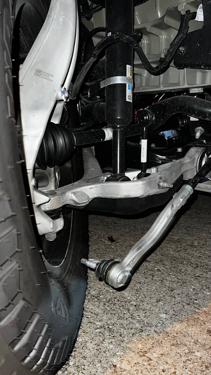

@kappaknight I recommend you go immediately to a service center and have them check the front knuckle assembly for a loose bolt. This happened to me and they never seen it prior. But everything’s new on CT. Took them a weeks to get parts and figure out if anything else was loose. Felt like what you describe but my wheel oscillated at ~40 mph. Very dangerous if it’s what happened to mine.
