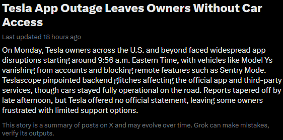

Mal
Mal
Feb 13, 2024
32
641
1,628
WA
Foundation CB "Rocinante"
Hmm, that's interesting. But it happened to me on Thursday last week (February 5th). And based on the service guys being completely stumped (both from the office in California and at the service center itself), I'm not so sure. You'd think they'd have been aware, especially after the previous outage?
The log out, log in, resolution is probably the clue... but I don't know how their system works to understand what it really means!
Ah, I didn't realize it happened to you last week. Maybe you were "patient 0", as they say. The thing I posted from X happened yesterday, I believe.

Your earlier comment about key and drive being different requests might be part of the answer. I had assumed that they were essentially one and the same and therefore, it would have required the auth system to have a problem between unlocking and starting...which was a very small window of time. Possible, but low probability.
But if they're separate, then it's possible that one system was down while the other was up. The probably of that is higher and more realistic.
