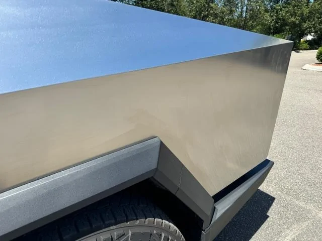

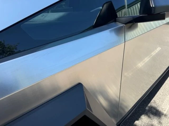

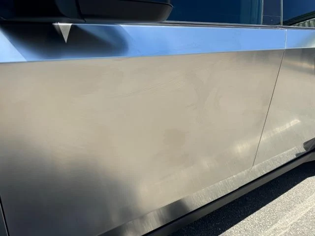

Barkeepers Friend Liquid & Windex Combo Issue - Now What?

I have the same problem here in Texas. What I found that works best is the follow the instructions on BKF bottle the instructions say to use a moist towel or damp towel to wash off the stainless within a minute after applying it. So I got a bucket of water with Dawn soap and a good car sponge and got a panel wet put a good amount of barkeepers friend on the sponge and washed that panel and then rinse it off with high-pressure hose and then after I was done with the car, I drove through a car wash and dried it off and it looks great.
The problem I have in Texas is too damn hot. The flashing happens so quick that all you get is streaks and splotches so you need to use the water method of applying it and wash it off.

I had that issue when I was prepping before putting on protecclear. I found that I had to go at those spots with the ammonia free Windex and fresh areas of my microfiber cloth. The slightest bit of dirt or oil on the cloth will just smear on the truck.
I had the same issue during prep and had to go back over those spots with the SprayAway ammonia free cleaner. Once i did that the panel color was nice and consistent. The ProtectaClear went on with out issue and the underlying color is good.

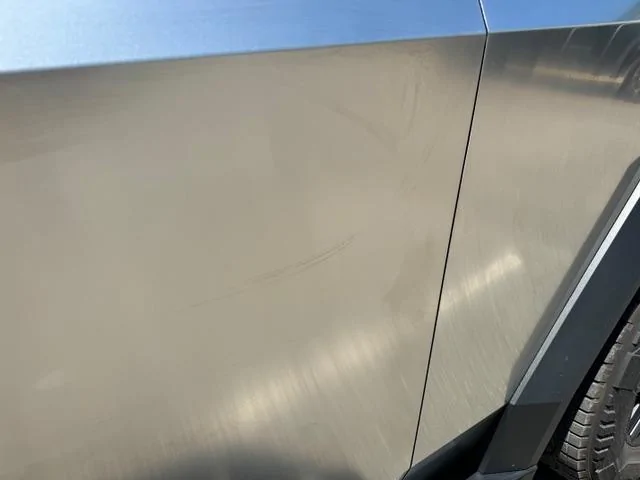

I tried barkeepers friend liquid, and I was getting streaks like that. Never going to use it again. So far spray away seems like the winner to me.
