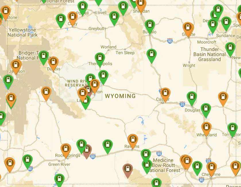

When you look at the map that @Jethro posted, charging options look slim. But let's look at Plugshare, slightly more options. @Jethro 's map had 12 Superchargers. This one has over 50 charging locations.
And I suspect that there are a number of camprgrounds that you could use as well.
