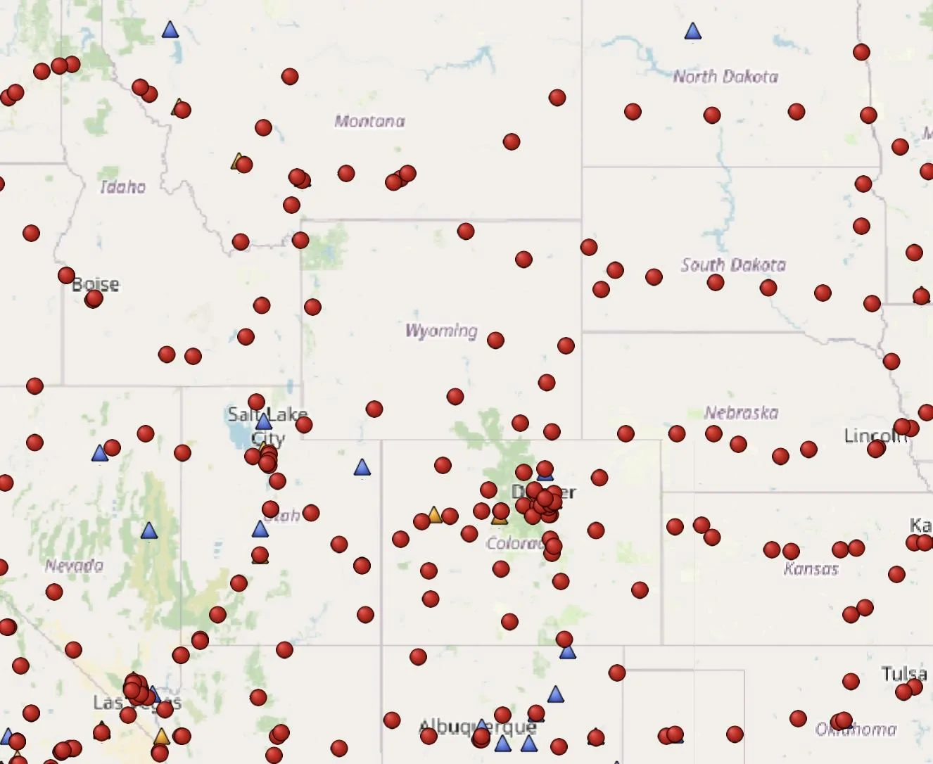

Yep, it might be sacrilege, but I need the range in my camping/off-road vehicle.
I can get the more range than the $16K Tesla “range extender” with a $600 genny and a few gallons AND it weighs 60lbs not 800lbs…much easier to grab when needed.
I’m in the Rocky Mtn. region and most Superchargers are only on the interstate…all the great camping and off-roading are in the outback. PLUS, data is not yet available for CT off-road milage. Steep rock crawling for a few miles has got to consumer lots of power, and minimal regen on the way down.
I can just run a genny overnight to charge up.…now to find the best one. Be great if it could be DC or use 220 for maximum efficiency.
Just look at the map of the Rocky region almost all of the Superchargers are on the Interstate::
Thoughts??
Well this is one way to bring attention to areas with sparse supercharger coverage. Nothing wrong with being practical. I've still been impressed with the growth of the Tesla supercharger network over the past four years. Maybe sometime in the next four years your frequently traveled areas will be more covered, or at least some more places with destination chargers.
I think you'd do well with a generator rated for 14kw in my opinion, since the Cybertruck onboard charger will draw 48 amps or about 11.5 kw max. I'd just be careful to note what the continuous load rating is that the generator can support. @anionic1 covered it pretty well. With a generator rated to a little more than your maximum load and not excessively more, it will be a quieter running generator while using less fuel.
